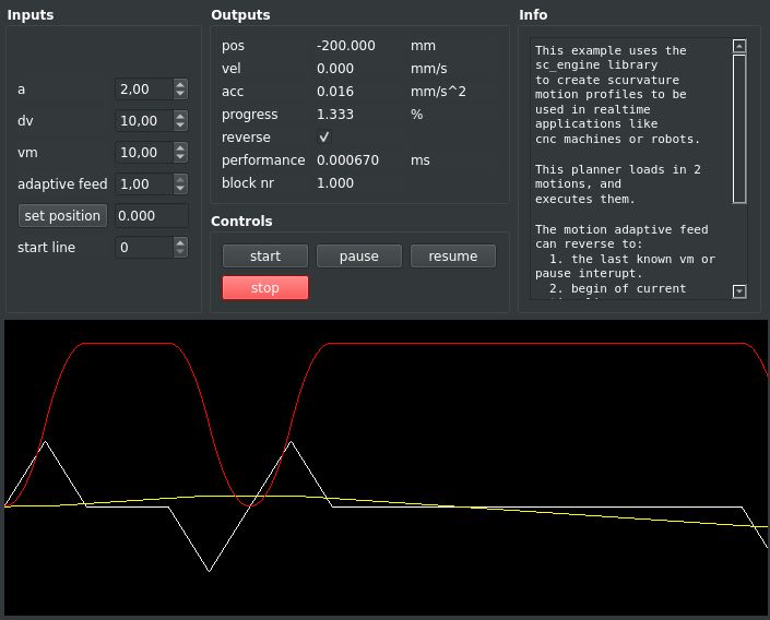

Just a little update. Last day's i coded the sc_planner into a state-machine.
A state machine is a code strategy that also opengl uses.
That is now finished, result seems ok.
This picture show 3 motions, the first motion has a end velocity transition to next motion.
In the second red curve, a "vm" interupt from 10 to 9 is done.
If you perform a pause in a end velocity motion, the motion will stop. Then the planner calculates
how to restart. This are tricky things.
I will try to focus on a look ahead function now. This function should be valuable for getting the perfect
end velocity's when passing sharp corners in a traject. I think this will be a head scratcher somehow.
image_link
vo=0, ve=5;
planner->sc_add_line_motion(vo,ve,acs,ace,{0,0,0},{100,0,0});
vo=ve; ve=0;
planner->sc_add_line_motion(vo,ve,acs,ace,{100,0,0},{200,0,0});
vo=ve; ve=0;
planner->sc_add_line_motion(vo,ve,acs,ace,{200,0,0},{250,250,250});image_link

The pid has a control loop. Maybe it doesn't look that there is one at first sight.
The sc_pid library has no internal timer or thread. It only has a update handle that has to be connected to a external thread.
In the sc_pid_gui there is a 1ms timer, this timer updates the pid :
pid->sc_update();
It runs every 1 ms to process next curvature step. It's coded to try to follow the main planner output.
The name could be misleading for you, sorry for that.
I could name it like : position_follower instead of pid.
However, the position_follower as stand alone app works nice.
When updating the tarpos every 1ms, the output is not acceptable.
An sich this is no problem for now. We could fall back to the lcnc's stepgen.so or pid.so for this task.
I already have a idea to solve above problem, but has no first priority right now.
About the git, when there is no contribution made by others, until that time
i can fast upload the project by dragging it into the files upload section of
the explorer. By terminal upload a lot of copy and paste has to be done to do a commit.
That's the reason.
I fear it won't go very far in direction of a solution.
It's certainly explorative coding. I keep optimistic about this project.
The solution don't have to be there the next day. I think it's important to keep progress.
Soon i hope to explore mr. Garrets comments.
in theory, all transitions need a full stop
Personally i don't like the G64P0.001 theory. I am more fan of always use max accuracy at all times if possible.
In my view it's not that lcnc solution is the only solution.
Mach3 does a quite good job in keeping accuracy over waypoints.
Mach3 goes out of path when velocity is set to high.
I never done a reverse engeneering on mach3 with nsa ghidra, there is one mach3 file wich can be interesting.
did a reverse on Drafsight a few times. This was
really helpfull.
that would need instantanous change of speeds in the transition point, which isn't possible.
For designing a solution to get a nice transition, every solution has it's up's and down's.
To get the planner finished in coming day's i started with in my view the most simple solution.
It could alway's be replaced by a improved one.
When you take a look at the sc_look_ahead, there are some solutions in progress.
In short :
1. Iterate over the gcode, calculate speeds for corners between : line-line, arc-line, line_arc, arc-arc.
2. When iterating over a arc, calculate the gforce. Set maxvel for arc.
3. Iterate over the gcode, ve=0 at G0, for G1,G2,G3, calculate speed transitions.
4. Iterate backwards over the gcode to verify speed transitions backwards.
This will hopely cover most of the path problems. If there remain problems it's quite easy to append
extra path rules. If above solution is not working at all, it could be replaced by something better.
