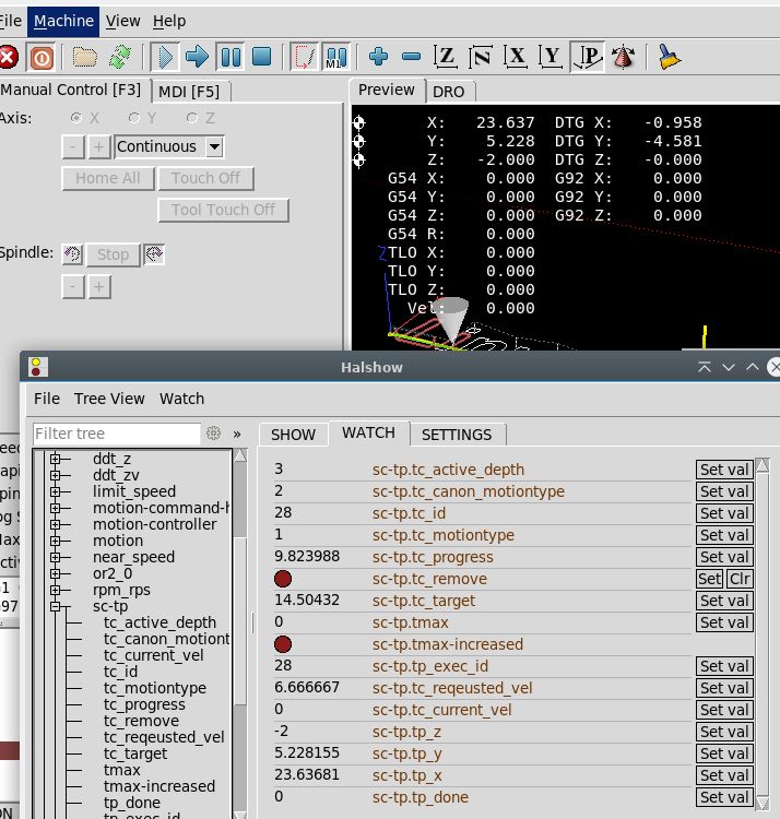

For the one's who are interested, parts of the scurve lib is already brought to c component style.
It already run's in a component. Exciting, the first part is almost finished.
I had to dive into writing c again.
scurve_c
scurve_c

The question is no longer a question.
I added a parameter of type bit for testing.
When this param is set to "true"
it pops a gcode line of the queue.
So for now i will try to keep the queue code intact.
There is still a lot to figur out.
This is good news.
in tcq.c there is a funny text :
Ok then.
This is good news.

29 Mar 2023 07:26 #267800
by Grotius
Replied by Grotius on topic LinuxCNC S-Curve Accelerations
Yes Rod, it's handyer to create hal pins or params to debug.
Yesterday and today i finished the scurve component conversion from c++ to c.
I have a question related to the c code of the component.
In one function (a big function) i am a little confused about using free memory and clear a vector.
line 1421 if i free the memory and do a vector cleanup. The component will do nothing the second curve request.
The timer of the component will stay to run.
At the moment it's outcommented, the component will run repeatedly without any problems, but
i did not take care of free memory. Is this a problem?
A video the component running in axis, with halsope :
link to github video
The video looks oke to me. Its 2 channels, so the acc curve it only shown as value in the left.
For the rest of the day, i now will go on with the tc.c file, adding more debug params.
And will try to look at the velocity profile that is used.

29 Mar 2023 14:56 #267851
by Grotius
@rmu,
Thanks.
The component was running for 1.5 hours without any problem.
I started again working at the tp.c file.
At now finally is was able to control the tp. "Hacked +1".
But far from where i want to go with the code.
The way i made control is every cycle just add 0.002mm to the progress.
The progress (is actual line or arc lenght seen from start to current tp).
The progress value can also be a negative. So i have added little function for that to solve.
If we are close to the target, just go to the next gcode line.
This avoid's the so called "split cycle". Wich i previously called a "stitch".
The split cycle ensures exact endpoint reach in the next cycle.
The split cycle time can be a time like : 0.00035 sec to reach endpoint. Normally
the increment time is 0.001 sec, this can cause a displacement overshoot.
The control code:
As a result lcnc gives a velocity output of : 0
This is perfect. It just moves the tp trough the program at a fixed increment value for each cycle.
The tc->remove is reset after call by excisting code.
Video how the program behaves:
video link
For every video i have directory in source code including the c source.
link to source code
In theory i could just put a scurve inside now. Who would preferr this? Just a raw test now?
Vote please !!
Thanks.
