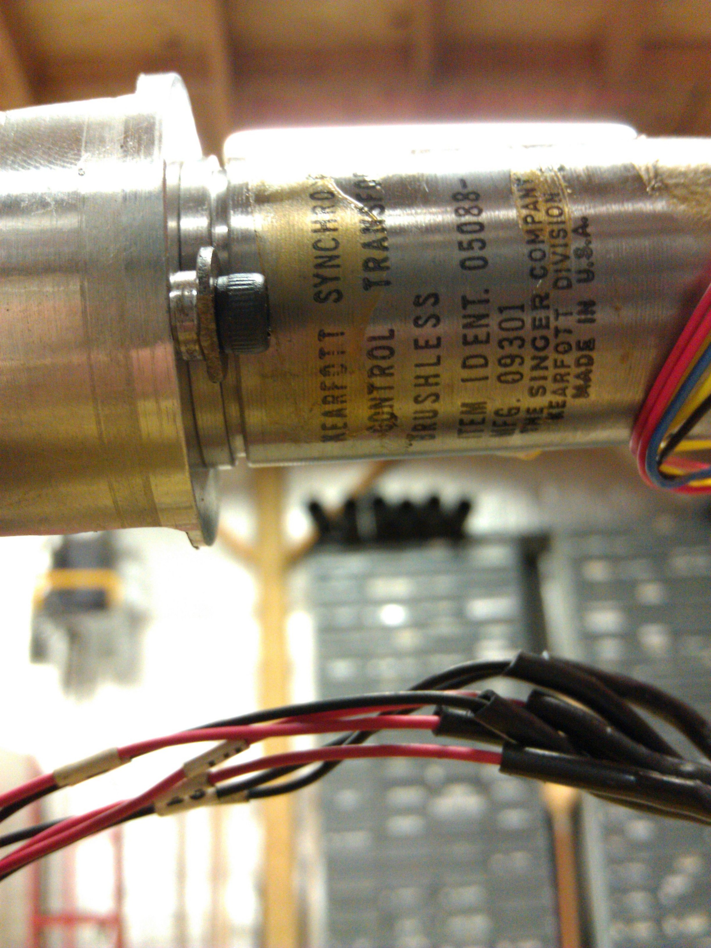

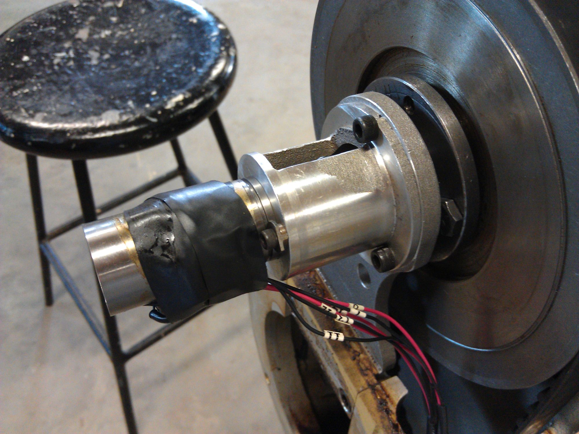

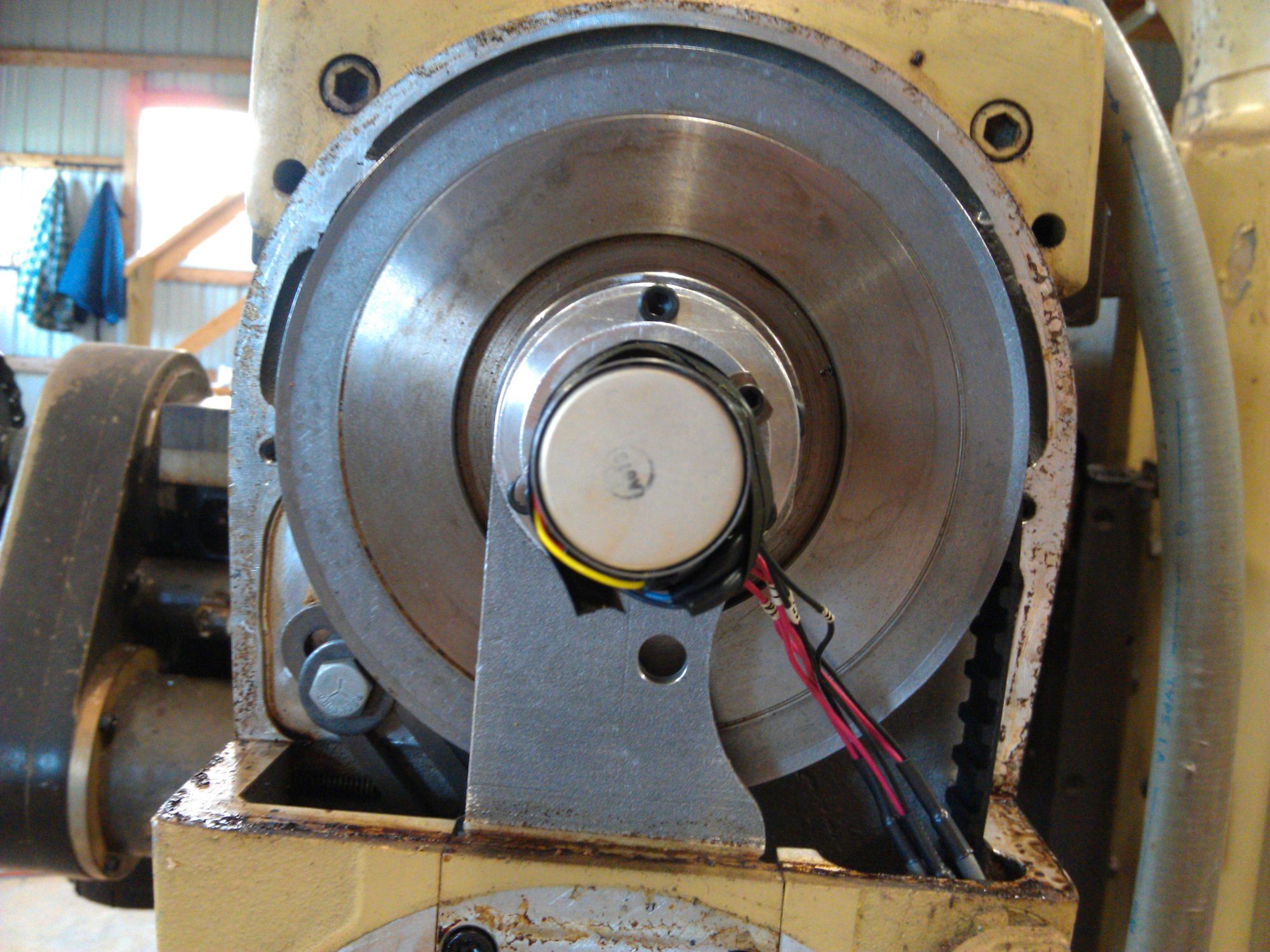

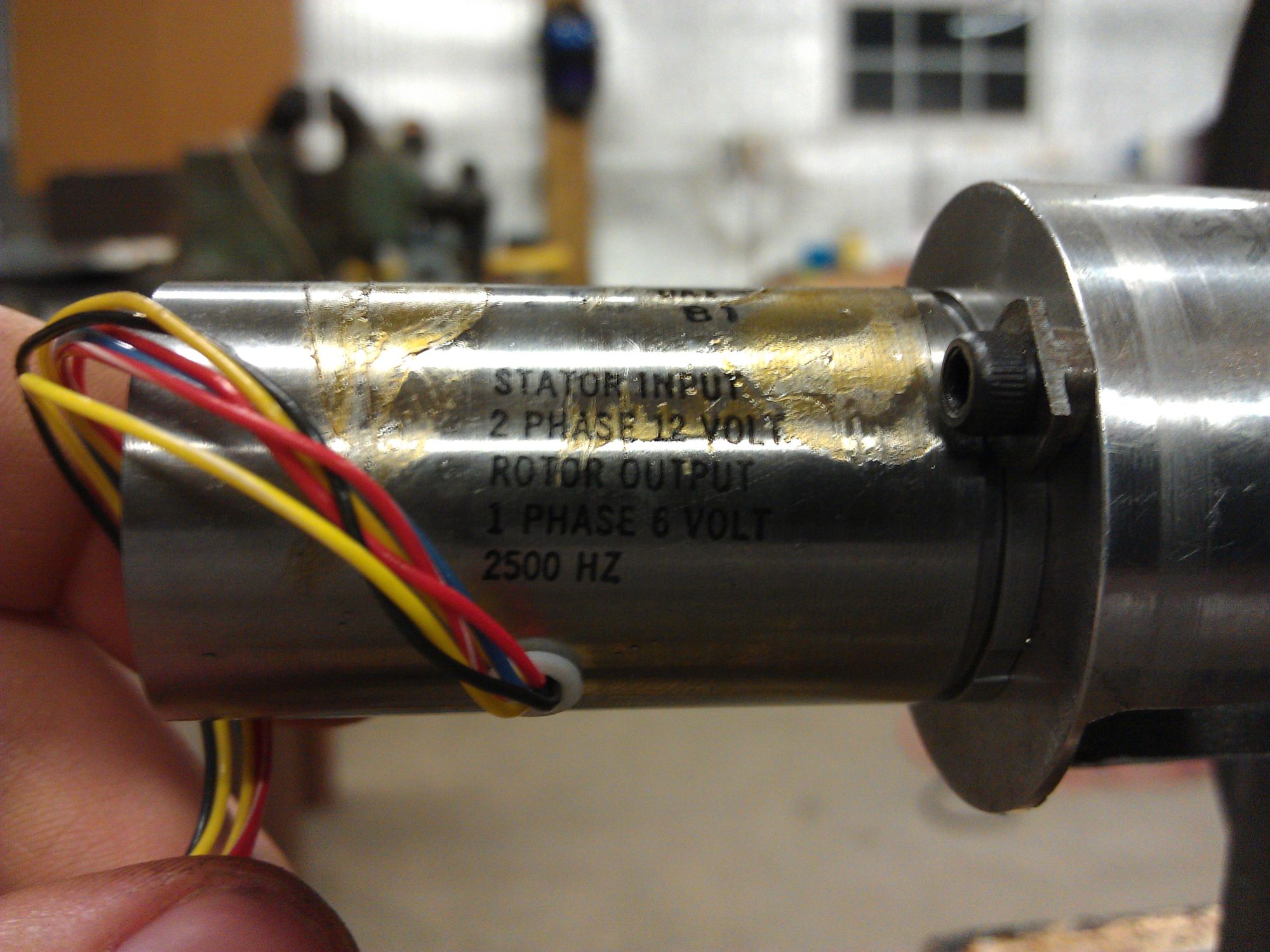

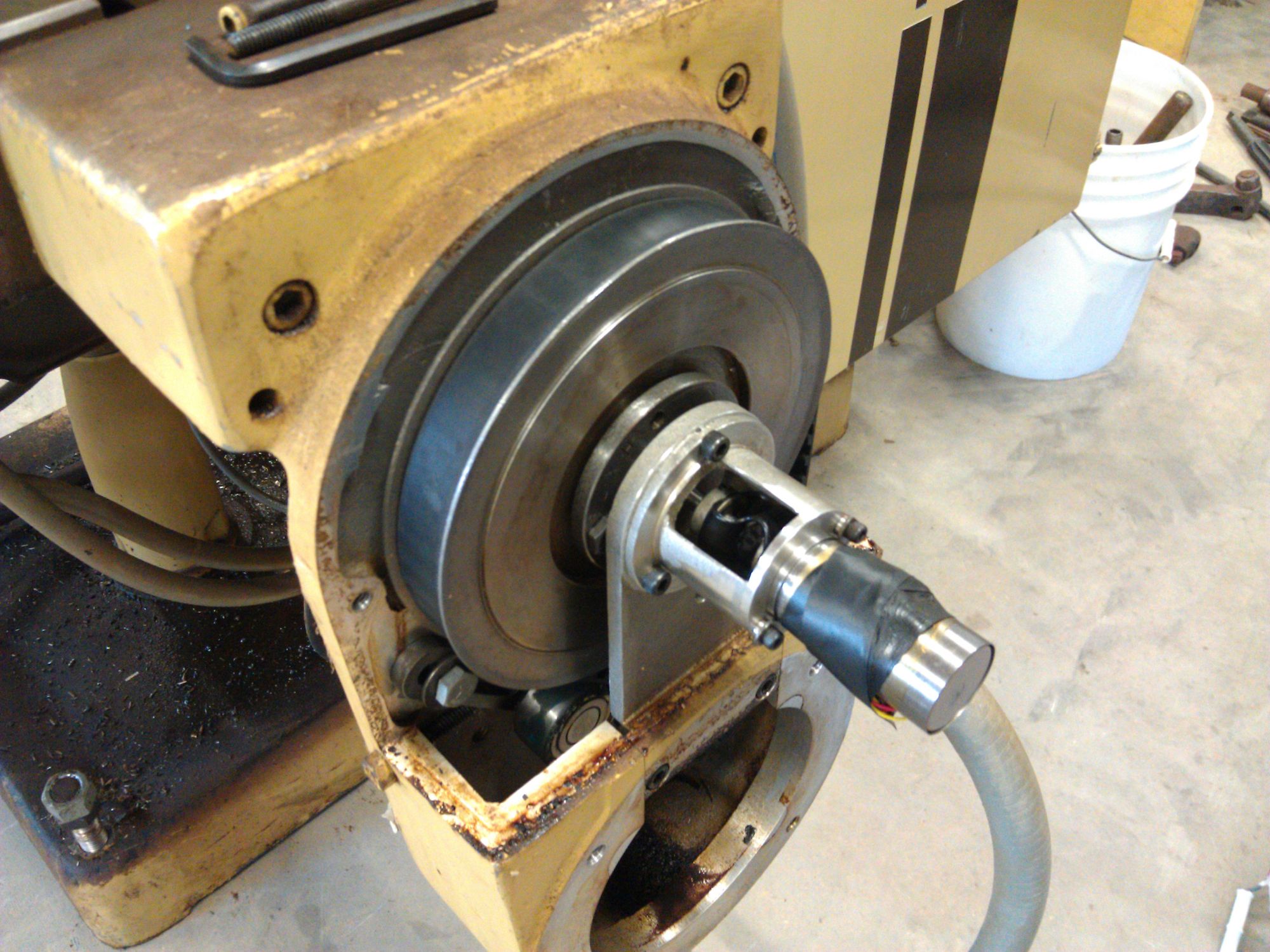

OK Guys I have made a choice. I think I'm going to get a MESA board to allow me to use ENCODERS and get rid of my resolvers altogether. I don't know why I didn't really think of this sooner but Encoders are only like 20 dollars on Amazon??? This will let me seamlessly integrate my X,Y,Z all together on 1 board. Additionally I'm thinking of adding a servo motor for my spindle in the near future and getting rid of the nasty 3-phase on top. Then I could truly do rigid tapping and all kinds of cool stuff with the servo motor driving the spindle.
So can you guys tell me if I'm on the right track here I'd appreciate it. I already have a 7i43-U-4 MESA card and I think I would just need a 7i48 card for my encoders I want to buy. Is that right? I can keep my 7i42TA card for limits and other stuff.
The encoders I want to get would be like this... and I'll even get new couplers:
www.amazon.com/gp/product/B00UTIFCVA/ref...A2CH56PPVFOUBF&psc=1
www.amazon.com/gp/product/B078VTPBQY/ref...A1THAZDOWP300U&psc=1
Now my servo motors are driving a toothed belt up to the x and y leadscrew meaning every 10 or so revolutions on the servo motor equals 1 revolution on the leadscrew and on the resolver (soon to be encoder). Will this be a problem during setup or should it be simple and straight forward?
Going this route I can add my new Z servo which already has encoder quadrature output so that should be child's play after this mess I've been dealing with.
Give me your feedback soon please I want to get my new MESA card ordered and get these encoders ASAP. If these encoders are not sufficient, please recommend something better for me to use.
Attached are pics of my old resolvers on the machine so you can see what I'll be replacing with the new encoders I want to get.

30 Jan 2019 12:31 #125277
Replied by andypugh on topic Add Z-Axis to my machine
Personally I am a fan of resolvers, so I would be adding a resolver to the Z motor rather than taking the resolvers off of your existing axes.
There are reasonably priced resolvers on eBay (And some very unreasonably priced ones too)
Your current system has a resolution of 12 bits, equivalent to 4096 counts per rev, so you would lose some accuracy with those 600 ppr encoders. 600 ppr and 5mm pitch screws and assuming 4 counts best-case positioning means 0.03 mm / 0.001" resolution.
