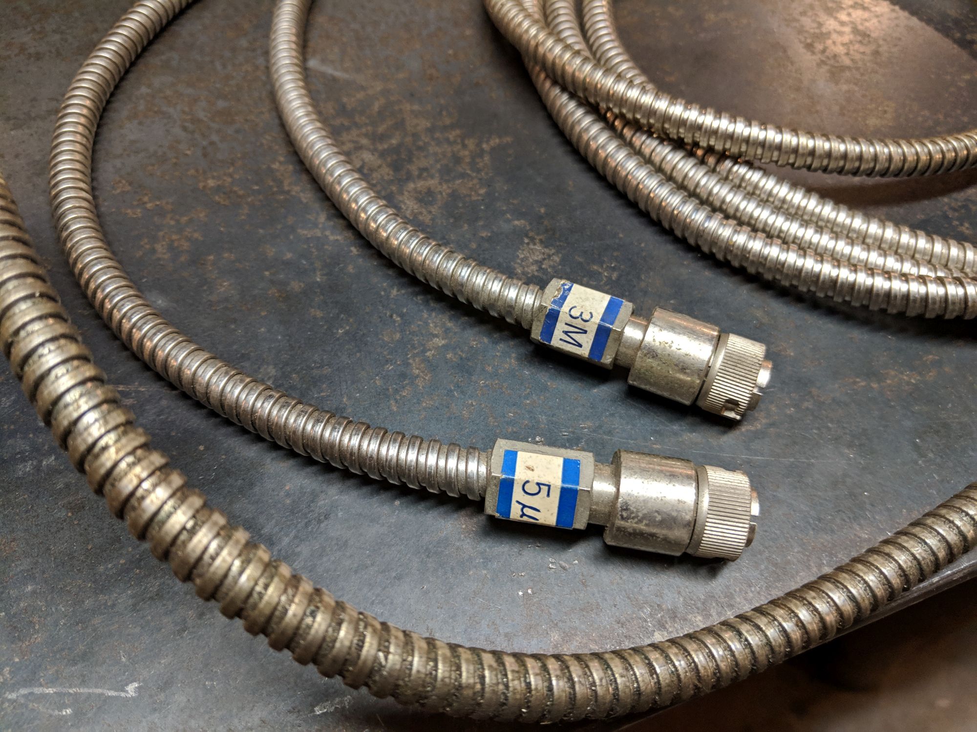

30 Jan 2019 20:03 #125328 by hatch789
Replied by hatch789 on topic Add Z-Axis to my machine
I only have the glass indicator, the slide piece and the armor wrapped cable with the plug end. I do not have any idea what kind of board or interface I need to plug this into so that it can read the signal. Any URL that you have to point me in the right direction for this would be appreciated. I'm in uncharted territory myself.
Now also I only have a 7i49 (resolver) board and a 7i42TA board. These both plug into my 7i43-4-U card. Is there something additional that I'd need to ready this indicator?

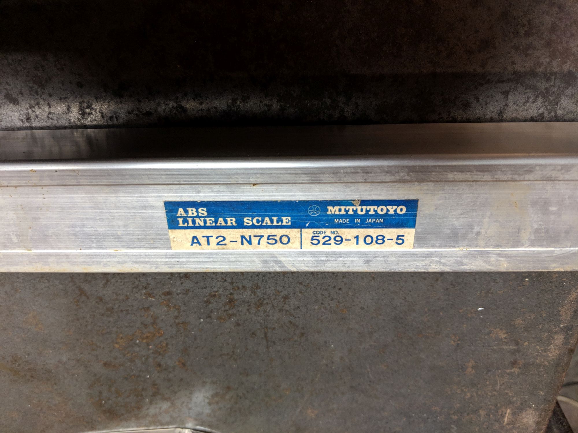

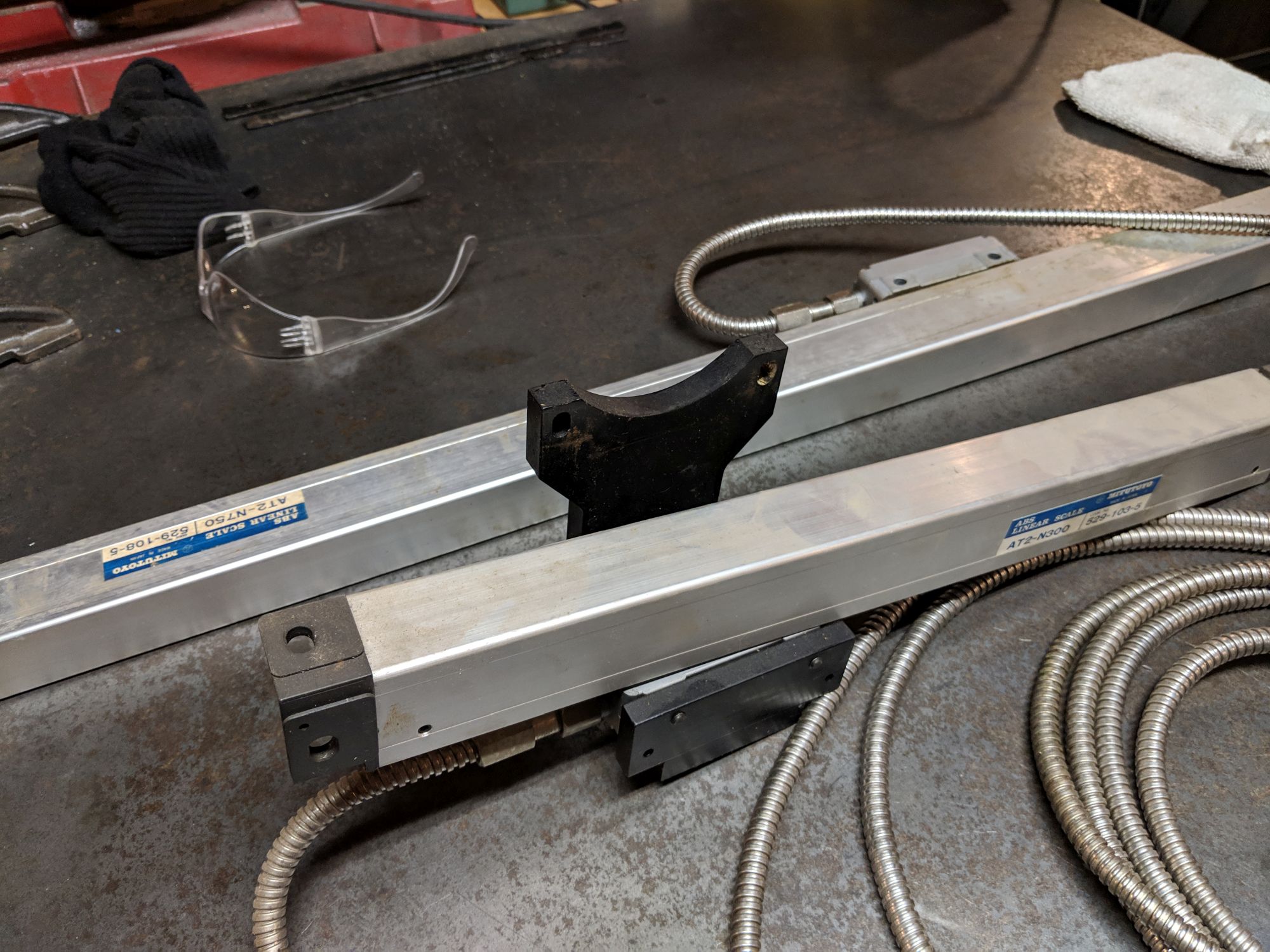

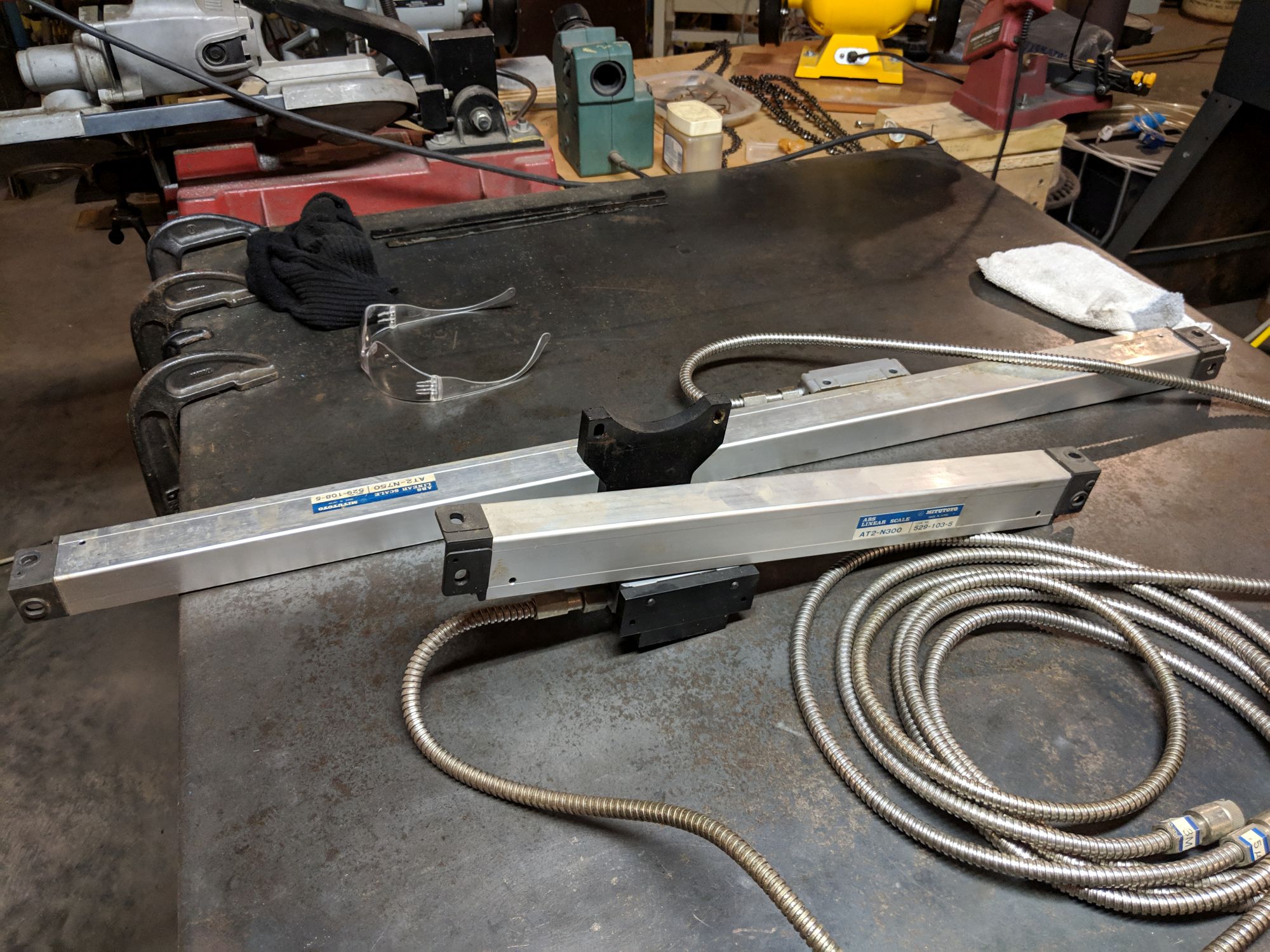

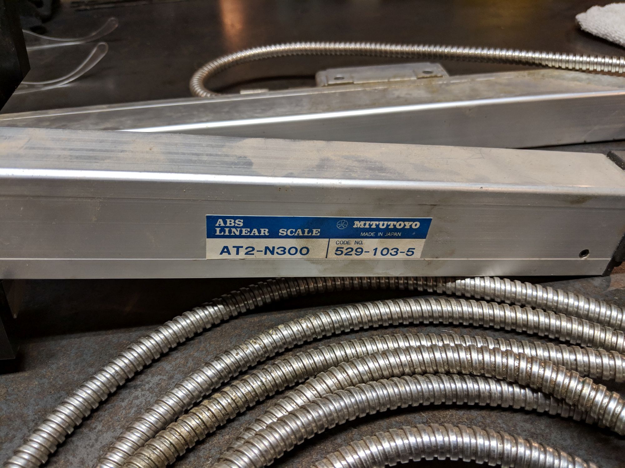

31 Jan 2019 00:41 #125359 by hatch789
OK here are my linear scales: ABS Linear Scale by Mitutoyo
AT2-N300
AT2-N750
31 Jan 2019 02:19 #125366 by OT-CNC
Replied by OT-CNC on topic Add Z-Axis to my machine
I think someone else will have to chime in on these. A quick google came up with the replacement being the AT-103 with 2 phase sign wave outputs with a wave difference of 90. Not sure if the AT2-N are the same.
