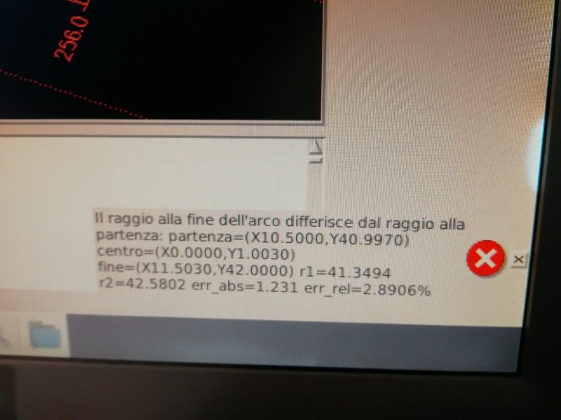

It's 2 days I'm getting this annoying message and no possibility to run any job; I'm getting little bit frustrated....

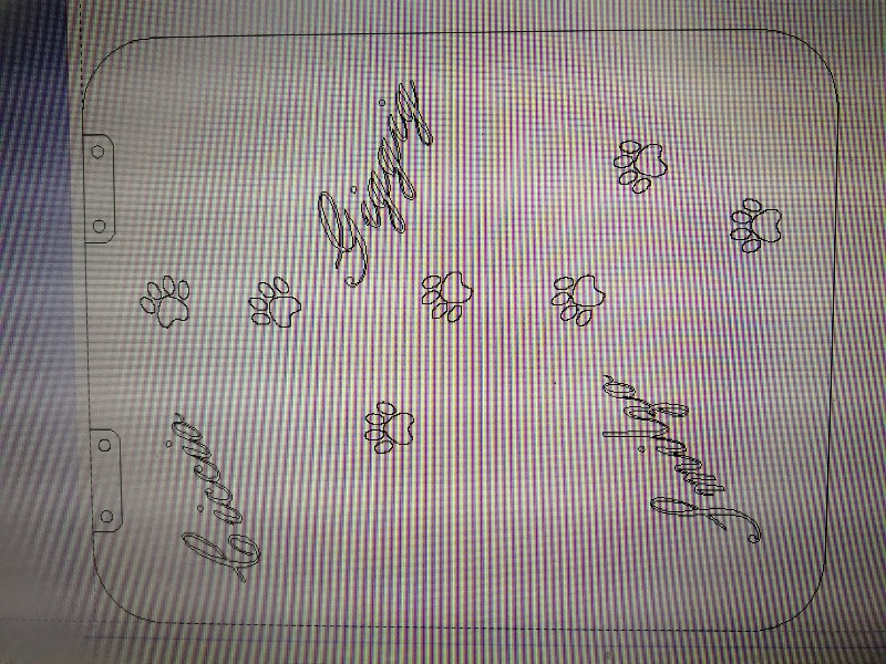

2 days ago, as my cats destroyed their catflap, I decided to use my cnc to meake a new one; it's a simple rectangle with rounded corner, a small draw and 2 hinge pockets (file attached).
I made 2 gcode files: 1 for the draw (engraved by 0.1mm30° bit), 1 for the catflap (milled by an end mill 2 mm).
The first file (the draw) was great: but when I ran the 2nd, I got the error message (attached - this one is not related to the .ngc file attached, as i made some tries, but getting the same message).
I made and re-made the draw and the path calculations (aspire) and the gcode several times, but nothing changed, same error message.

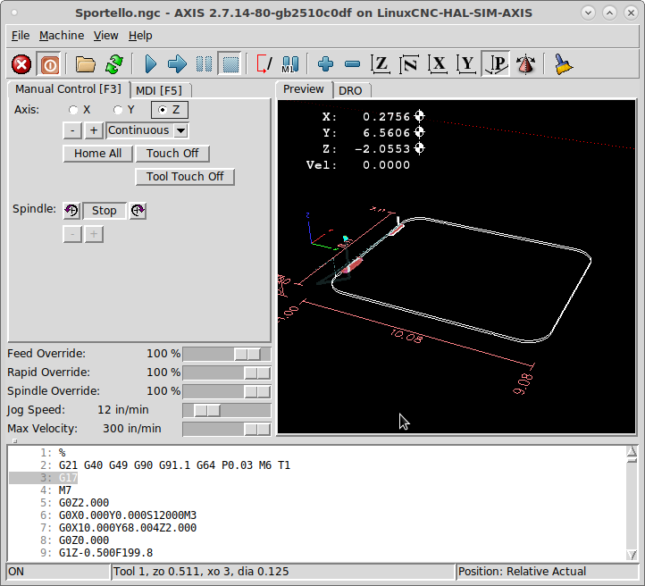

The last try has been to add a G90.1 command at the beginning, but once again no success.

You either need to decrease the arc tolerance in you cam program (so it outputs more precice code) or increase the "center arc radius tolerance" setting in Linuxcnc.
linuxcnc.org/docs/html/config/ini-config.html#_rs274ngc_section
Changing the inch setting from 0.00005 to 0.0001 should be close enough for Linuxcnc to open and run your example file.

I took a closer look at your G-code and I now see your problem. The problem is that the arc centers are specified in incremental mode not absolute coordinates. Your code will run fine if you change the beginning line of your file fromtoThen it should run fine.
G21 G40 G49 G90.1 G64 P0.03 M6 T1G21 G40 G49 G90 G91.1 G64 P0.03 M6 T1Please Log in or Create an account to join the conversation.
