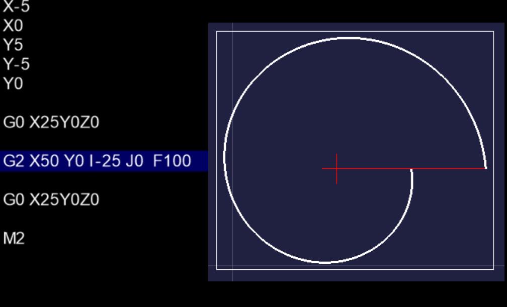

- gekonko
- Posts: 17
- Thank you received: 3
16 Jan 2025 03:14 #319102
by gekonko
Replied by gekonko on topic Error message "Radius to end of arc differs....etc etc"
@phillc54:
I really shouldnt post at midnight. You are right. Lines with R90 were added by me manually and should be commented out.
"The second N12760 should have a J value of -89.450, not -89.500"
- yes and no, really. From the CAM the precision is fixed to 0.1 so therefore it is "correct" in this case. I really just need to adjust tolerance in linuxcnc somehow, because no possibility to change presision in cam.
The source G-code is originally generated for esab NCE290. ";File converted successfully;" Means, it went trough parser which converts it to linuxcnc readable code without unknown command confilct (values are not checked).
If you are interested, there is complete program from CAM.
just to show you, how the code looks before
after converting to Linuxcnc readable code

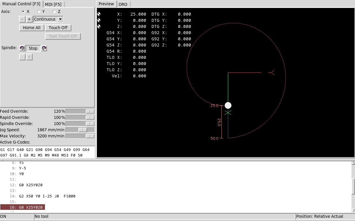

- hmnijp
- Posts: 42
- Thank you received: 49
17 Jan 2025 01:56 #319160
by hmnijp
Replied by hmnijp on topic Error message "Radius to end of arc differs....etc etc"
What a coincidence!
Just yesterday I was experimenting with this parameter and noticed that the value cannot be increased.
It's really only in the range of
#define CENTER_ARC_RADIUS_TOLERANCE_MM (2 * 0.01 * M_SQRT2)
#define MIN_CENTER_ARC_RADIUS_TOLERANCE_MM 0.001
rs274ngc_pre.cc
0.001 < tolerance < 0.0225
I wanted to disable the ARC_RADIUS_TOLERANCE constraint and see how interpolation works with a large difference between the start and end radius. This could be used to do spiral interpolation by extending the g-code to g2.1 / g3.1 - just copy interp_arc.cc, but there would be no radius difference check.
rs274ngc_pre.cc
- hmnijp
- Posts: 42
17 Jan 2025 03:04 #319167
by hmnijp
