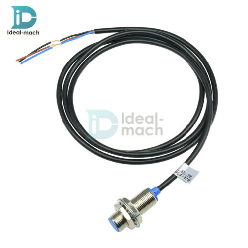

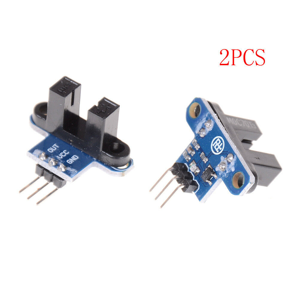

www.ebay.com/itm/2x-IR-Infrared-Slotted-...p2057872.m2749.l2649
www.ebay.com/itm/NJK-5002C-Hall-Effect-S...4e458e79e21c62b5dddc
I going to use NJK-5002C-Hall-Effect-Sensor-Proximity-Switch as index pulse and
IR-Infrared-Slotted-Optical-Speed-Test-Sensor as Phase A
is it GOOD or
using two IR-Infrared-Slotted-Optical-Speed-Test-Sensors as Phase A and index pulse,
please give me a better codes for this setup.
