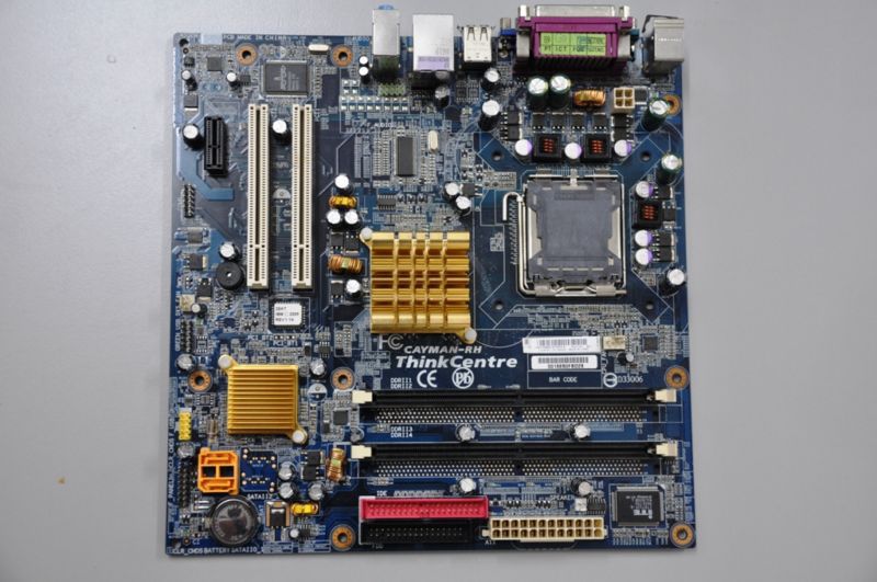

1)LENOVO ThinkCentre A52 CAYMAN-RH 945 motherboard not worked since a year

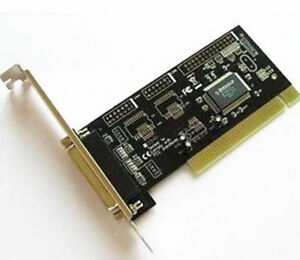

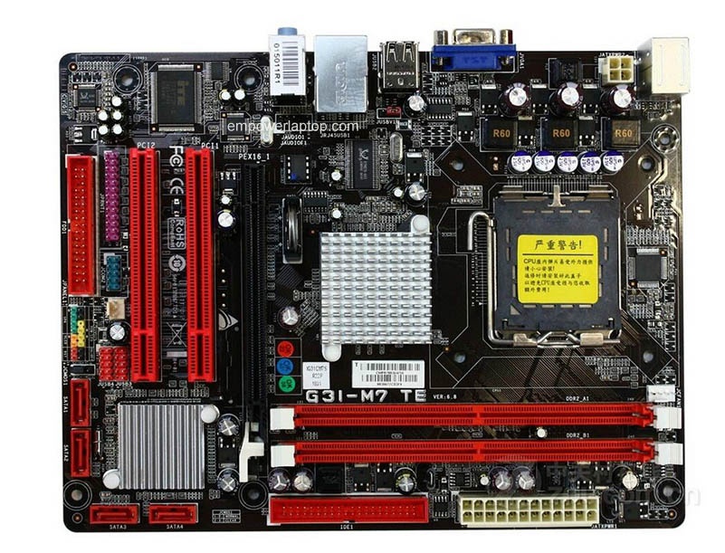

2)biostar g31-m7 te
parallel port card on ebay
www.ebay.co.uk/itm/IEEE-1284-DB25-25Pin-...f:g:HTAAAOSwO7haJzwa
2)biostar g31-m7 te

- Posts: 21815
- Thank you received: 7450
17 Jul 2019 15:24 - 17 Jul 2019 15:25 #139703
Replied by tommylight on topic can linux cnc can cut a thread using only breakout board without using mesa card
Already replied to the other thread, please do not make multiple threads with the same questions.
The Biostar has a header for parallel port so you need just the cable with the connector, it is the pink header on the mainboard. You do not need a parallel port card for that motherboard.

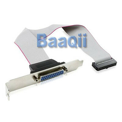

17 Jul 2019 15:54 #139706
by Dinuka_Shehan

- Posts: 21815
17 Jul 2019 16:29 #139709
No worries, it just makes it difficult for someone else to find that information later.
Yes that is the connector you need fro the Biostar board.
