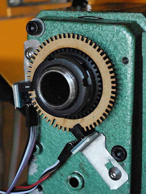

15 Jul 2019 17:34 - 15 Jul 2019 17:40 #139472
by Dinuka_Shehan
Replied by Dinuka_Shehan on topic can linux cnc can cut a thread using only breakout board without using mesa card
Thank you for help and your valuable information.
I am going to make a slotted disc for myself and it will be cut on a 2mm thickness piece of acrylic or 5mm thick ebonite disc.
I planned to fix it on my spindle thread which used to tighten the taper roller bearings of spindle.
It is 33.5mm of major thread diameter.slotted disc will placed between two locknuts.
Slotted disc will have 60 slots and only one tooth cut too deeper for index pulse.
slot size wiil be 3mm wide and depth of 4mm and only one tooth depth for 6mm to index.
PCD(pitch circle diameter) of (3x3)60/3.1416=114.59mm.
diameter of disc will be 114.59+3=117.59mm.
I am using two optocoupler speed sensors to detect the index pulse and phase A.
its slot wide 6mm and height of 7mm.
is this well enough for my setup?

16 Jul 2019 12:19 #139557
Yes, that will work well. I ran with exactly such a system for years.
You could consider adding a phase B, it will give you the ability to rigid tap.
Or use a two-sensor detector for A and B.
Replied by andypugh on topic can linux cnc can cut a thread using only breakout board without using mesa card
The following user(s) said Thank You: Dinuka_Shehan
but I cannot use Phase B on my bob.
It just 20khz.
so I searching for a new bob for cheap price for my purpose.
It just 20khz.

20kHz is an (approximate) parallel port limitation rather than a limitation of the BoB.
What is your base period set to in the HAL / INI files?
60 slots / 4x quadrature / 20kHz is 5000 rpm....
It just 20khz.
