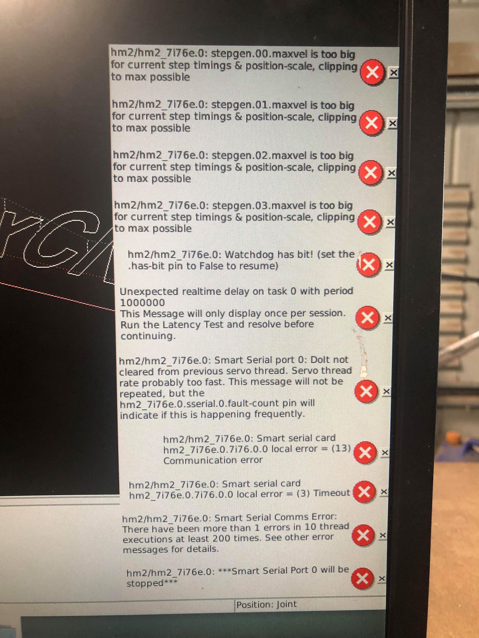

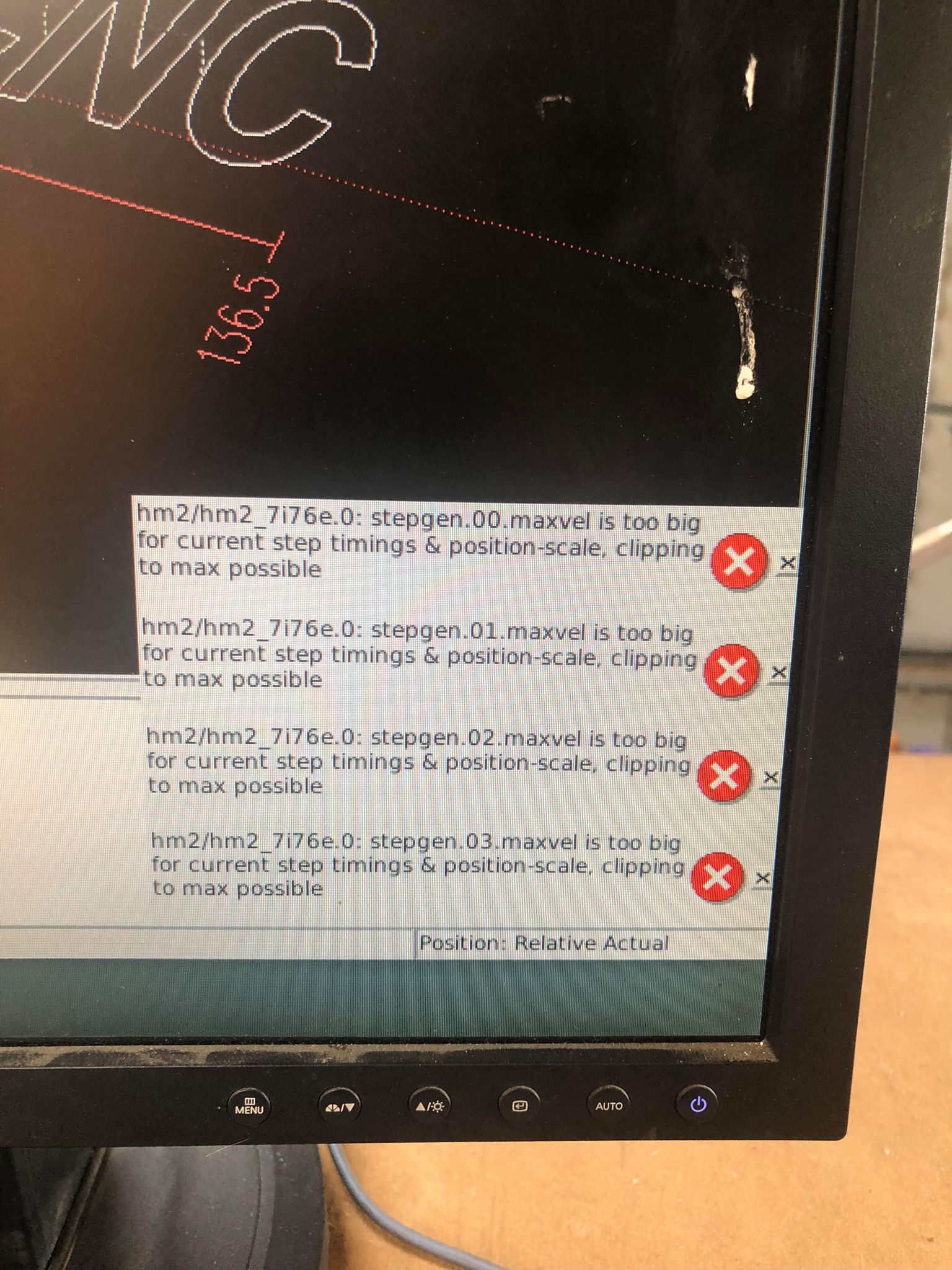

30 Nov 2019 01:58 - 30 Nov 2019 02:16 #151553
by little_sparky
Ahhh yes! Didnt realise you used the value with the step scale aready calculated.
So I changed a few things in the .ini file (this is so much better than PNCconf), however I have experienced a couple of errors.
The first image is the initial error I encountered so I dropped the velocity values from 250 to 200 and then the second image is from further changing to 150 in each of the joints.
.ini and .hal
also on a side note, what are people who are running plasma using as their z-axis limits? I cant seem to get the file to run if I use 200 or -200 as is says line 11 exceeds the Z-axis limit, but if i put in +100 and -100 from limit in the PCNconf i can get it to run.
Edit: changed the P from 6000 to 1000 after uploading files
Replied by little_sparky on topic Step Sale and Velocity
Because you said you were doing 2 x microstepping now so 2 x 5 = 10
.ini and .hal
Last edit: 30 Nov 2019 02:16 by little_sparky.
- Posts: 18085
- Thank you received: 5320
30 Nov 2019 02:33 #151554
Replied by PCW on topic Step Sale and Velocity
Setting all steplen and stepspace values back to 5000 should fix the clipping warnings
( I suggested setting the direction setup and hold settings to 20000 not the step length and
step space settings )
The other errors are related to real time performance ( the watchdog bit which means the card was not accessed for 5 ms )
This probably means you need to do some latency testing and make sure that the BIOS setup has all power saving options disabled
