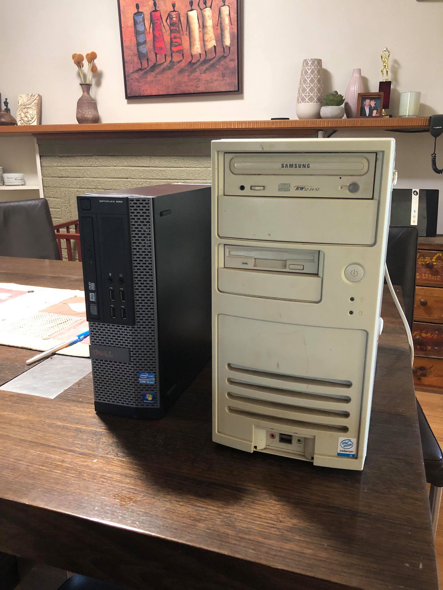

13 Dec 2019 02:44 #152578
by little_sparky
I am using a desktop computer. Refurbished Dell Optiplex 990
Computer to my right is the old 32 bit i had trouble with and left is the optiplex.

- Posts: 18085
- Thank you received: 5320
13 Dec 2019 03:01 #152580
Replied by PCW on topic Step Sale and Velocity
If it takes 5 ms to send a packet something is really broken with networking on that box
You might look at your BIOS to see if there are any network hardware settings
also determining the Ethernet hardware might help:
dmesg | grep -i eth
should list the Ethernet hardware

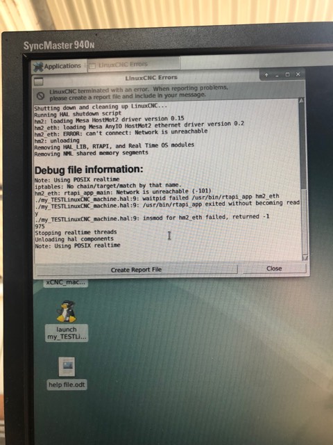

- little_sparky
- Posts: 138
- Thank you received: 17
16 Dec 2019 02:43 #152705
by little_sparky
returned
Replied by little_sparky on topic Step Sale and Velocity
dmesg | grep -i ethjonty@jonty:~$ dmesg | grep -i eth
[ 0.271436] reboot: Dell OptiPlex 990 series board detected. Selecting PCI-method for reboots.
[ 0.941829] e1000e 0000:00:19.0 eth0: (PCI Express:2.5GT/s:Width x1) 18:03:73:36:2f:1b
[ 0.941831] e1000e 0000:00:19.0 eth0: Intel(R) PRO/1000 Network Connection
[ 0.941876] e1000e 0000:00:19.0 eth0: MAC: 10, PHY: 11, PBA No: E041FF-0FF
[ 3.094057] IPv6: ADDRCONF(NETDEV_UP): eth0: link is not ready
[ 4.599626] e1000e: eth0 NIC Link is Up 100 Mbps Full Duplex, Flow Control: Rx/Tx
[ 4.599629] e1000e 0000:00:19.0 eth0: 10/100 speed: disabling TSO
[ 4.599665] IPv6: ADDRCONF(NETDEV_CHANGE): eth0: link becomes readyPlease Log in or Create an account to join the conversation.

- Posts: 18085
16 Dec 2019 02:55 - 16 Dec 2019 02:59 #152708
Are you losing Ethernet connectivity? (link lights go out, eth0: link is not ready messages in dmesg )
the first link not ready here is probably ok but you should not see this again unless you power down
or disconnect the 7I76E.
This could be a result of losing power to the 7I76E, a bad cable, a bad Ethernet
port on your PC etc etc
Also since you have a Intel MAC you should disable IRQ coalescing:
sudo ethtool -C eth0 rx-usecs 0
(man hm2_eth)
Also the command
ip a
Will give you MAC status and current setup which can help debug connectivity issues

- little_sparky
- Posts: 138
16 Dec 2019 03:07 #152709
by little_sparky
So what should my /etc/network/interfaces file look like?
