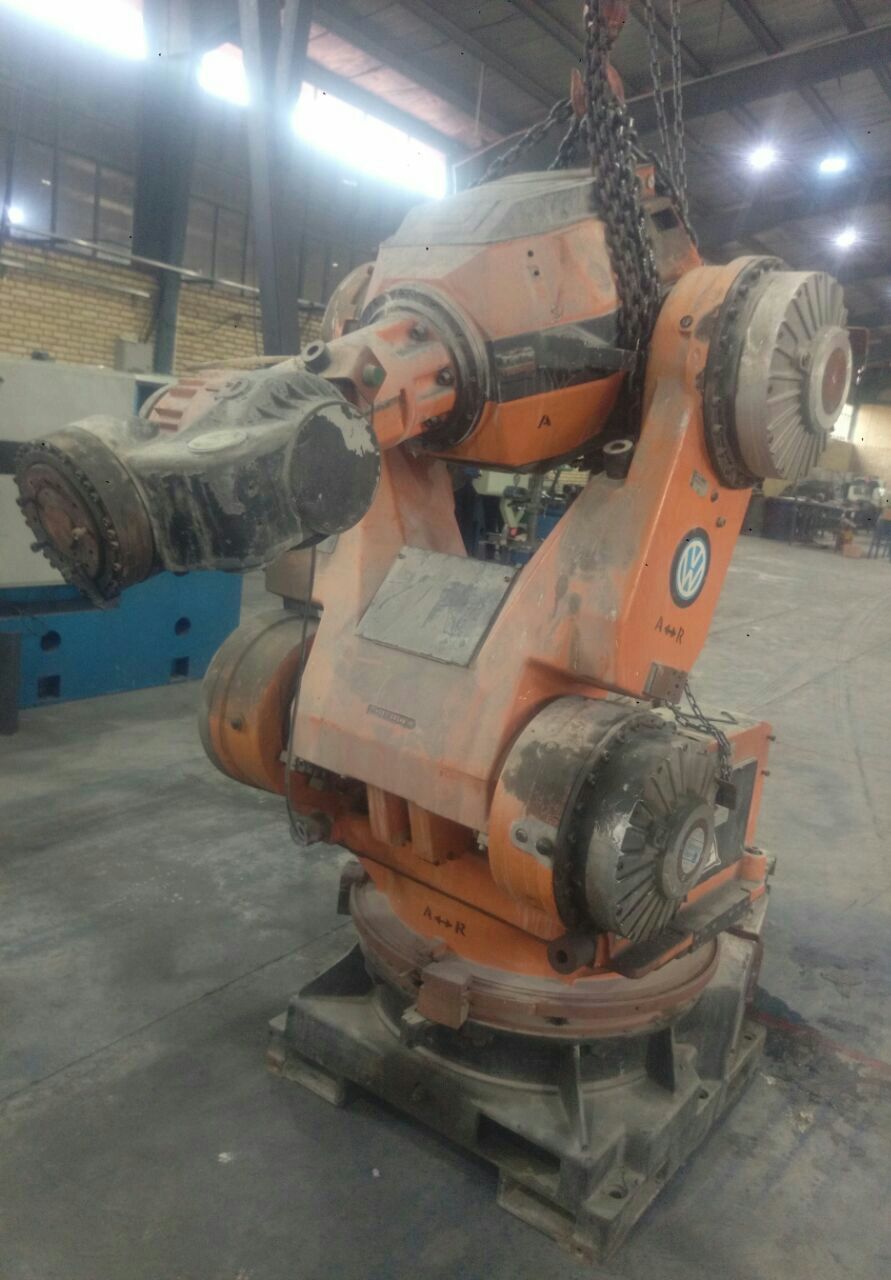

22 May 2024 23:09 #301168 by Ehsan_R
Hello
I have an old 6 axis robot and I plan to start it with linuxcnc.
I had already seen videos of robot control using linuxcnc on the internet and was hoping that I could do it myself.
After reading this thread and doing some tests and verifying the performance of genserkins, I was a bit skeptical.
Please guide me whether to continue with this or try another method?
I plan to use this robot for welding
23 May 2024 00:23 - 23 May 2024 00:24 #301173 by tommylight
DAMN that looks like something from "Star Wars" movie ! :) :) :)
Probably very old Kuka robot, so
Do you have the control box for it?
Does it have 320 written on the box or hand controller?
What motors does it use?
Does it have encoders or resolvers on the back of the motors?
When did it have the gearbox oil changed?
Does it have a spring or hydraulic counterbalance?
Edit:
Start a new topic for it, if you already did not.
Thank you.
Last edit: 23 May 2024 00:24 by tommylight. Reason: more info

23 May 2024 13:27 #301203 by Aciera
My interest was more pick and place and I have little experience with welding so I really do not know what can be achieved. However, I'd say, apart from relatively simple 3d paths, you would have a rather hard time to create gcode that would give you constant torch orientation along a more complex 3d path that also gives you constant speed.
My first question would be, how do you intend to create the gcode? A straight line or an arc in 3d space should be relatively easy but following a pipe joint would likely require a CAM of some sort. Also with a robot you really need to simulate the code to check for problems with singularities.
What I would recommend is this:
- take one of the available robot simulation configs and see if you can actually get what you want with that. If you cannot get it to follow the paths you need then there is really no point in going further
- If you think the software can get you where you want to go then you would need to figure out how to get the motors of the robot to run.
