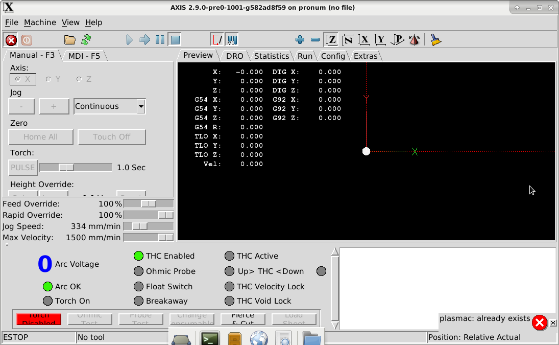

Could you run your config from a terminal and post the messages.

When I run LinuxCNC does not show the window "LinuxCNC errors" but it shows an error bottom-right in the photo above.
I use the configurator of plasmac user guide.
Somehow, I can't turn on the output of torch-on using the GUI button.
Thank you for you reply.

What Phill has asked you to do is to open a terminal window and type linuxcnc at the command line prompt and press enter.
Then share the error messages printed in that window.
This is the best way to check for errors.

I think the real issuue is an error in plasmac_config.hal. Can you post it?
Fromthe tail of your screen dump.
This may or may not be your doing
plasmac_config.hal:1: Unknown command 'outputs'
'halcmd -f plasmac_config.hal' exited with 1This may or may not be your doing

Can you zip the complete config directory and post it.
EDIT: Actually you may be missing the # in front of outputs in plasmac_config.hal.
It should look like:

My plasmac_config is a bit different.
Put the # before the outputs.

A number of config files in your RAR file have 0 bytes including plasmac_config.hal
