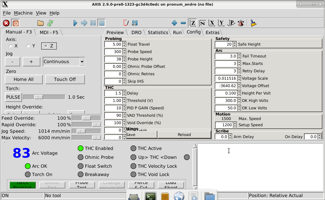

03 Apr 2020 08:16 - 03 Apr 2020 08:18 #162544
by sharp_reaper
Replied by sharp_reaper on topic Plasmac ERROR "Plasmac: already exists"
Was testing Torch ON is working fine.
Can't see the Arc Voltage correctly.
I've connected the pins:
THCAD +5v to TB3 Pin 6 (+5 VP)
THCAD -5v to TB3 Pin 1 (GND)
THCAD FOUT+ to TB3 Pin 7 (ENC A+)
THCAD FOUT- to TB3 Pin 8 (ENC A-)
When is not cutting it shows 83
When is cutting always drops the value to 77
I used the JSCalc.io to calc the scale and offset
My config:
My config:

03 Apr 2020 08:28 #162546
by phillc54
Replied by phillc54 on topic Plasmac ERROR "Plasmac: already exists"
Is your divider ratio exactly what you entered in the calculator?
The following user(s) said Thank You: sharp_reaper

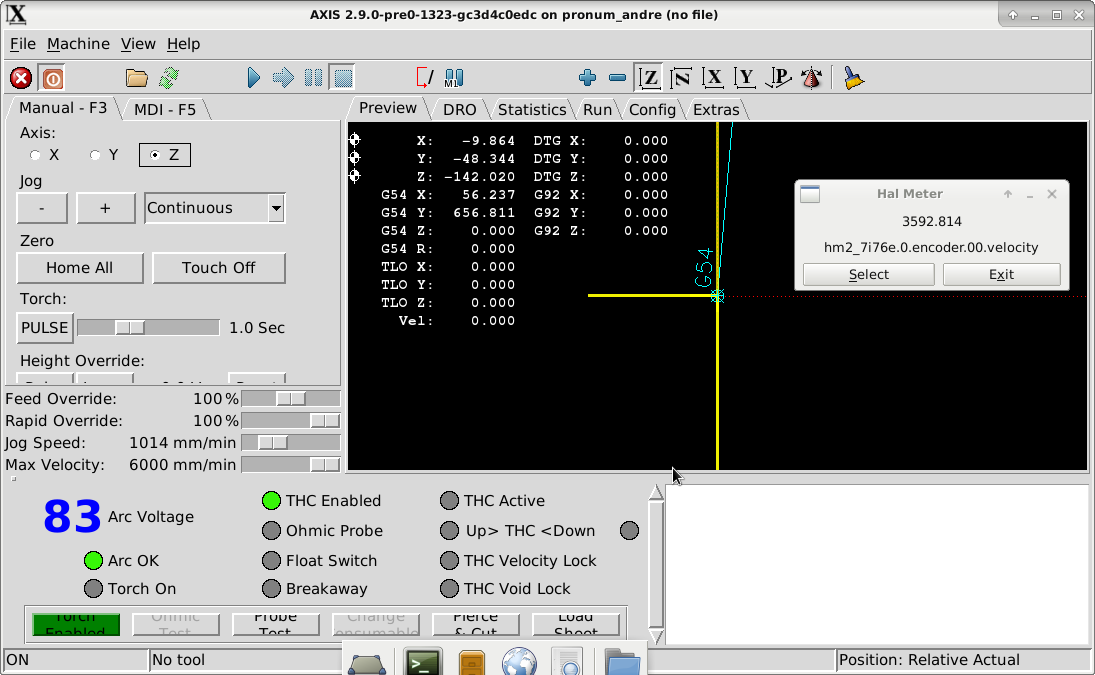

- Posts: 12156
- Thank you received: 4149
03 Apr 2020 08:34 - 03 Apr 2020 08:35 #162547
Replied by rodw on topic Plasmac ERROR "Plasmac: already exists"
1. Voltage offset should be positive
2. Your Voltage offset is 3640 which seems in the ballpark but I have not seen your calibration sticker 0 volts setting
3. When idle, the velocity is 3592 which is that close to your offset it does not matter. (0.55 volts by your voltage scale)
Have you set these settings in your hal file?
linuxcnc.org/docs/devel/html/plasma/plas...hcad_initial_testing
It might just be your system is counting backwards.
Last edit: 03 Apr 2020 08:35 by rodw.
- Posts: 12156
03 Apr 2020 08:46 #162548
I don't think he has. I realised the plasma primer needs a bit more info in this Section:
linuxcnc.org/docs/devel/html/plasma/plas..._with_the_mesa_thcad
Because LinuxCNC's hal environment does not support a divide function, Plasmac requires the reciprocal of the Herz per volts to be used in the Voltage Scale. eg in the example above:
1/2520 = 0.000396825396825
