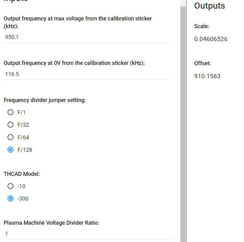

Looking at that seems to show that when you had 1/32 you should have had a positive offset rather than a negative.

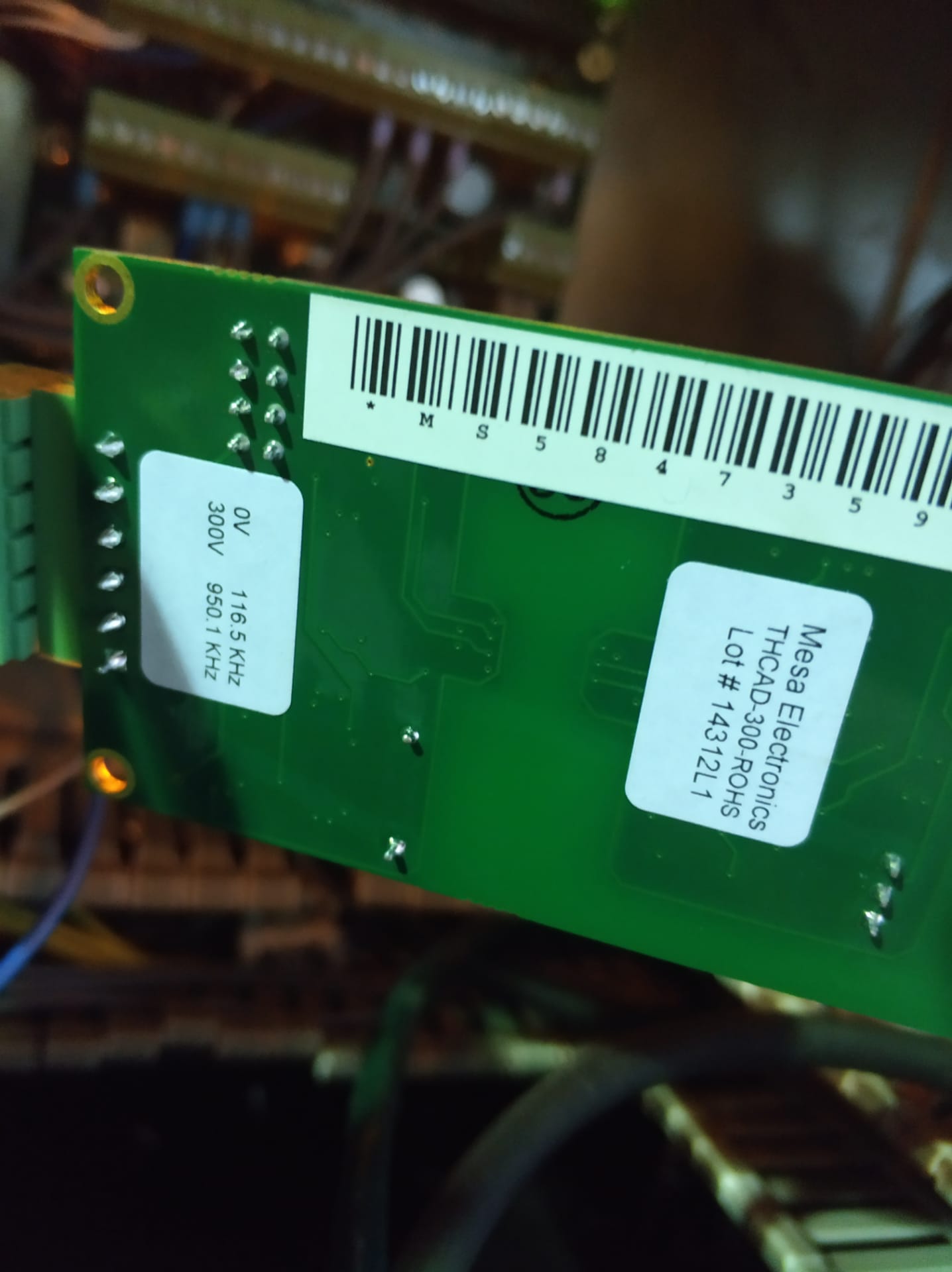

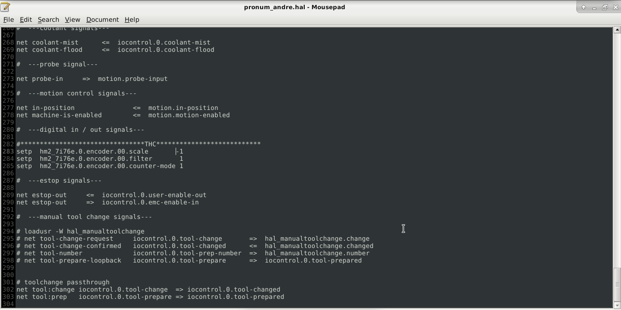

03 Apr 2020 11:11 #162564
by sharp_reaper
Replied by sharp_reaper on topic Plasmac ERROR "Plasmac: already exists"
Tried test the behavior of THC in a tilt angle, it starts ok but instead of following the plate, hit the floating switch.
Also weird is the voltage reading, i set 127 volt, but actual reading is around 110v. Any ideas?

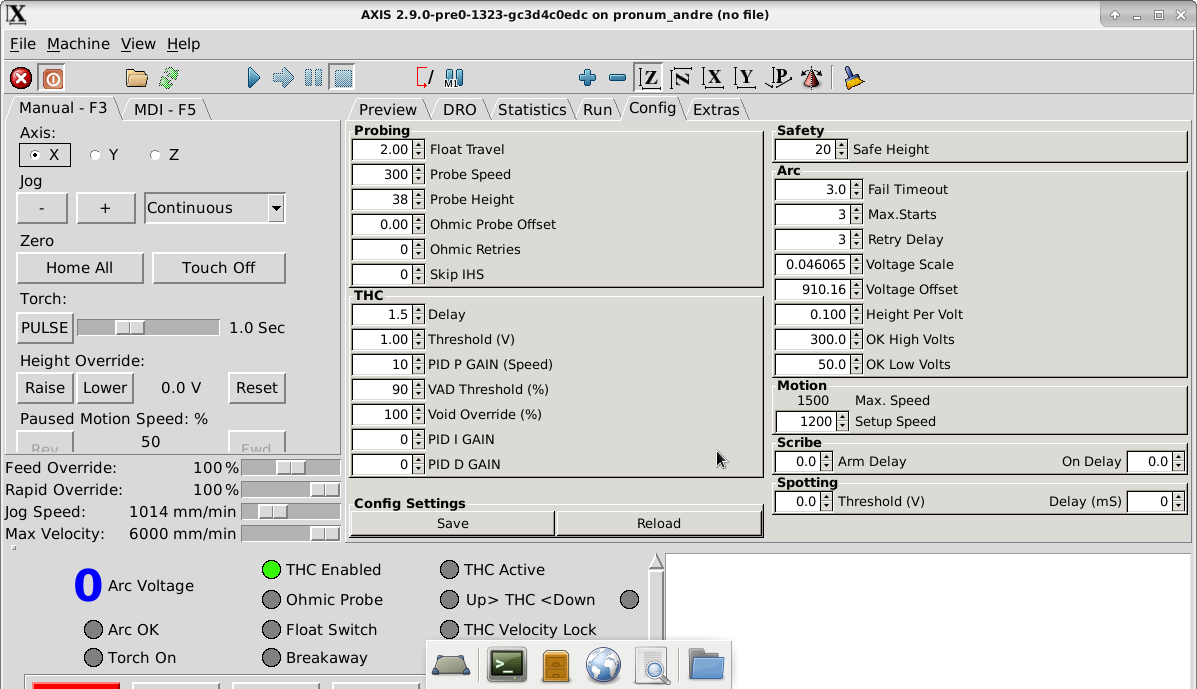

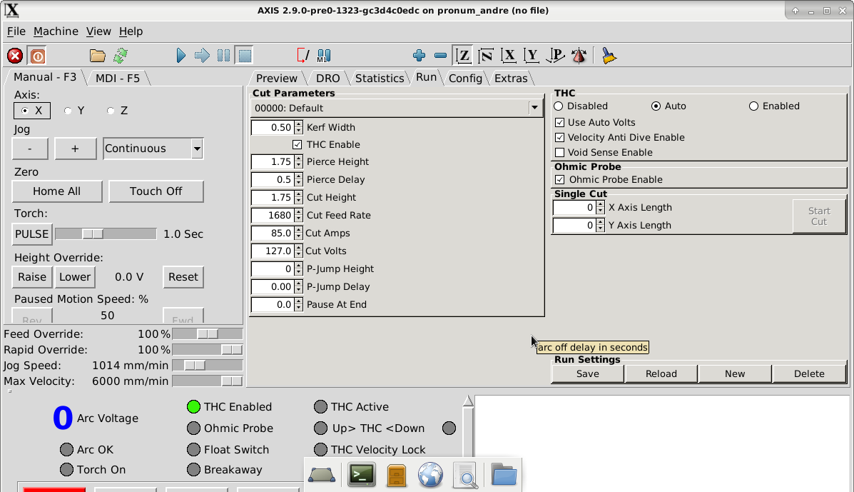

- phillc54
- Posts: 5711
- Thank you received: 2100
03 Apr 2020 11:15 #162565
by phillc54
Replied by phillc54 on topic Plasmac ERROR "Plasmac: already exists"
Could you post a screenshot of your Run Panel and your Config Panel

- phillc54
- Posts: 5711
03 Apr 2020 11:46 #162569
by phillc54
Your joint2/axisZ velocity is relatively slow so try increasing PID P Gain on the config panel.
The following user(s) said Thank You: sharp_reaper

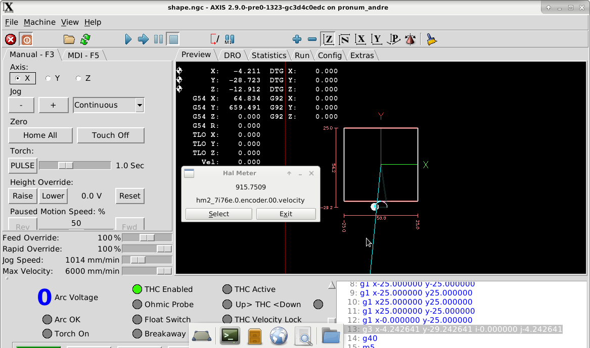

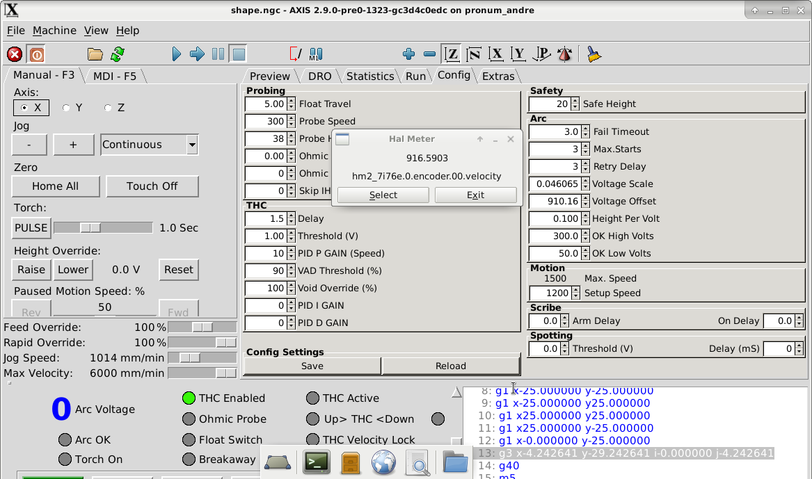

- sharp_reaper
- Posts: 73
- Thank you received: 7
03 Apr 2020 13:45 #162579
by sharp_reaper
I've speed up the Z vel and accel.
In 5 tries worked 3 times.
Tried to put the PID P Gain (speed) up to 50 and hit the float.
- phillc54
- Posts: 5711
03 Apr 2020 21:33 #162610
by phillc54
If it worked three times then maybe there is either loose wiring or a mechanical issue.
