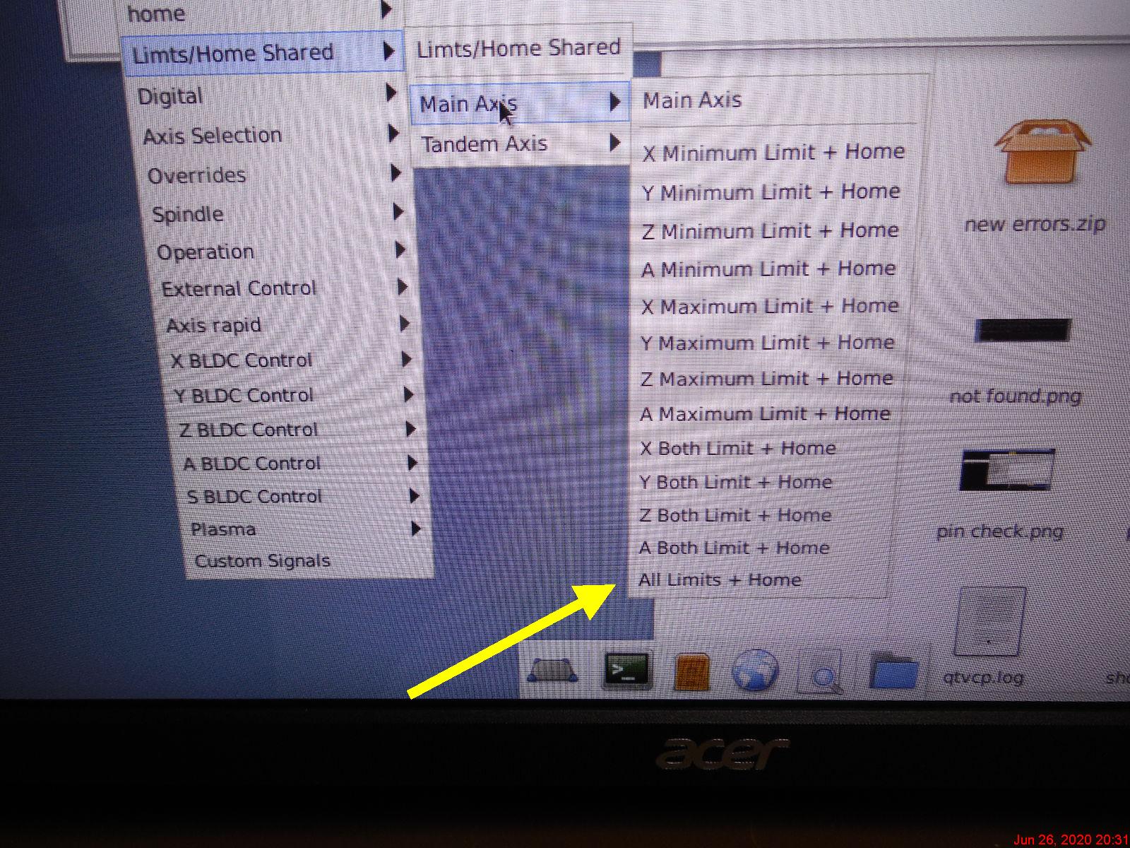

Unfortunately I am not really the right person to discuss home/limit switches with. I have never used limit switches with LinuxCNC and the plasma table is the first time I have used home switches. Some here will say that home and limit switches are required, but I have not found that to be the case, although I must admit my lazy self likes the home switches.
I also have no experience with Mach or UCCNC so I cannot make any comparisons.
I would assume that having "all limits plus home" would require all N/C switches connected in series or all N/O switches connected in parallel and going on the fact that you see the state change in HalShow you must have the wiring correct.
Are you able to get the Power button to do the right thing yet? If so when you power up and press "Home All" do all axes move to their correct home position and the DROs all indicate by colour that they are homed?

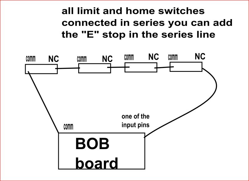

Thanks for bot of you inputs. I have the switches all wired in series and it checks out as I switched the pin 13 to E stop and it triggered the e stop fine I will use that t move to the home selection for testing more inputs. With the way I did it before I had the home and limits as the same switch, The home button move the 3 axis to home, then later if any axis switch hit it was a limit. The UCCNC required to home as the first step at startup. I don't have a problem with no home switches and just using the switches as limits for safety. I do agree with a basic setup and then editing the file after. It does seem I will need to add more wiring for the addition circuits..
I will keep you in the loop and I will need help with the syntax for adding new lines to the files.

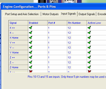

Short history of what I did and how it looked, this is the switch series I used in the past, not any more.
Here is the pins for the switches due to the lack of input pins.
the BOBs I used before only had 5 input pins, 3 used by the THC, one for home/limits and one for Ohmic sensor.
I need to conform to the pins use by Linuxcnc, and that is in the process at this time.
My setup now has a single switch for each axis, located on the moving parts, there is a switch trip at each end of travel for that axis. PhillC I Understand your position as to using the table I load the material and move the torch/router bit to a starting location and tell it that is X 0.0, Y0.0, and Z 0.0 and hit the go button. As I said the table with the UCCNC software it required you to home the table at the start. But then could be used by moving to the location of 0.0 and starting an operation. The main reason for the limits is safety.

Thanks for your help, hope you have some answers. How it is wired is only one input on pi 13 of TB6, this is connected from +24 volts through the switch and back to pin 13 with NC switch. I had selected Z both home+limits I also entered the All home on pin 39 on tb 3 so it puts the All Home on the main screen, shown in the screen shot. When I use the Z arrow to move the Z or hit Z home in the lower left.
The Z axis will move but the switch push does nothing to stop it.
Also I have tried to use Hal show watch to see the switch in action but cannot find any signal name the shows it switching. If in the Pncconf I put the pin 13 for E stop and watch E stop it works just fine. I was told to use TB3 for selecting E stop for the correct operation of the E stop button on the main screen. Now in Pncconf there is only a I/O connector 3 so I hope that is TB3. as it seems to add GPIO to the name in Hal. I have lots of experience with other CNC software and BOB board but none for Linuxcnc.
