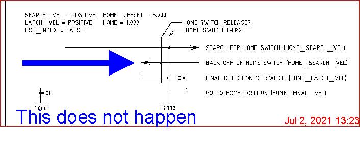

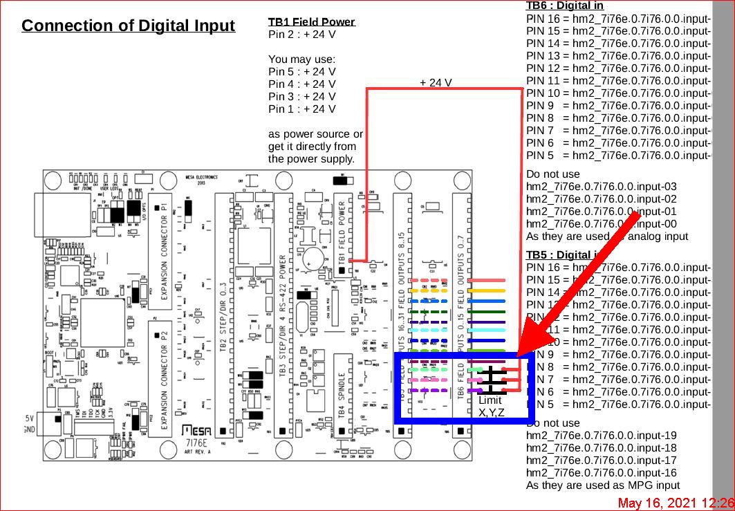

With your help I have made some good progress today, no where near where I need to be but, I actually felt positive. I rewired the 3 axis home switches to single pin inputs for each and tried to use the axis limit + home but it would trip the limit when moving on the switch. So I have it set now with home only for each axis. I am only working with the Z as it is easy to push the switch. I was puzzled why it homed in the wrong direction while moving correctly with the arrow key. After looking over the info in the homing lay out I found this. The direction of the back-off is opposite the sign of HOME_SEARCH_VEL.
I removed the – from the value in the INI and it changed directions and looks like it work correctly. It does get an error if the home switch is pushed to quickly no problem something for later.
I did make the changes of the Net all-limit-home, but it did not seem to work so I changed it back to what it was. I had to change the home switches for NO so they would not error at start up. The diagram I had looked like they should be NC but I could be wrong.
You probably need to invert the inputs, you can do it in PnCconf by checking the Inv box next to the GPIO Input box or you can do it manuually in the hal file by changing from:
net home-z     <=  hm2_7i76e.0.7i76.0.0.input-15
to:
net home-z     <=  hm2_7i76e.0.7i76.0.0.input-15-not
You will need the HOME_IGNORE_LIMITS=1 in each joint that shares a home and limit switch.

02 Jul 2021 19:52 - 02 Jul 2021 19:57 #213507 by acourtjester
Replied by acourtjester on topic New Project with Mesa 7I96 and THCAD-05
I made the changes in the Pncconf to have both limits and home for the 3 axis. It does work, but the operation (pointed to) in the attached image does not for each of the axis. I moves toward the home, I trip the switch and it stops moving then continues in the same direct slower. When I hit the switch again it backs off and sets the DRO to 0.0.   I have tried changing or adding lines in the INI, but cannot make the first back off the switch work.

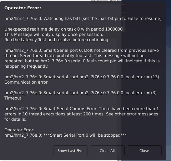

I am also getting the attached error randomly which seem to be for no reason I can connect

02 Jul 2021 20:30 #213508 by rodw
Replied by rodw on topic New Project with Mesa 7I96 and THCAD-05
A couple of things.
1. Home switches MUST remain triggered all the way to the end of travel
2. If using a mechanical switch, you may need to use the debounce component. Its possible that contact bounce causes the back off to be registered prematurely. See linuxcnc.org/docs/devel/html/man/man9/dbounce.9.html
I don't think you can do that in pncconf. It is time to leave it behind

02 Jul 2021 21:50 #213512 by Clive S
Replied by Clive S on topic New Project with Mesa 7I96 and THCAD-05
Do you have something like this in the ini file
HOME = 30
HOME_OFFSET = 0
HOME_SEARCH_VEL = -50 This is the speed to search for the switch changing the sign will reverse the direction
HOME_LATCH_VEL = 1 The same with this so if HOME_SEARCH_VEL is -ve  make the HOME_LATCH_VEL +ve to back off the switch
HOME_FINAL_VEL = 50
