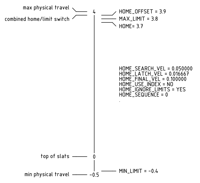

this might be better if you made it go -ve ie. HOME_OFFSET = -0.20000
Replied by Clive S on topic New Project with Mesa 7I96 and THCAD-05
I have just noticed that in your ini file you have HOME_OFFSET = 0.20000 in the Z axis this will make it go off the switch in the wrong directionThanks for the replies from both of you, I will be looking into these on Monday. The wife has a day planned for the 4th, And looks like maybe another blower coming up for the south, forecasters no sure what it will do.

Ok Clive when I had the - on that line it moved to home in the negative direction by removing it the Z than homed the the positive direction. When using the arrows on the screen I have the Z moving up with the + arrow. So to me that seems correct.
As the way it is now setup I hit the home button in the lower left, the Z will move up and hit the home switch back off (down) a very small distance then move slowly up. I hits the home switch again and back off (down) in a quicker movement.
Now there may be another setting that will have the Z act as you say. I know from my experience using Mach, there was a sequence of setting to getting the Z to home and travel in the correct manor. My lack of knowledge of Linuxcnc there may be another setting that is not correct.
From Phill's comment below I have the Home-Offset set with a negative and that may be the whole problem.

Thanks Phill from your attached display it seems I need to change the Home-Offset negative to a positive. Which may also correct the error Clive is talking about above. My lack of knowledge of Linuxcnc is causing many problems, I used the Pncconf to do the original setup and do not change setting. So it shows I don't know what I don't know. With the excellent help form the member here I may get things going.

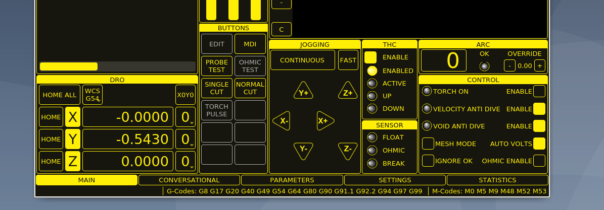

The "X0Y0" button will set the X and Y axes to zero.
The "0" buttons allow the corresponding axis to be set to zero or any other value.
Edit: They are the equivalent off the "Touchoff" button mentioned in the "G54-59.3 User Coordinates" section here
