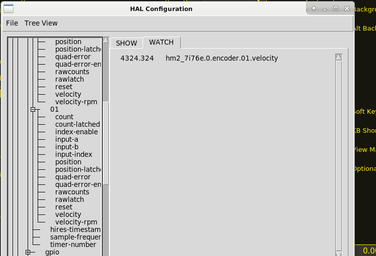

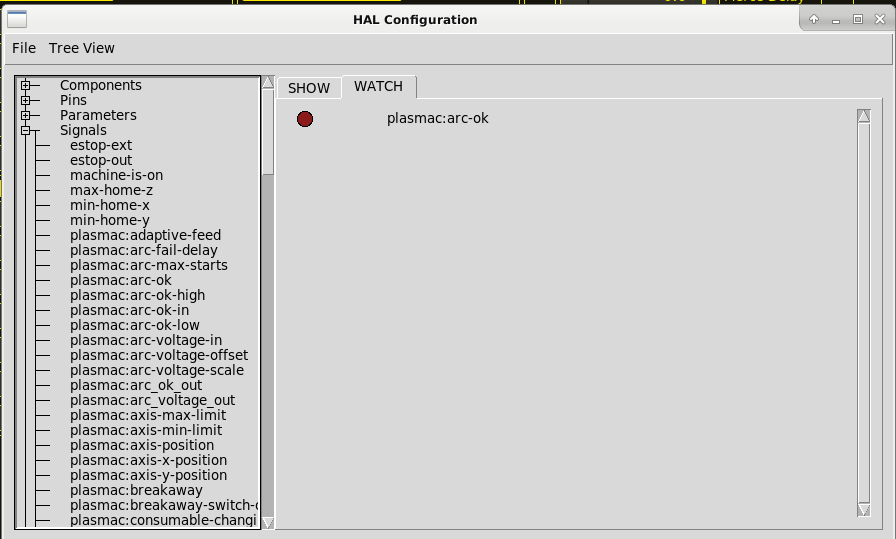

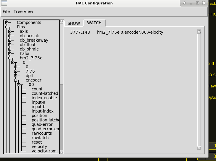

I have good looking numbers in both encoder velocities. And I do see a change when I touch a 9 volts battery to the Arc Voltage wires. Now as to the "E stop" I will let that go for now I can parallele the "e stop switch" with a home/limit switch as pushing any with drop the power so works the same.
I will check the wires for the Ohmic touch as I don't see any indication when I click on the switch I install to simulate the torch touching metal.
I may be reading to much into these things, I do not see anything in the Volts display on the main screen, nor do I see the Arc OK light lite. But I do see the Arc OK light switch in Hal Show?? Are there other conditions that need to be met for these displays to show up?? Like actually running a cut operation?
As usual the member of this forum have directed me farther on the road to a functions operation and I do thank each of you. YEAH

ArcOK will only light if you are cutting and an input is connected correctly in Hal

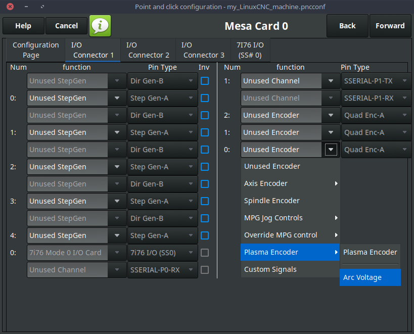

Thats why we need all of Tom's config. I think he moved it to another hal fileI don't see any arc voltage encoder in your hal file, it should have been selected in PnCconf as below:
- phillc54
- Posts: 5711
- Thank you received: 2100
25 Jul 2021 00:13 #215823
by phillc54
Replied by phillc54 on topic New Project with Mesa 7I96 and THCAD-05
What would be the reason for that?
- Posts: 12125
- Thank you received: 4140
25 Jul 2021 00:17 #215824
Replied by rodw on topic New Project with Mesa 7I96 and THCAD-05
I don't know but if the encoders are both counting as reported in earlier screen dumps, its in the config somewhere.What would be the reason for that?
- phillc54
- Posts: 5711
25 Jul 2021 00:20 #215825
by phillc54
It kinda defeats the whole purpose of a machine hal and a custom hal.
