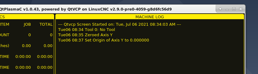

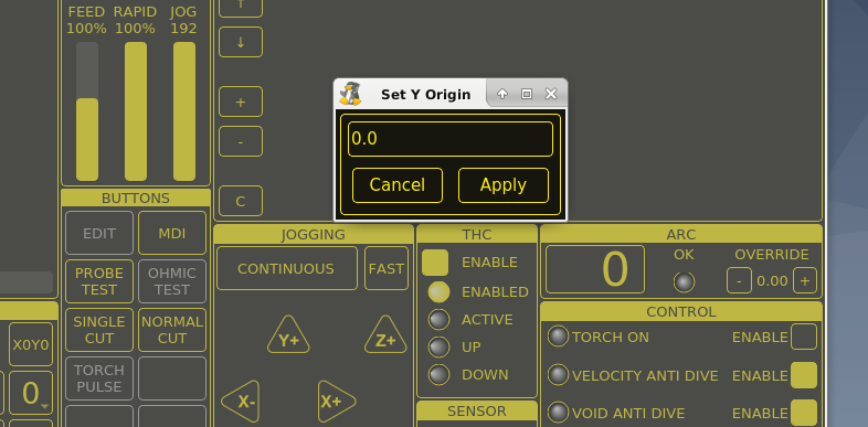

06 Jul 2021 14:04 #213855
by acourtjester
Replied by acourtjester on topic New Project with Mesa 7I96 and THCAD-05
There is a simple solution to the Y 0.0 problem I had, This is why I asked where do I change it.
There is a menu box that pops up when you want to 0.0 the DRO after homing, and other time.
After doing a Home All I clicked on the Y "0" box the menu pops up with 4 selections
Zero
set
divide by 2
set last
I clicked on zero and then set, set brings up a menu box for you to enter what you want the DRO to show.
I entered 0.0 next I ran each axis away from home and did Home All again. This time each home and put 0.0 in it’s DRO
On to the next hickup
Zero
set
divide by 2
set last
