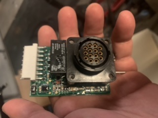

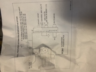

I ended buying the interface card for my plasma well my plasma machine doesn’t have the J-2 connector in the back and but when pictures it shows online for it and not having too much info on any forums I didn’t know it needed to connect to a J-2 connector I did see that I have J10 connector open on the board inside the machine. When I got the interface card I saw that it had a connector on the back side. So now I need to see how I can still use it. I know they sell another cable for the machine the cnc cable assembly and its $84.99 and it looked to have the J-2 connector on one end. Question is now how does that j2 connector run a stick A series machine on the inside how do you get your signal and divided voltage outputs? Is there another plug in the front of the a-series machines?

I think the circuit diagram in the manual shows the connections. You may be able to buy the connectors and make your own cable.

That’s what I was thinking I have the pin out for that connector I just want to make sure that it works when I connect it. Here is the cable they sell I am thinking it’s the same connector J2 and has that screw type connector.

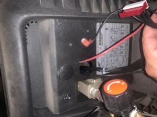

Thermal dynamics cut master 52 bought it with the hand torch and then I bought the machine torch from local shop sl100sv swapped it out and it worked perfect. They way I have it wired right now is just tapping into the trigger wires that go to my relay and then I tapped into the raw arc voltage that goes to my proma. I want to use the interface card in which on the manual it says I can use with my machine. The back of the machine doesn’t have the plug it has a hole there but it’s covered with a blank piece. I have the open connector on the machine board J10 and the ground terminal on my machine where the interface card’s wire harness gets connected to. The only thing I don’t have is that J2 connector mounted on my machine so the card can connected to. I have the pin out to that J2 connector and I am thinking of maybe using that cable I mentioned and use that but want to make sure it will work. I wanted to see on a stick A-Series machine how that J2 connector is mounted in the back and where does that cable go to?

Hmm I think I got it the board gets minutes through the inside not the outside lol I was reading it wrong. So it looks like I am going to need that cnc cable man 84.99 for a piece of cable it’s crazy.
