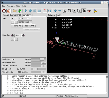

I dont know what Axis GUI means.
Axis GUI (graphical user interface) is the screen graphics:
Whats DRO
DRO is the "Digital ReadOut" is what displays the coordinates on the GUI:

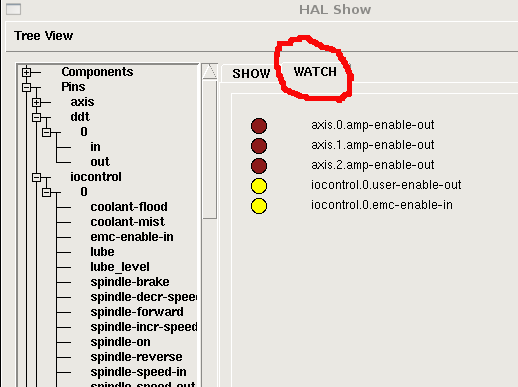

A useful tool is "halshow". You find it in the menu "Machine" and then "Show HAL Configuration". It opens as a separate window:
When you click on the "Watch" tab you can watch the inputs and outputs in real time (dark red = off , yellow = on). You can choose the pins in the left section of the window. For example: to find "parport.0.pin-13-in" you click on "Pins" then "parport" then"0" then "Pin-13-in". You can then press your microswitches and check if they are working properly. Just try it out a bit.
