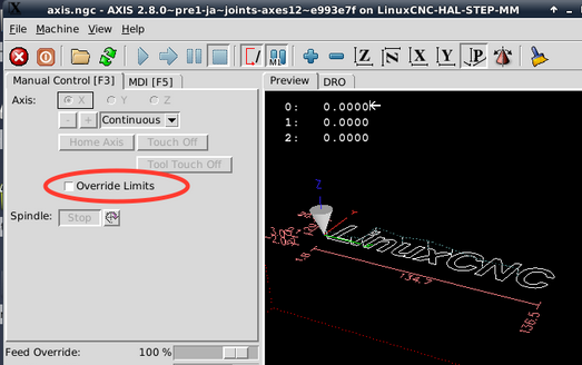

I have problem with the hard limits as the CPU stops but it dosnt move away from the limits so trying to move them manualy dosnt work so i cant start linuxcnc and move the axis because the limit switch is still on.
God weekend Henrik
19 Dec 2020 08:14 #192433 by Aciera
Replied by Aciera on topic Set the home pos.
Doesn't your AXIS GUI have a checkbox "override limits"?
If I recall correctly this checkbox can be activated by clicking on it and then you can jog the axis off the switch. I haven't used the AXISGUI in a long time but that is how it used to work.
19 Dec 2020 11:23 #192447 by MaHa
Replied by MaHa on topic Set the home pos.
Once my machine stoped by limitswitch, i had to check the override limits box, then estop and enable again. Then I could jog off the switch.

20 Dec 2020 13:35 #192534 by Rørbæk
Replied by Rørbæk on topic Set the home pos.
Yes there is a override limits used it and smashed the limit switch.
