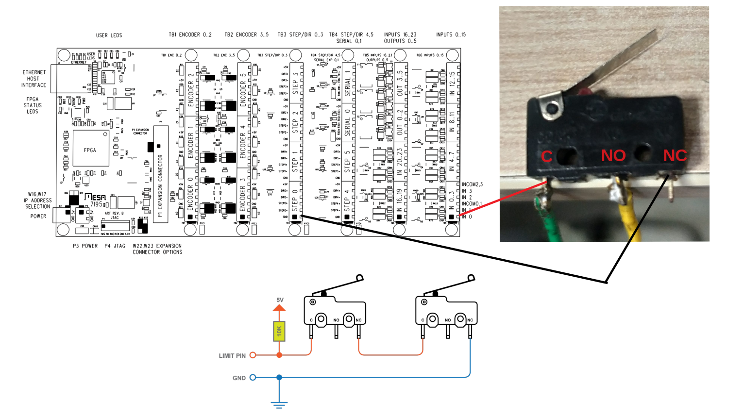

Dear Forum,
With your help, I am able to run the X,Y, Z motors and thanks for everything.

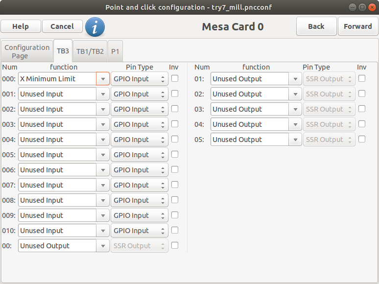

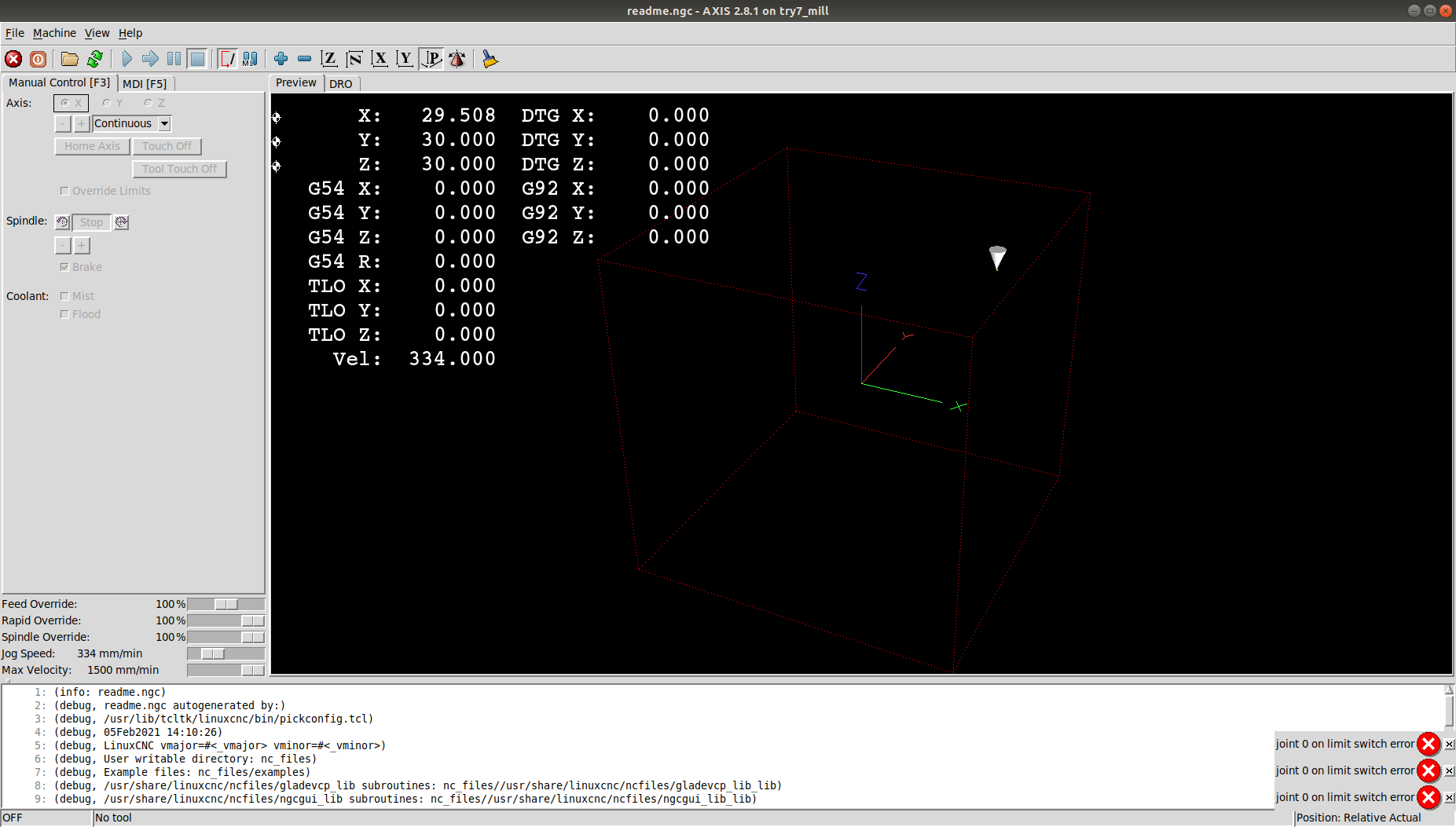

Now I want to connect my simple normal closed type limit switch for x axis only for testing to the mesa 7i95 card. but it gives "joint 0 limit switch error". If I remove the negative X limit setting, it's working fine in jog/MDI mode. It seems I have error in setting home location (30,30,30) position and limit switch position setting. I have attached all the wiring and setting.
I connect limit common pin to input pin 1 and NC pin to the ground of step0. Is the wiring OK?

I tried by inverting the pin but same error. can you explain theoretically, what does actually mean by this error?

The error means exactly what it says, the limit switch is tripped when it should not be tripped.
Change the switch to NO to check if it is working.
Looking at the diagram, the wire connected to encoder gnd should be connected to INCOM01 !

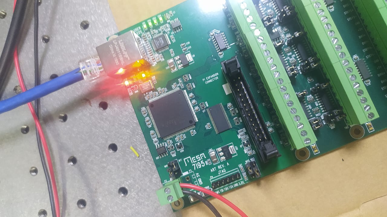

CR19 led is ON (RED). It should be off for normal operation. Any reason for it?

If CR19 is illuminated when LinuxCNC is running, it indicates a watchdog bite
which in turn indicates a hal setup error or a real time problem on the host PC
