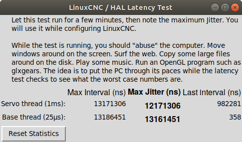

What would be the solution for watchdog bite?
Attached Latency test report, seems very high value. Also attached my computer configuration.
Replied by suraj9735 on topic wiring & wizard setting for minimal working of simple normal closed limit switch
If CR19 is illuminated when LinuxCNC is running, it indicates a watchdog bite
which in turn indicates a hal setup error or a real time problem on the host PC

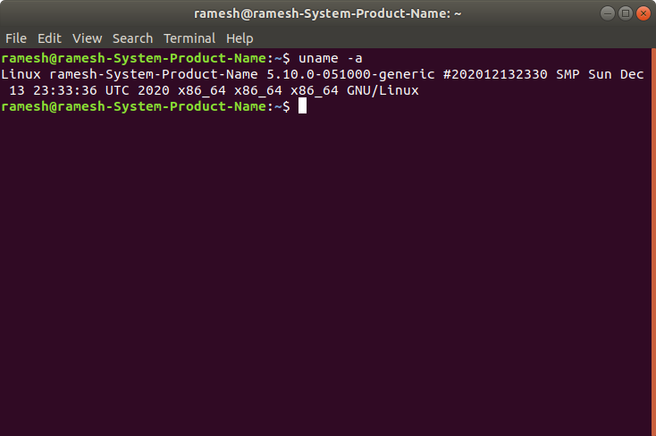

18 Feb 2021 17:35 #199308
Replied by PCW on topic wiring & wizard setting for minimal working of simple normal closed limit switch
what does
uname -a
report?
Also you should not run a base thread when latency testing
try
latency-histogram --nobase --sbinsize 1000
uname -a
report?
try

- Posts: 21738
- Thank you received: 7429
19 Feb 2021 13:15 #199415
Replied by tommylight on topic wiring & wizard setting for minimal working of simple normal closed limit switch
Using generic kernel, switch to RT kernel.
- bevins
- Posts: 1947
- Thank you received: 338
19 Feb 2021 13:26 #199418
by bevins
Your running the wrong kernel. You need a Real Time kernel.
Replied by bevins on topic wiring & wizard setting for minimal working of simple normal closed limit switch

- Posts: 4755
- Thank you received: 2135
20 Feb 2021 14:23 #199527
Replied by Aciera on topic wiring & wizard setting for minimal working of simple normal closed limit switch
The easiest would probably be to download a ready made ISO like the one with debian buster ( first one on this site: linuxcnc.org/downloads/ ) and write it on a USB stick with, for example, "Disk Image Writer". Then boot the computer from that and check the latency again even before installing. If all looks good then install from the USB device.
