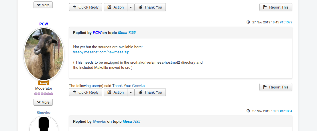

I am using linuxcnc 2.8. I am able to run my motor in jog/MDI/automatic mode very well. When I try to connect Limit switch it gives error "joint 0 is on limit switch error". I tried everything like inverting the pin, NO/NC mode of limit switch but it gives the same error all the time.
I read the forum, people are saying 2.8 doesn't support the input/output pin of mesa 7i95. It may be the reason that I am not able to use my input pin 0. They are suggesting to install the the 2.9 master file and I don't know where to find it.
What to do?????
1) upgrade to 2.8.1 and check again???
2) need to install 2.9 master file????
Please help

24 Feb 2021 11:40 #199960 by tommylight
Upgrading to 2.8.1 should be easy, see
Buildbot.linuxcnc.org
Pretty sure there was talk of porting the Mesa 7i95 code to 2.8, not sure if it happened.

24 Feb 2021 12:12 #199966 by suraj9735
If you see my above discussion in this thread only, I was using 2.8.1 in Ubuntu with generic kernel and everything was running well except limit switch. So I think upgrading to 2.8.1 with RT PREEMPT won't solve my limit switch problem but I will try.
I found one discussion about downloading a newmesa.zip file and unzipping in mentioned folder can solve the working of i/o pins of mesa 7i95. Should I try this?
newmesa.zip discussion
