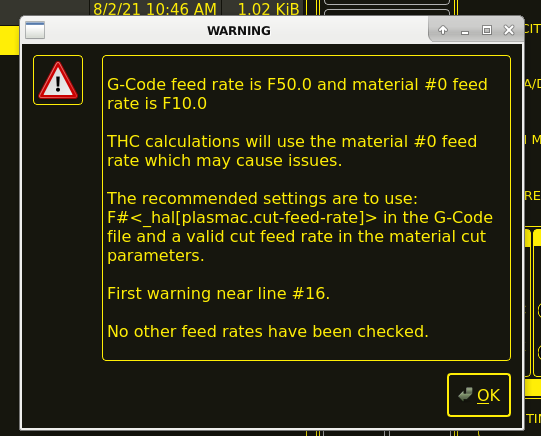

HI Guys
still trying to get this thing going, wanted to see if I loaded a G-code for the simple box shape to see what would happen. Well another gut punch from LinuxCNC. first I used SheetCam LinuxCNC PlasmaC post processor, It produced a G-code with lots of lines, many I have not seen before. Next Linuxcnc plasma THC produced a simple G-code with what I expected. Copied to the control PC and loaded it in QTPlasmaC it raised the Z to the limit, first thing. Looked at the G-code and there was an added like, not in the original G53. I tried to edit it out no luck, it is in there for all time.
Google G 53
G53 is much easier to understand and use. It is a simple motion command, like G00 or G01, but with G53, the origin for the motion is the machine's zero return position and the motion will occur at rapid. Here is the command to rapid the Z axis to the zero return position: G53 Z0.
Other errors would pop up too,
Why and where is it getting this from, attached is a screenshot with the original and the G-code from QTPlasmaC. I hope there are answers for how to get rid of this so I can move on.
Have fun
Tom

Your gcode says you’re using a “LinuxCNC - THC” post processor. That’s not the right post. I think it’s just plain “PlasmaC” if memory serves me correct. It’s rev 0.2 I know that.
As for the added Z move, that’s standard and is part of QtPlasmac. You can read about it in the first portion of Section 8 here:
http:/linuxcnc.org/docs/devel/html/plasma/qtplasmac.html#_using_qtplasmac
For the feed rate I think that error means that your gcode is specifying a feed rate in x and y that is different than the overall feed rate in the material file. I’m fairly certain the correct post would take care of this too, but do note you need to make sure the material numbers in sheetcam and Qtplasmac align.

Acourtjester,
I've attached a copy of a tap file I've created recently. I've added spaces to separate pre-amble, material setup, etc, and make it more readable. I'm still in the early days of learning everything and only just did my very first cut with the attached file. Best advice I can give is read the documentation thoroughly.
Go through each line one by one and refer to the Qtplasmac documentation to get a good understanding what they are telling Qtplasmac to do.
It is indeed very different from Mach3 and UCCNC.
Notice the lack of Z moves in the gcode file. This is normal for Qtplasmac although there is a way to have Qtplasmac take notice of Z commands in gcode (again, explained in the Qtplasmac documentation).

Thanks for the reply and info I had tried the PlasmaC post processor but it had so many lines the did not make sense, like tool height compensation. It's clear I need to get PhillC's post processor that you used Beefy, and also convert my SheetCam tools to Linuxcnc so they can be used too. Its like somethings need to unlearned from the Mach and UCCNC days
. I looked at the PP from Rod and it had this statement ( CandCNC DTHCIV with Floating head ), I know they have switched to LinuxCNC base too. So I wonder if it would work with the QTPlasmaC screen set, as I think Rod is changing over to QTPlasmaC now.
I assume =smallmaterialverter.py is already part of LinuxCNC, as I could not find a download.

I would not use my post processor. It is obsolete now.
It was originally written back when a couple of us were trying to keep compatibility with candcnc but I rewrote it when plasmac arrived.
Linuxcnc uses a .ngc prefix and you can set that in sheetcam.

By default plasmac strips out any Z axis moves unless you change something. All probing is done on an M3
Beefy, don't upgrade for a while.... some stuff got broken when python2 was removed from master.
