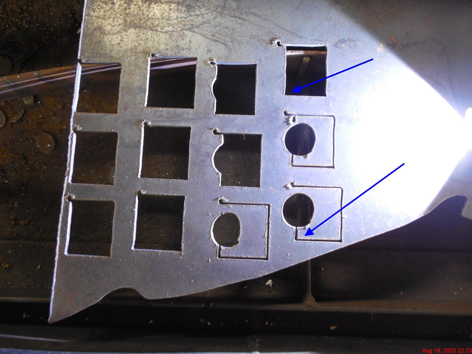

It seemed to be in the middle of a cut operation. The test was to cut 3 rounds in 3 squares, and it happened in the square cutting part of the operations. These were about 1.5" square, it was intermittent not consistent.

Not sure if this will help but here is the cut where the problem happened. The arrows show where the stop happened. A resume cut message cam up and I clicked on it. This in turn cause the position of G-code to shift as you can see the first row cut ok ( I know the cut shape is wacko, I have since recalibrated the motor travel). It seemed the position of the cutter does not return to the correct restart position, when the resume cut is clicked.
Understand this is the first attempt at cutting to see what works. Now to the debounce, I have not changed those setting and they all seem to be at 5. I my way of looking at the change of voltage divider change from 50:1 to 20:1 may get a wider range of sample for the software to work with. I did replace the consumables when the problem started without a good result, I clamp the work lead directly to the metal being cut. I have not had a chance to make the changes to the Hypertherm or the Arc Voltage Scale value. the Arc Ok signal is wired with the pull/down resistor as published and worked fine with Hal show when checked.

Asuming those are all the same shapes, i would look at grounding first, then wiring.
Shifting position is always a sign of interference or loss of power to the drives due to voltage drop from plasma cutter draw.
