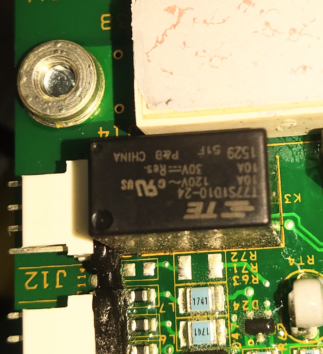

this is from my hypertherm powermax 45 (non XP).... surprised they did not use a better relay.... (faster + sealed)
TE T77S1D10-24
www.google.com/url?sa=t&source=web&rct=j...R2FFH8C10rLl-7avOTn1
www.google.com/url?sa=t&source=web&rct=j...QwAYWjZUUS8oF8MhKnd5
min recommended = 100mA @ 5V (0.5W)
so, at 24v => 0.5 / 24 = ~ 21mA
again... surprised they did not choose a better relay.... (360 operations per hour (for an arc transfer relay on a plasma cutter) 10msec operate and 4msec release time)

Interesting to see they are the same relay in a 45 non XP and a 65 XP.
I agree on being surprised by their relay choice, I remember thinking the exact same thing when I took a picture of mine and looked up the data sheet.
I also agree that blindly following resistance value advice is a bad idea.
I live in hazy, hot, and humid Pennsylvania and have had no issue with not increasing the current for contact wetting. But I keep the knowledge stored away should the issue arise.

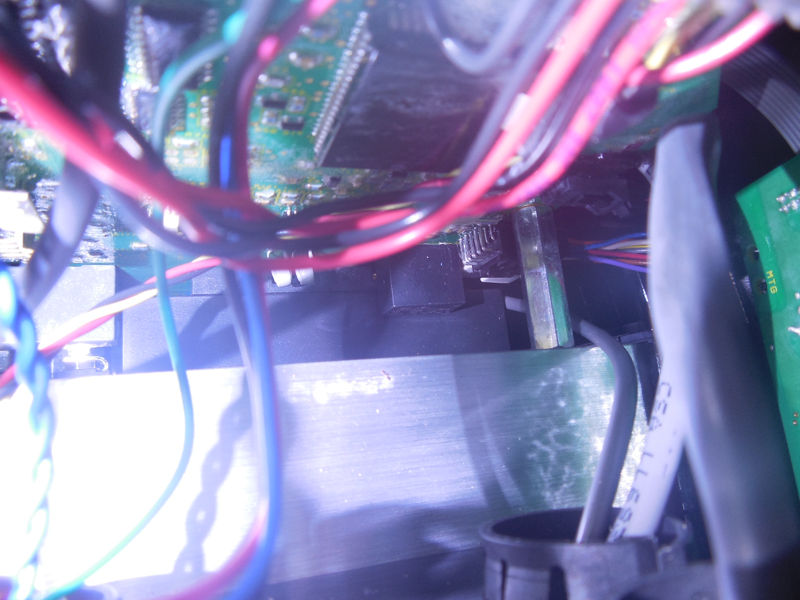

Ok here is the word from the shop. I changed the voltage divider in the hypertherm to 20:1 and the Arc Voltage Scale in the QTPlasmaC.prefs file and bumped up the debounce to 7 (was 5). Ran test cuts fine only arc lost was cutting over an open space in the metal.DUH. I could not get a good image of the relay on the PM65, (middle image). Cut the wrench but dimensions are off need to redo the steps per.
thanks again
Tom
