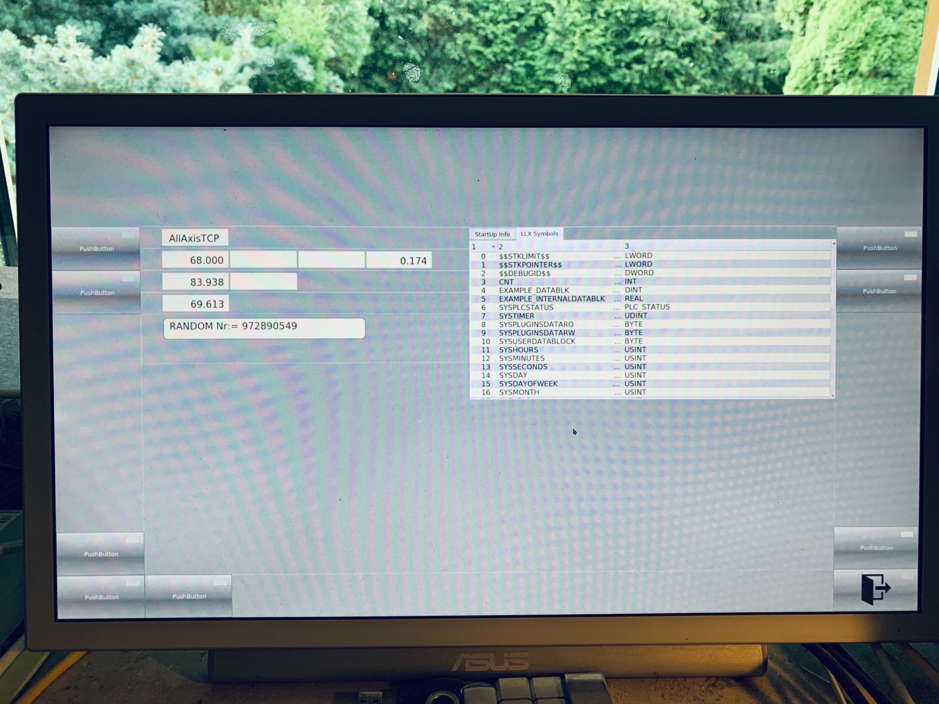

23 Aug 2021 14:46 #218521
by udoS
If you have a look at the short YouTube you will see
Linuxcnc
Vismach
Gremlin
and on the win10 the IDE from LogicLab's axel-plc that's online with the plc running on the Linux PC with EtherCAT Master connected to 5 axis Puls/train Board slave. The config is a standard ESI File.
For that plc I build a PlugIn that IPC_CREATE's a named Shem with semaphore to connect to the HAL. In the HAL nothing is connected except 4 axis cmd and 4 axis fb. PLC running at 1ms main task connecting the linuxcnc Values with the EtherCAT slave.
Whats commented in the Qt main window is the communication with the plc updating at 50ms.
github.com/cnc-nexT/Qt-Lcnc
Now the coolest thing would be to use the PlugIn for the nml communication and the Qt also talking to the plc. BINGO.
Maybe no need for the HAL at all. That'll be the day.
