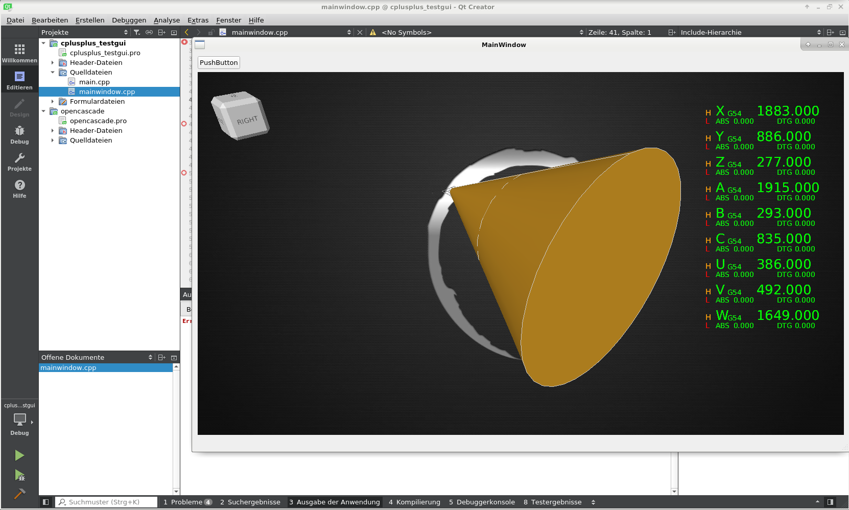

07 Sep 2021 19:32 - 07 Sep 2021 20:51 #219871
by udoS
Replied by udoS on topic Building new Full Qt c/c++ HMI (incl. nml and EtherCAT )
Here we go.

07 Sep 2021 22:06 #219889
by Grotius
Replied by Grotius on topic Building new Full Qt c/c++ HMI (incl. nml and EtherCAT )
Nice work !
0.
Now you can change the background of the widget to something you like.
The background is now stretched: "Aspect_FM_STRETCH", but there are more settings available.
1.
To setup the cone z upwards, edit the file :
draw_primitives.cpp line 14 + line 21 must be : gp_Dir axis=gp::DZ();
2.
To send tool position data from nml to the opencascade you could consider a function like below.
The typedef is used to avoid confilects between qt and lcnc source files.
3.
Then to setup the cone (only once) in opencascade :
4.
And for translating the cone. Following your nml xyz positons.We pick the quaternion function.You can see i used the QVariant datatype to sent the data visa versa.
You can expand the Stringlist with extra axis values.
Ok good luck!
I hope the gcode parser can read this type of gcode.
Nice work !
0.
1.
2.
typedef RCS_STAT_CHANNEL mystattype;
mystattype *status_channel;
QStringList list;
QVariant Nml_plugin::get_tcp_pos(){
EMC_STAT *emcStatus;
for(int i=0; i<1; i++){
usleep(100);
if(!status_channel->valid()) continue;
if(status_channel->peek() != EMC_STAT_TYPE) continue;
emcStatus = static_cast<EMC_STAT*>(status_channel->get_address());
list.clear();
list.push_back(QString::number(emcStatus->motion.traj.position.tran.x,'f',3));
list.push_back(QString::number(emcStatus->motion.traj.position.tran.y,'f',3));
list.push_back(QString::number(emcStatus->motion.traj.position.tran.z,'f',3));
QVariant data(list);
return data;
}3.
void Opencascade::load_tool_cone(QVariant data){
QStringList list=data.toStringList();
double bottomdiameter = list.at(0).toDouble();
double topdiameter = list.at(1).toDouble();
double height = list.at(2).toDouble();
Ais_ToolCone = draw_primitives().draw_3d_cone({0,0,0},bottomdiameter,topdiameter,height);
Ais_ToolCone = draw_primitives().colorize(Ais_ToolCone,Quantity_NOC_GREEN,0);
m_context->Display(Ais_ToolCone,Standard_False);
}4.
void Opencascade::translate_tool_cone(QVariant data){
double x = list.at(0).toDouble();
double y = list.at(1).toDouble();
double z = list.at(2).toDouble();
Ais_ToolCone = draw_primitives().rotate_translate_3d_quaternion(Ais_ToolCone,{x,y,z},0,0,0);
m_context->Redisplay(Ais_ToolCone,Standard_False);
}You can expand the Stringlist with extra axis values.
Ok good luck!

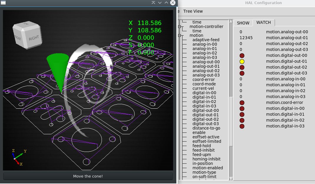

08 Sep 2021 17:18 #219976
by Grotius
I looked for your question. The first solution i found is :
command_channel = new RCS_CMD_CHANNEL(emcFormat, "emcCommand", "xemc", filename.toStdString().c_str());
EMC_MOTION_SET_AOUT out;
out.now=1;
out.index=1;
out.start=12345;
out.end=54321;
command_channel->write(&out);
EMC_MOTION_SET_DOUT dout;
dout.now=1;
dout.index=1;
dout.start=1;
dout.end=0;
command_channel->write(&dout);Attachments:

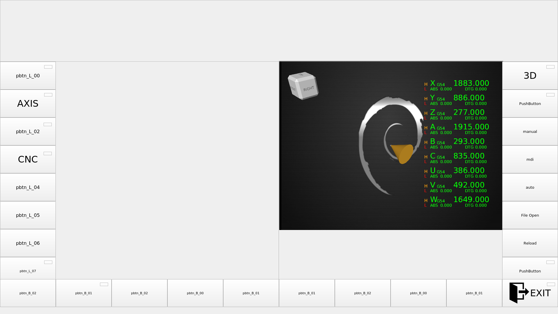

19 Sep 2021 09:49 #221072
by udoS
This is where I'm as of today. (Yesterday... )
and still going...
and still going...
