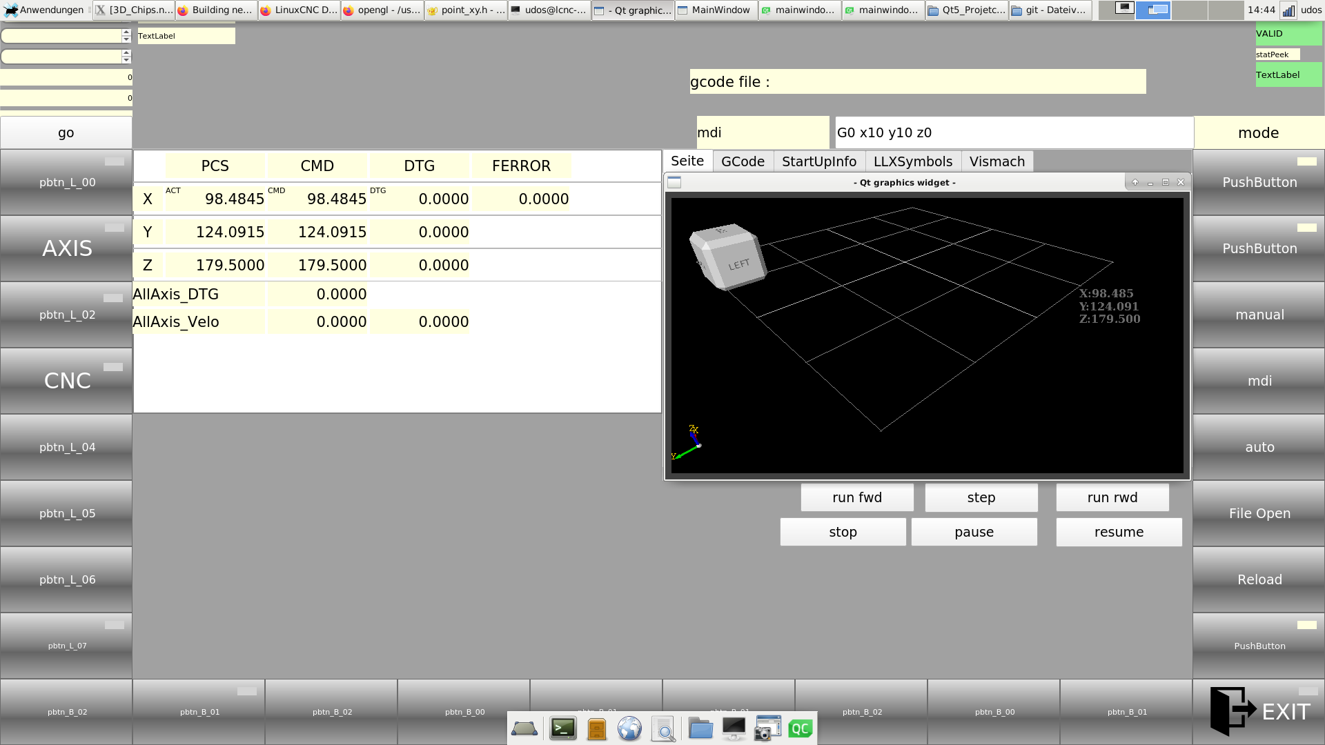

06 Sep 2021 09:54 #219747
by udoS
Replied by udoS on topic Building new Full Qt c/c++ HMI (incl. nml and EtherCAT )
@Grotius
Your Qt_Graphics_Widget is talking to Linuxcnc. LOL

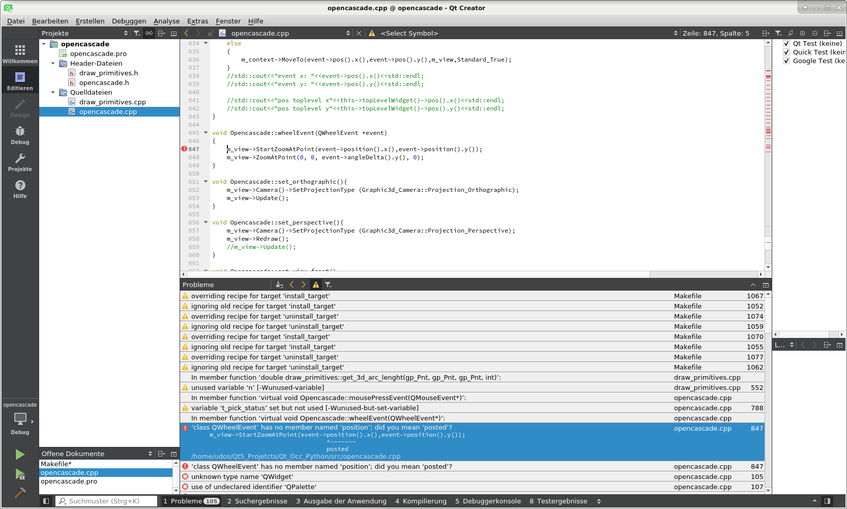

06 Sep 2021 13:29 #219758
by udoS
@Grotius
Can you tell me what this means. ?

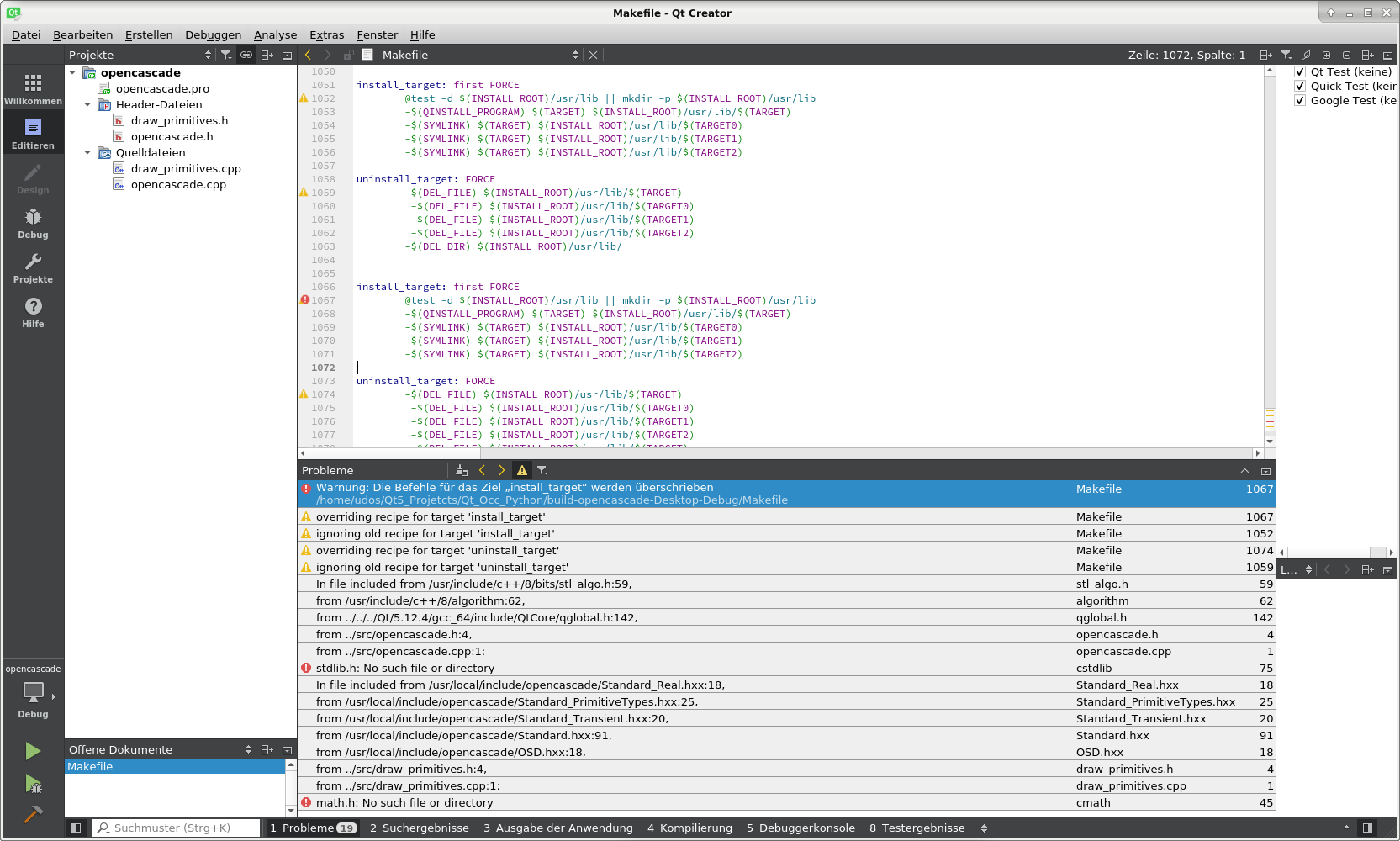

- udoS
- Posts: 216
- Thank you received: 25
06 Sep 2021 13:31 #219759
by udoS
@Grotius
And this for info.
And this for info.

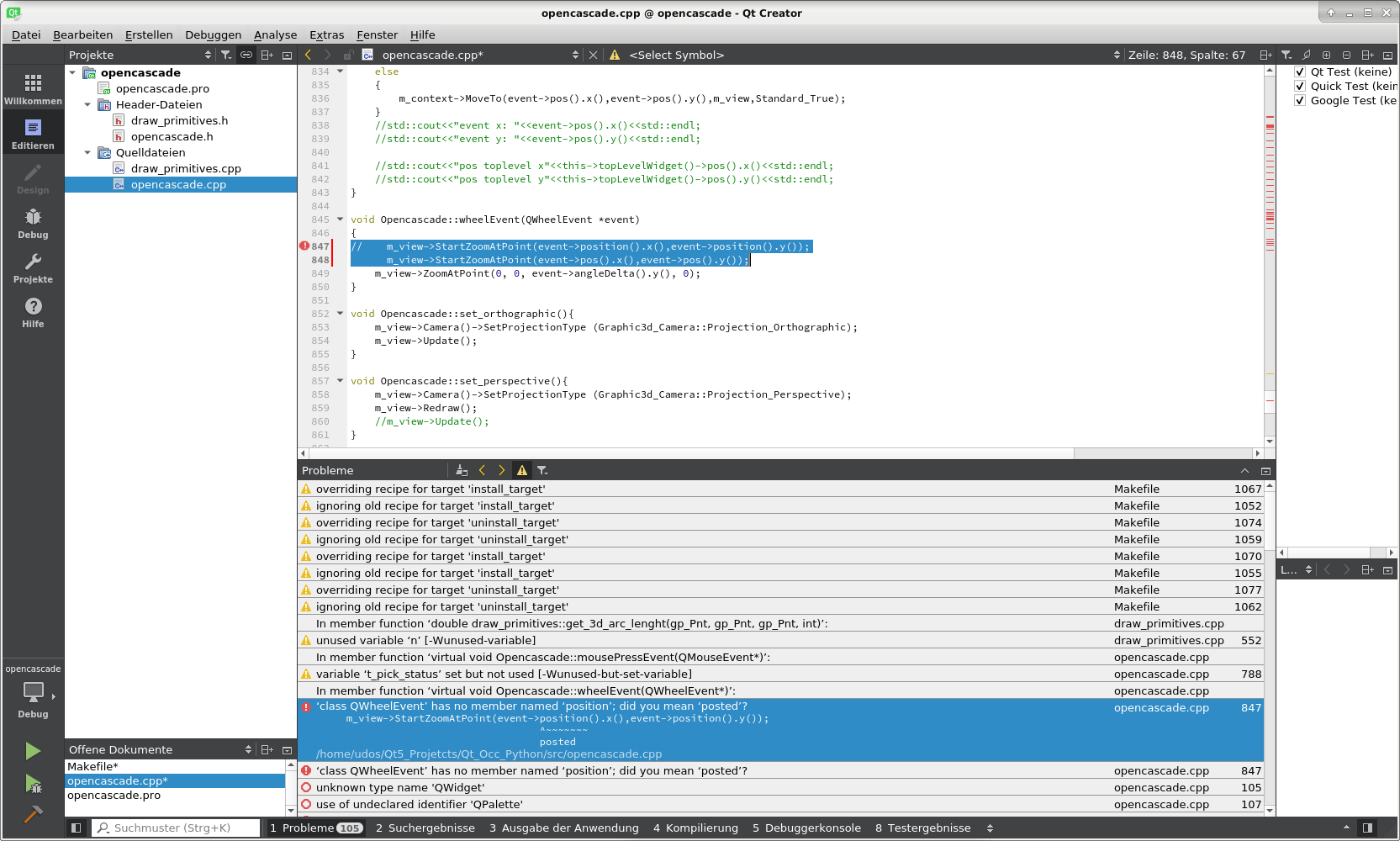

06 Sep 2021 17:07 #219773
by Grotius
Replied by Grotius on topic Building new Full Qt c/c++ HMI (incl. nml and EtherCAT )
It looks you have to install c++ standard librarys for "math" etc. You can look wich one includes math.
I suggest to install "build essentials" packages.debian.org/sid/build-essential
For the wheelevent, wich qt version are you working on? I use 5.15.2
Your last post is about recompling opencascade to enable "pictures" and "textures" with the help of the "freeimage" lib.

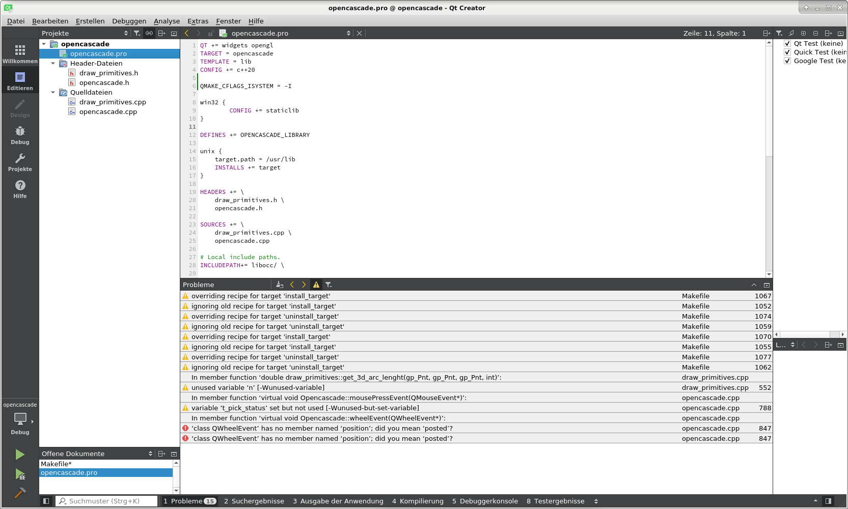

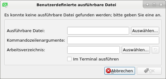

- udoS
- Posts: 216
06 Sep 2021 21:54 - 06 Sep 2021 21:57 #219793
by udoS
Nop. I' still on 5.12.4 ;
That math ... thing is all solved. Same problem like the include_next <stdlib.h> . But I got that figured out.
You need to add a QMAKE_CFLAGS_ISYSTEM = -I into the .pro right under the CONFIG += c++11
3 things:
1.) the qt_test does not find the Lib += -I../ -lopencascade. even so it's there.
2.) at compile time of the opencascade.pro it asks for a file ... etc. see picture from last entry.
So what pictures and textures and path do I add there. From your sample or .... ?
3.) Any clue how to send the feedback of the drive back to the cnc over the nml channel. This is most pressing. No step forward.
3 things:
