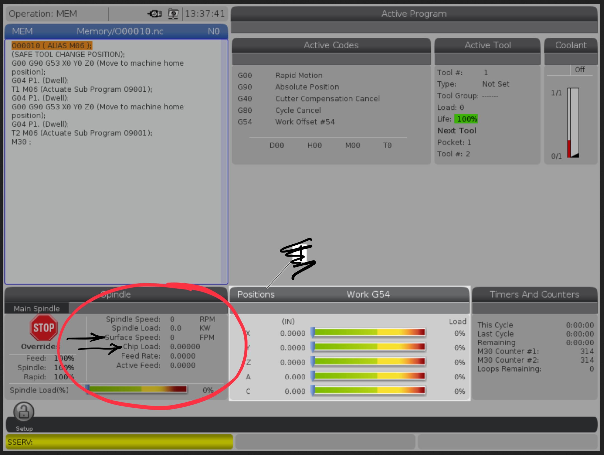

04 May 2024 06:47 - 04 May 2024 06:51 #299690
Replied by Aciera on topic Which UI?
Feed per tooth is the depth of cut and is a function of feed rate, spindle speed and number of teeth:
www.machiningdoctor.com/machinistglossary/feed-per-tooth/
Displaying this is fairly simple but you will need to enter the number of teeth of the current tool into a custom panel and then calculate the feed per tooth in a custom component. I have been doing this in gmoccapy for years.
[edit]
Calculating the cutting speed is even easier and Gmoccapy does this out of the box
www.machiningdoctor.com/calculators/mill...lculator-and-formula

05 May 2024 16:10 #299821
by fully_defined
Surface speed? YES. Surface speed is far more relevant a data point than RPM. Again, RPM and feedrate and simply INPUTS to a formula which every machinist should be using to get to the OUTPUTS of surface speed and feed per tooth, which are what actually matter.Haas includes this data in real time in their NGC DRO, and it populates if you include the flute count and nominal cutter diameter in the tool library page. You have to scroll right pretty far, and I have never met anyone other than me that bothers.
If I were to start using LinuxCNC, I would want to recreate this little screen:
Outside of that, I want to tweak some of the UI like getting rid of the graph. I should only be looking at numbers and gcode scrolling by.
Replied by fully_defined on topic Which UI?
JTAciera already covered it, but FPT (sorry, I mixed up the letters earlier LOL), AKA "CHIPLOAD" is the driving value for ALL milling operations. It tells you exactly how much each flute cuts, per revolution of the cutter. All of the inputs, like RPM, feedrate, cutter diameter, etc. are just that: INPUTS. They don't tell you anything on their own. Many machinists simply commit to memory good combinations of these values, but it's far more relevant to set a target for feed per tooth and then adjust the parameters until you get the optimal result, and a lot of social media machinists will call this a "recipe", without realizing that they are just reinventing FPT.Can you define what feed per tooth is? I just want to be clear as to what you need.
JT
