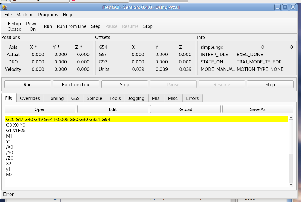

05 May 2024 18:01 #299858 by JT
Replied by JT on topic Which UI?
Ok so you want dynamic information not a calculator. That can be done in Flex and you can add what ever you want to the GUI.
This is one of my test GUI's
JT

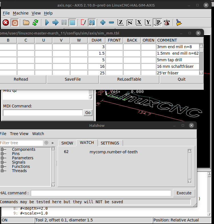

06 May 2024 11:41 - 06 May 2024 11:46 #299957 by Aciera
Replied by Aciera on topic Which UI?
In master we have access to the comment string in the tool table so it is possible to add the number of teeth for each tool in the tool table and then we can extract it in a python component:
#!/usr/bin/env python3
import re
import hal
import linuxcnc
h = hal.component("mycomp")
h.newpin("number-of-teeth", hal.HAL_FLOAT, hal.HAL_OUT)
h.ready()
# create a connection to the status channel
s = linuxcnc.stat()
n = 0
try:
    while 1:
        s.poll() # get values from the status channel
        current_tool = s.tool_in_spindle # get curent tool-number
        if s.tool_in_spindle != 0: # a tool is loaded
            tool_comment = s.toolinfo(current_tool)['comment'] # get the comment string of the loaded tool
            m = re.search(r'(?<=n=)\d+', tool_comment) # search the comment string for a one- or two-digit number after 'n='
            if m is not None: # comment string contains the information
                n = float(m.group(0))
            else: # comment string does not contain the information
                n = 0
        else:
            n = 0
        # set hal pin
        h['number-of-teeth'] = n
except KeyboardInterrupt:
    raise SystemExit
In version 2.9.x we would need to enter that information in one of the offset collumns (eg 'W') but some GUIs (eg Gmoccapy) hide the offset columns of unused axes.

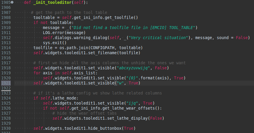

07 May 2024 00:44 - 07 May 2024 00:55 #300001 by Aciera
As a note to my last comment, it's quite simple to make a hidden column reappear in the tooleditor of gmoccapy. Just add line 1921 to 'bin/gmoccapy' with the column(s) you want (eg 'w') as in the screen shot below. The value in the example 'W' column can then be accessed like this:
value = s.tool_table[s.tool_in_spindle].woffset
Last edit: 07 May 2024 00:55 by Aciera.
