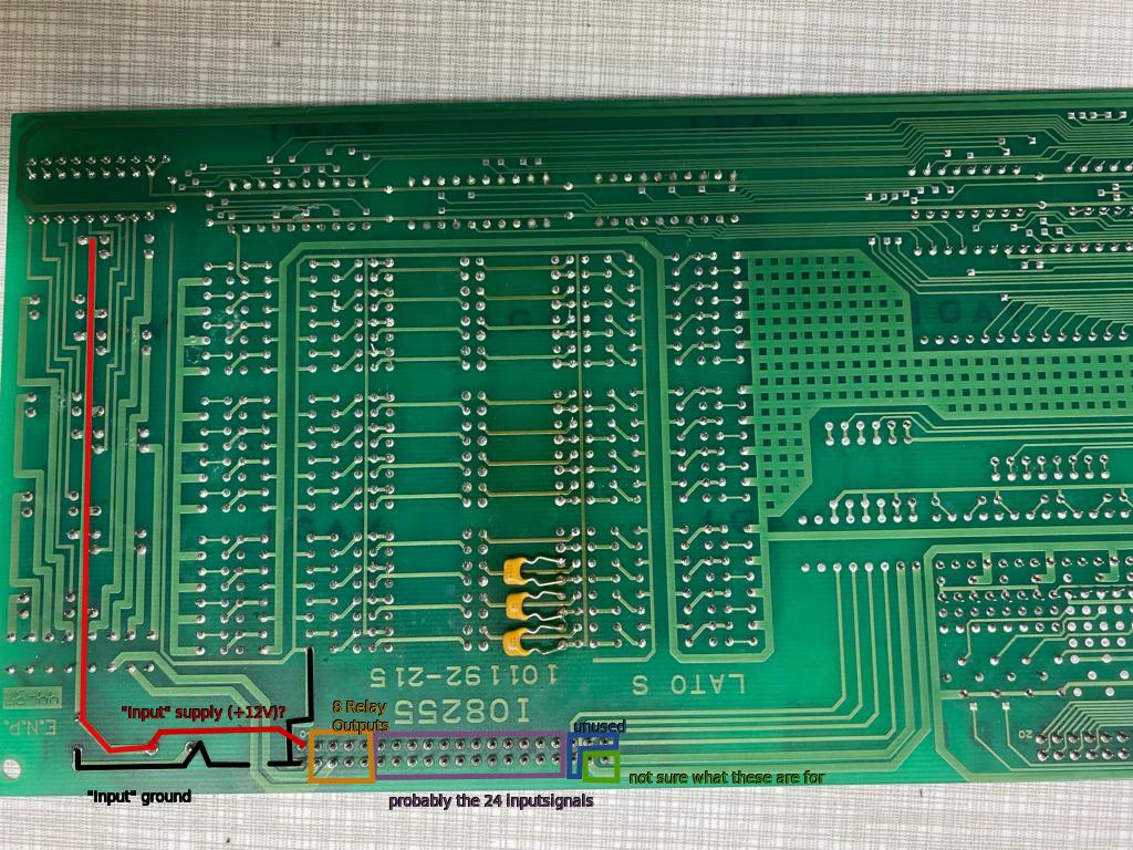

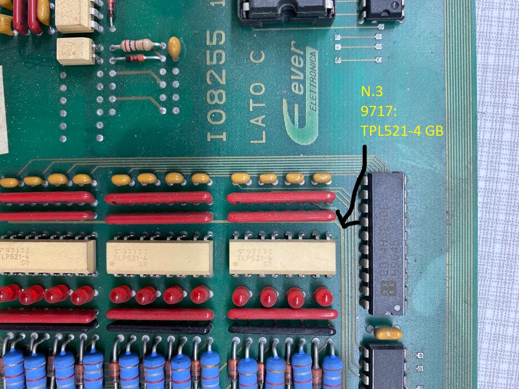

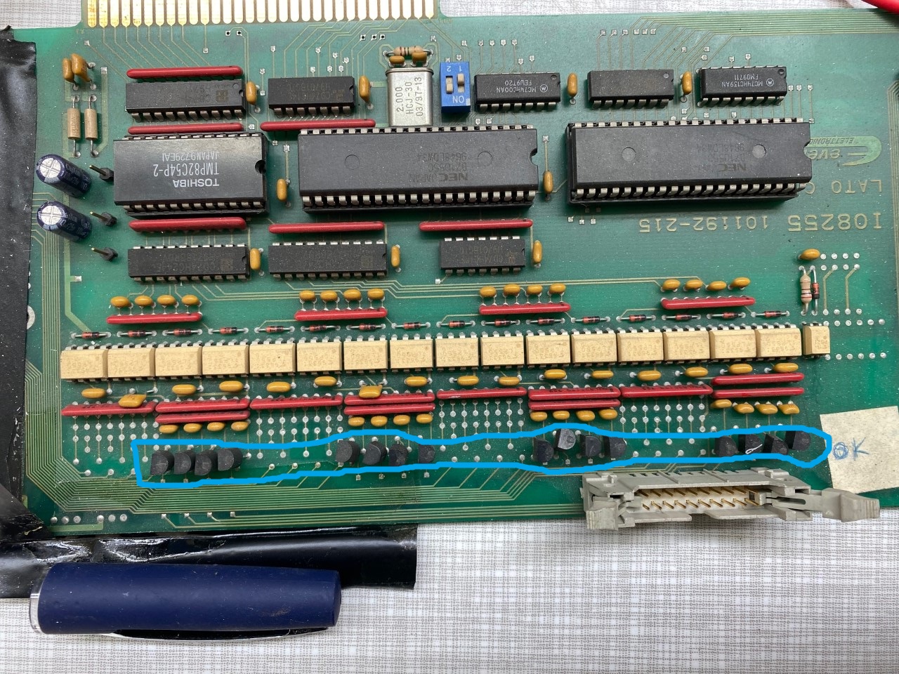

Mythical guys!!! I ran the continuity tests and immediately found the connections. As Aciera claimed, the pins were the upper ones (red), and on the lower pins (yellow) all the transistors share pins 2-12 of the IDC20 flat cable. I have marked the other links. I update the photos of the card. How can I proceed with the inputs? Have i tried circling them in blue, i found their pins but they are few, the cable is IDC40. A good sunday for you!! Thanks
- Posts: 4764
- Thank you received: 2136
02 Oct 2022 11:22 #253243
Replied by Aciera on topic Retrofit cnc 3axis

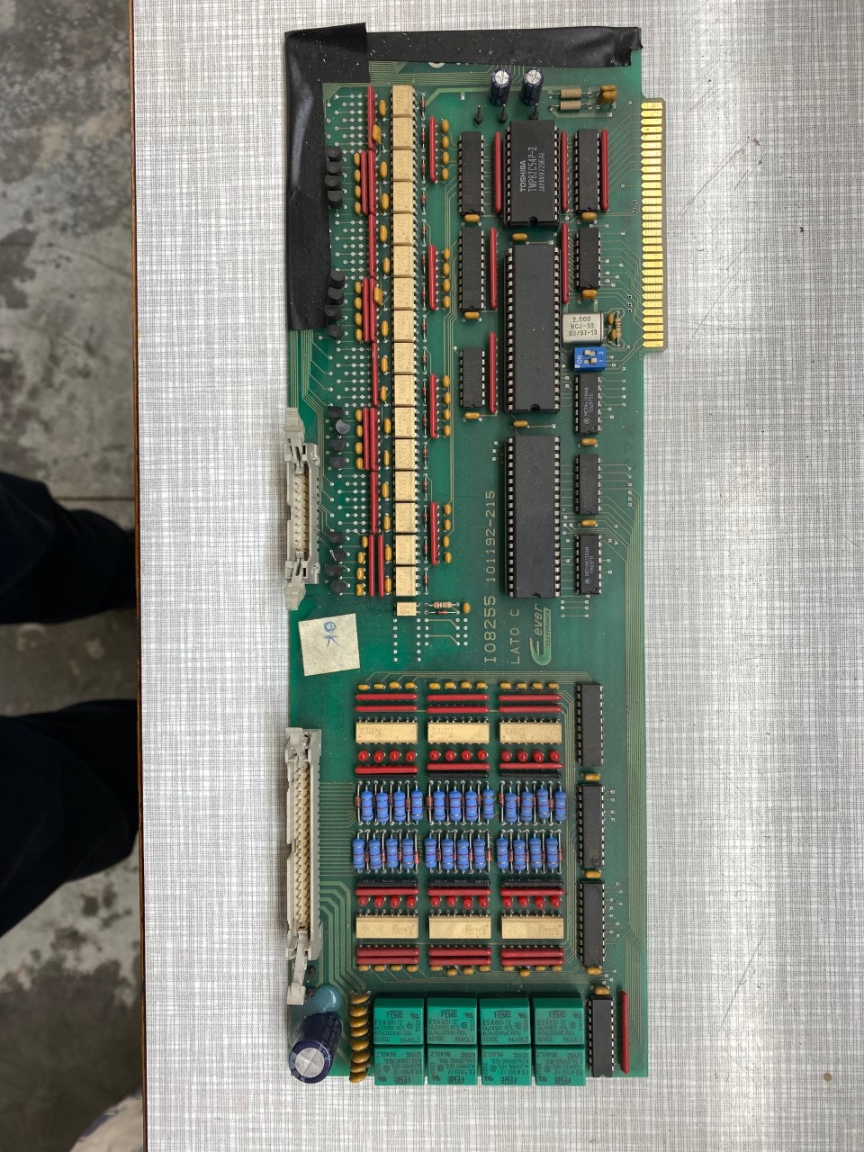

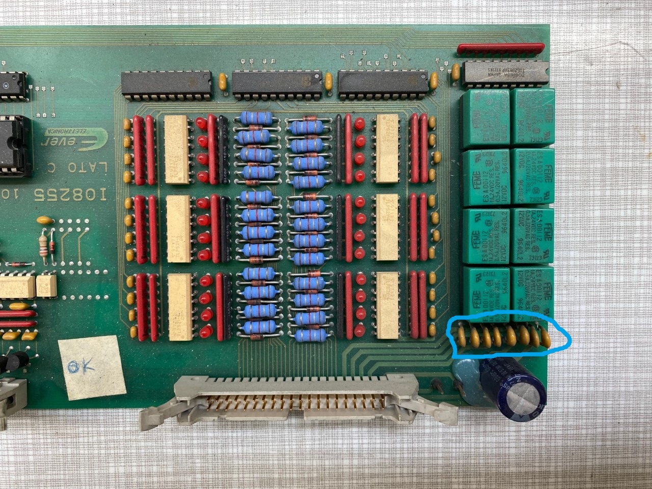

The "input" connector seems carry 6x4= 24 inputs and also 8 relay outputs (the large green blocks on the end of the board). You can see the the 24 thin traces coming out from under the ribbon connector and probably go to one end of one of the large blue resistors (see red arrow on my image). The wider traces will be the going to the relays.

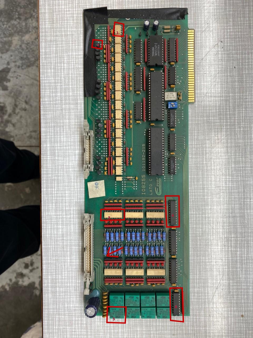

Can you read off the part numbers of the parts marked in red boxes in the attached image or post images with higher resolution that show the part numbers ?I don't need the relay part numbers (marked with number 5 on my image) )those are clear enough on the image.

Those LEDs (shiny round red parts in 6 groups of four beside the yellow ICs) are going to be very handy to figure out which input is connected to which sensor on the machine. Once you have the pins of the 40pin connector traced to the resistor you will know which pin is active by looking at which LED lights up when running the machine.
edit:

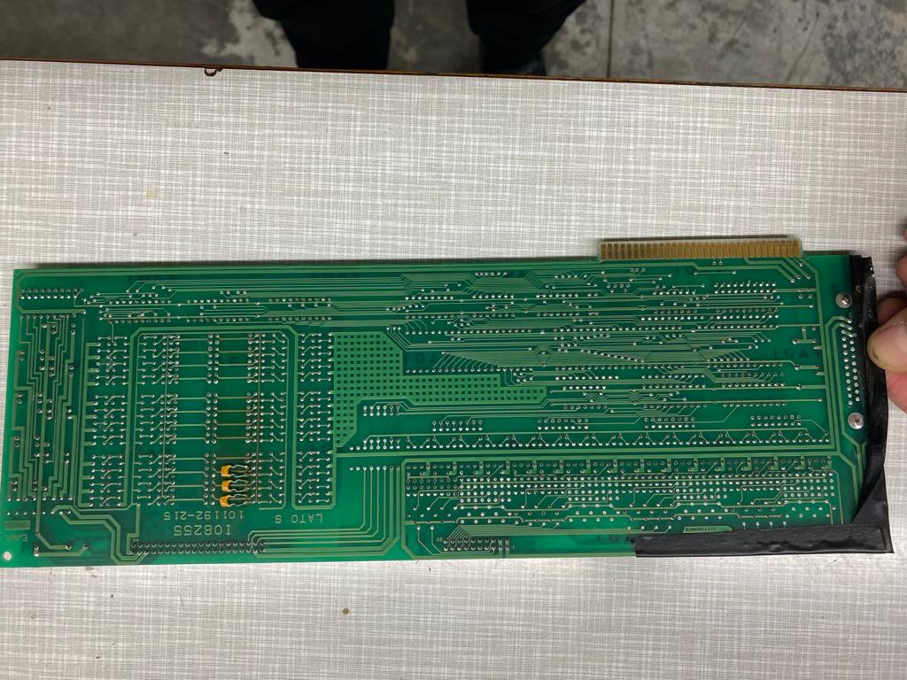

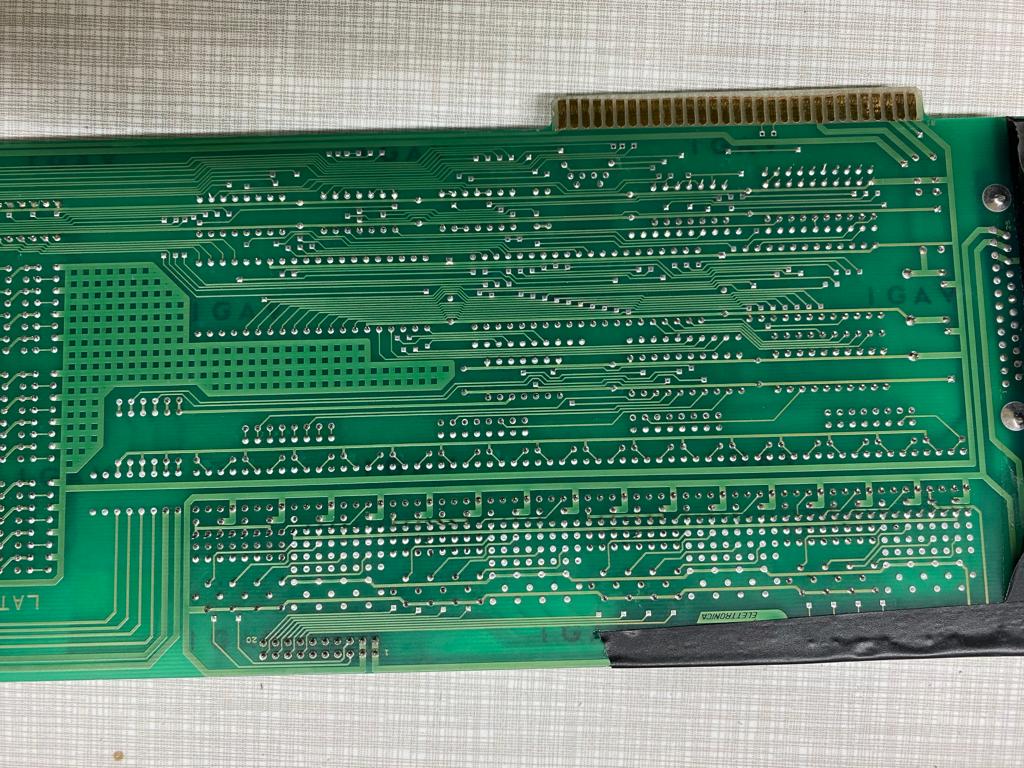

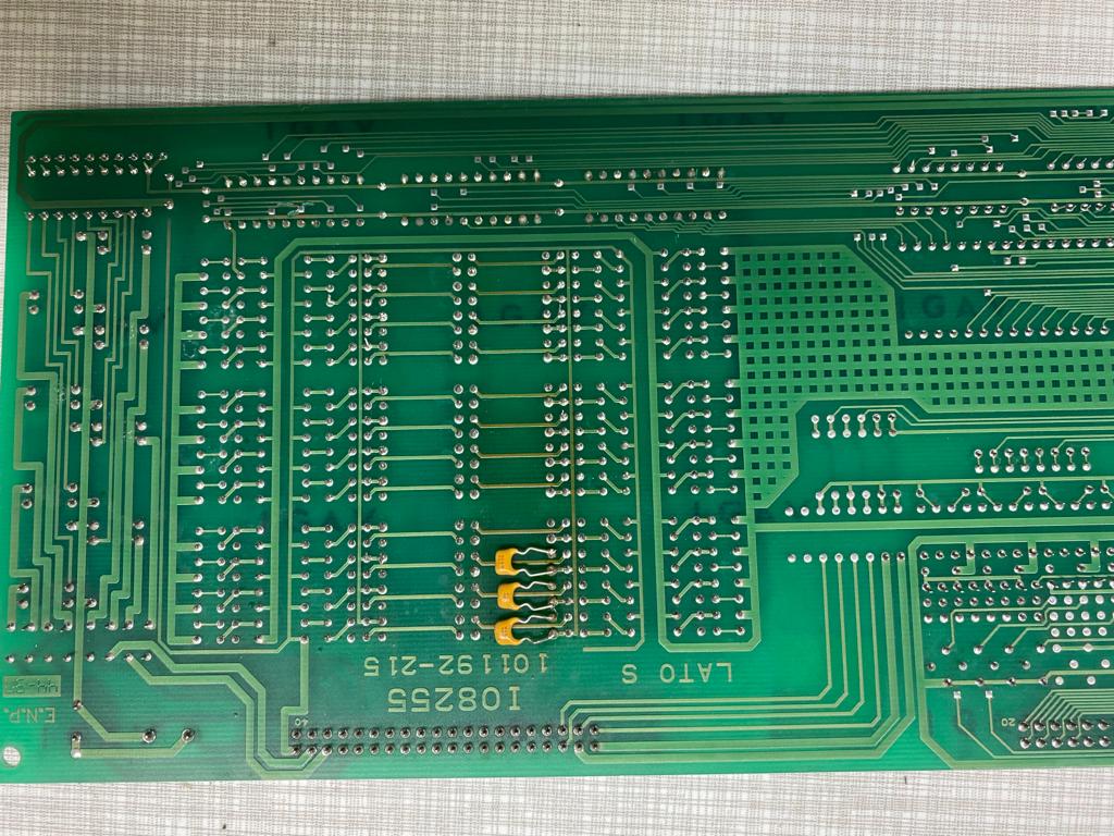

Could you also post a photograph of the back side of that board?
edit:

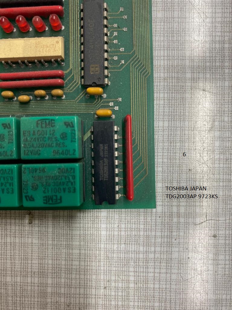

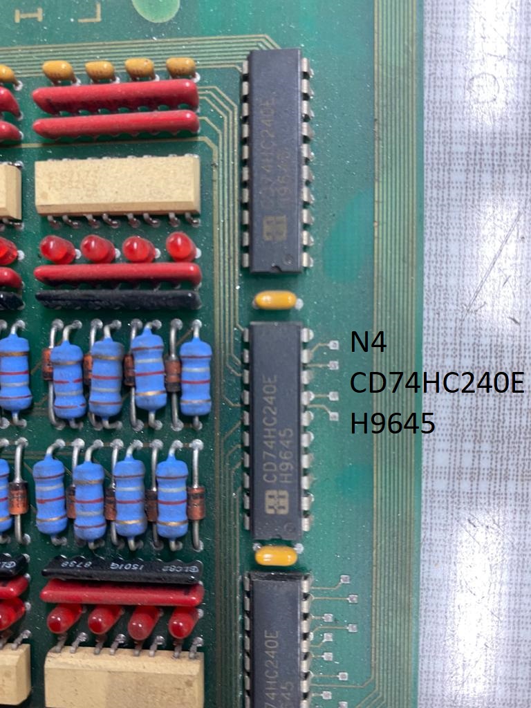

I would venture a guess that (6) is an 2003 / 8 darllington transistors that can switch up to 500mA each.
Also a guess, (4) might be multiplexers?
Yellow 8 (1) and 18 (3) pin thingies are optocouplers for sure.

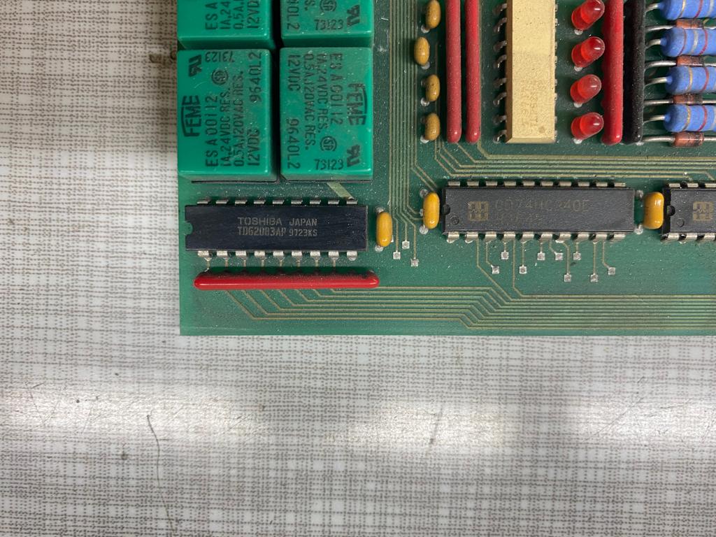

Here are updated photos with component codes, n.2 transistors do not have code number.
There are also photos of the back. How can I proceed now?
I have seen that the shipping times of the adapters with clamps (IDC20-MALE AND IDC40-MALE) are long, should I order them in the meantime?

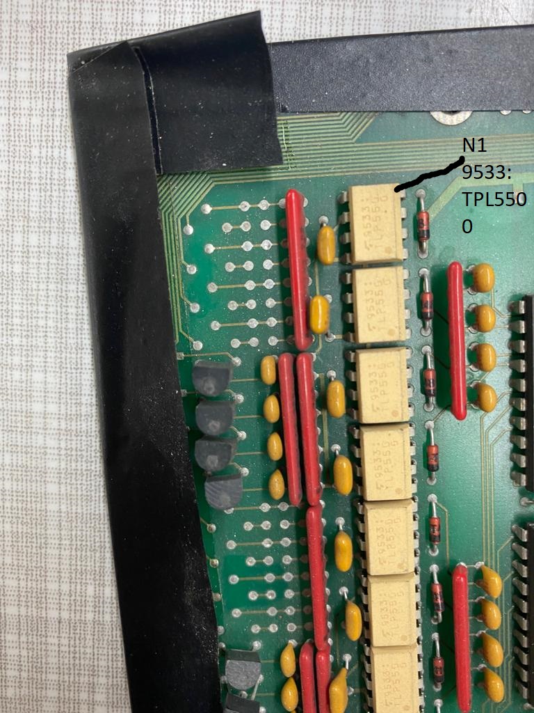

SNx4HC240 Octal Buffers and Line Drivers With 3-State Outputs
The TLP521, TLP521-2 and TLP521-4 series of optically coupled isolator consist of an infrared light emitting diode and an NPN silicon photo transistor in a space efficient Dual In Line Plastic Package.
TOSHIBA Photocoupler IRED & Photo IC
TLP550
Microprocessor System Interfaces
Digital Logic Ground Isolation
Line Receiver
Switching Power Supply Feedback Control
You can find the TLP550 on Ebay.
TLP550
Line Receiver

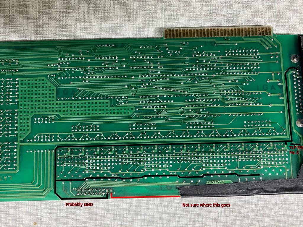

So for the "Output" side it looks like pins 2+12 are Ground and 1+11 likely +5V (not so sure about this because the traces are hidden by the black tape. Check this with the voltmeter you should measure +5V between Pins1+11 and Pins2+12
edit: Note that because of all the isolation through the optocouplers you will need to make sure to connect the Ground lead of the voltmeter to the correct Groundpins. (ie the ground for the 20pin "output" connector is not the same as the ground for the 40pin connector.
edit2: This connector would carry all the signals for the motordrives (enable, direction, step), your job now is to find out which pin carries which signal.
edit3:

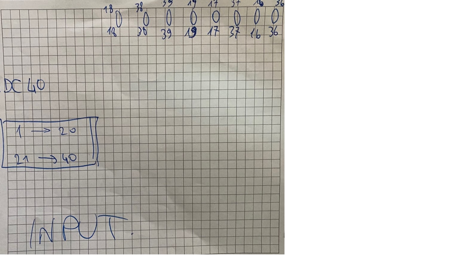

Here my guess for the 40 pin connector:
So to check the voltages here you would want to connect the voltmeter to the "input" Ground (there are two pins on the upper side of the board for ground and supply.
Generally I'm not sure where the power is actually coming from.
If you want you can pull out a driver board and post a picture of the front and back so maybe we can figure out more about the driver signals. Other than that I don't think I can provide more information at the moment. Now it's up to you to find which pin on those two connectors is responsible for what function.
Good luck.
