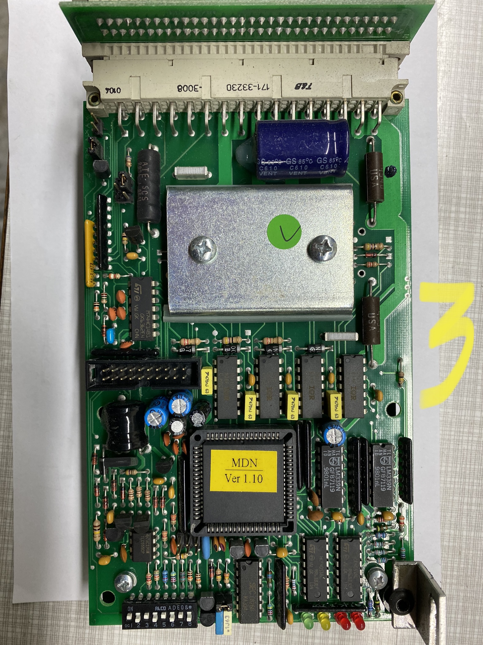

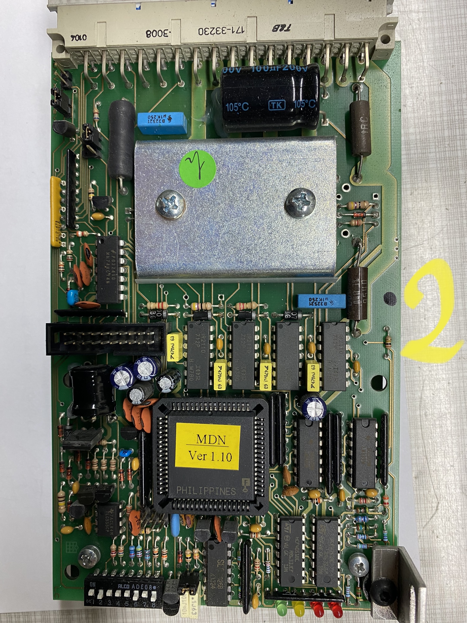

Boards drive

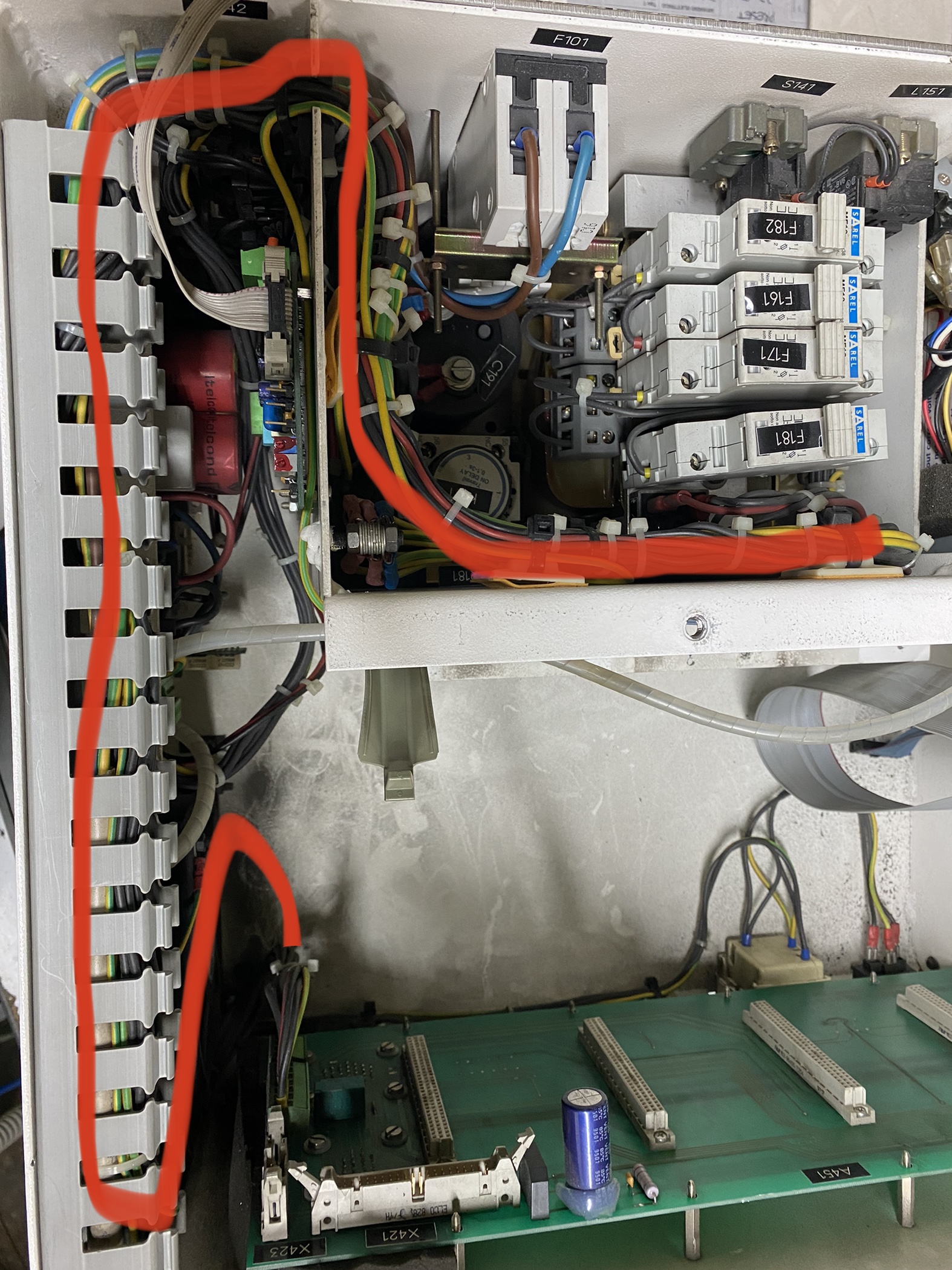

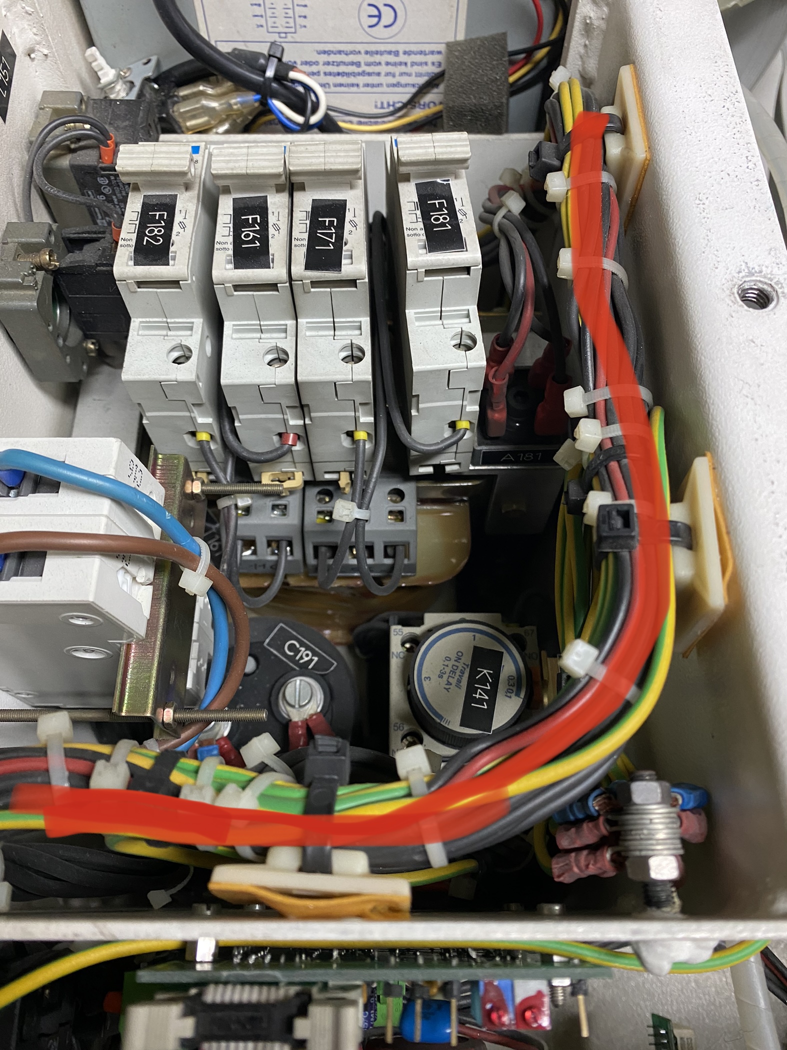

07 Oct 2022 08:10 #253653 by clayd_lopunk
Replied by clayd_lopunk on topic Retrofit cnc 3axis
I checked the relay and inverter cables, the group that I marked in red goes directly to the large board where the drives are connected.
The left button switch cables go through the small board and go to the large board with IDC10, the other switches go through the relays.
I could find continuity between the button that enables the axes and one of the cables that go to the big board, but where can I connect the DVM, the switches are the two behind the 4 relays, S141 is the switch to enable the axes, L151 is a green near light. F101 is the main power switch.
How can I do?
07 Oct 2022 12:41 #253683 by Aciera
Replied by Aciera on topic Retrofit cnc 3axis
Ok, so there is no pin labeling on the drive boards that would have been helpful.
The data in the file ...\MC53\IOPORT.DEF seems to be the port definition for the microcontroller which is also not much help.
What I would do now is follow the individual traces of the two IDC connectors ("Inputs" and "outputs") and see where they go to (ie does the trace go to a drive connector and if so which one) then check if that corresponds to what you already have found (make a list for each connector and it's pins and write down the functions you have found.
As for the spindle I don't really know if there is more to it than turning it on through the pin you have already found and adjusting the speed with the potentiometer on the front panel.
After that I would think the next step would be to wait for the IDC breakout connectors and try out the functions by manipulation of the pins.

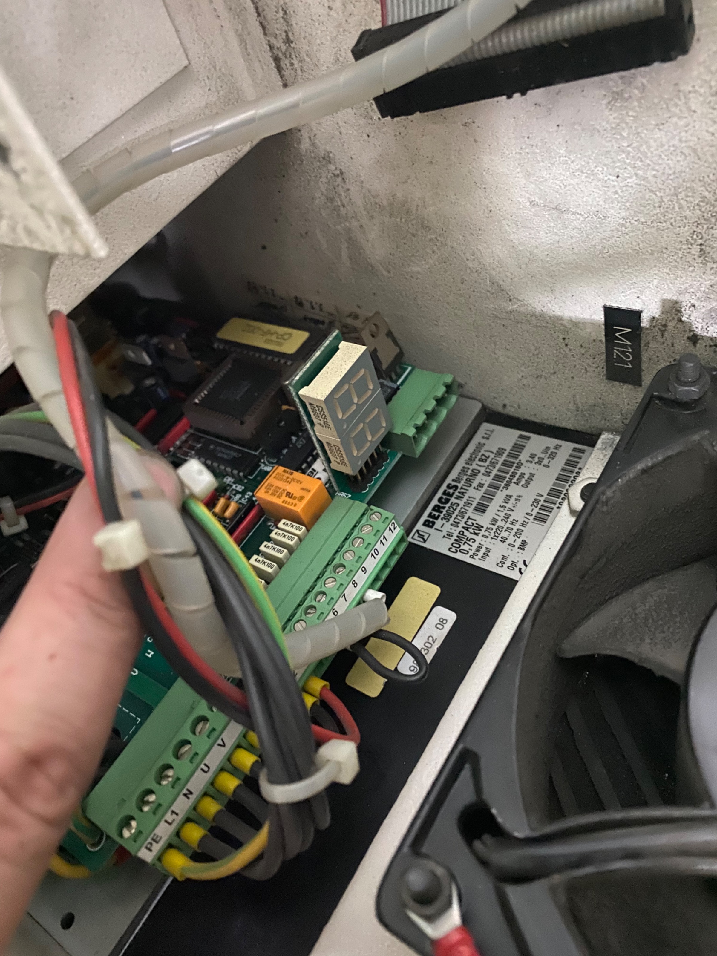

Those two wires (with the spiral wrapping) seem to go to yet another PCB board (no idea what that is for). So you will need to test the functions of the machine and monitor those outputs to try to find out what those two signals are for. Might just be to activate some power supply or maybe a spindle brake (freno mandrino) that is mentioned in several places in the documentation.
Actually I think that PCB board where those two wires in the plastic spiral go to could be the spindle drive. So maybe the two signals are the spindle on/of and the spindle brake.

My oscilloscope has arrived, I got a basic model at an affordable price. How can I use it to understand the operation of the transistors that remain fixed at 12V and of those spiral wires you were saying? It seems that the same pin can rotate the spindle L, and stop it when it is at 12V (H).
Can I connect to the usual processor board directly on the transistor leg and a clamp to ground? (Each connector its own)
