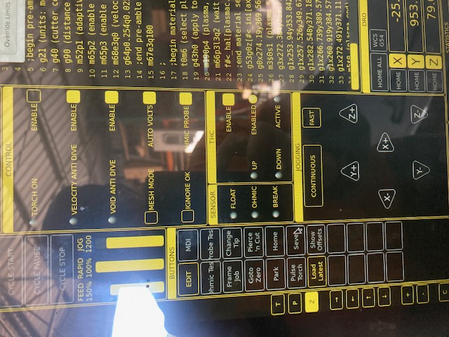

Hi Guys, I introduced myself a while back. I bought the spaceship plasma a while back from rod.. Table has been running well but lately I have been trying to cut some thinner material and I cant seem to get the thc to operate? I have it selected on the main screen but the lead screw for the height of the torch never moves once it has started cutting? Any ideas where to start looking? when I run a cut the active light never comes on.

Feed, you have it set at 150% so it never reaches the feed set in gcode.
Strange, i know, but it has it's reasons.
The long lasting solution is to have the feed rate set in gcode to where you need it and use the feed slider to make minor adjustments.
The short and long term solution is to set the VAD to 60 or 65% in the settings tab/page, default is 90 or 95% and that is way to much for anything useful as it locks the THC at any sign of slow down/speed up. This will also allow you to use the feed rate slider for bigger changes without locking the THC.

Thanks... Unfortunately while trying this I must have accidentally clicked on something?? Table is now going haywire... i turn it all on and try and home all and the torch height goes up and just keeps hitting the bump stop as do x and y.. the whole table is shaking violently. I have literally no idea what happened, I did open a few menus looking for the VAD but I didn't change anything.
