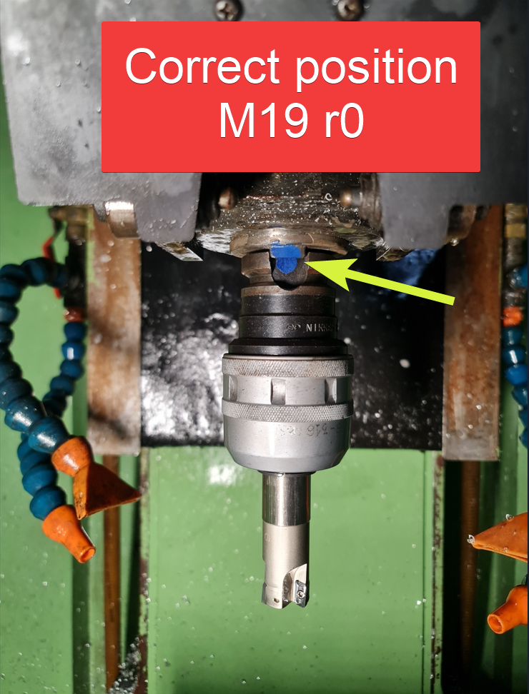

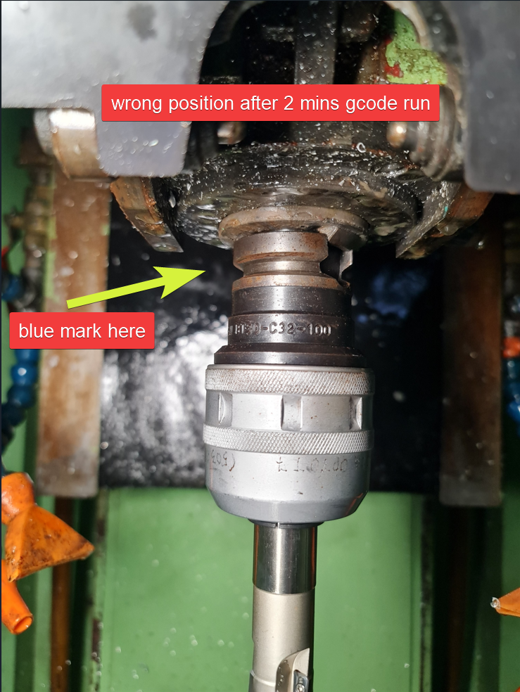

Hi
My Board is 7i96s + 7i77
I use Encoder 05 from 7i77 setup to spindle Encoder
First open linuxcnc program I will m3 s200 for index spindle setup.
I try M19 r0 it's move correct position on my mark Blue color on spindle
then I run file .ngc about 2minuts after gcode run completed I type M19 r0 , it's wrong position
why it's wrong position after run Gcode 2mins ?
I think , how for reset index spindle and I will m3 s200 for get new index spindle before ATC every time ?
or any solution for fix this problem ?

- Posts: 4819
- Thank you received: 2177
21 Sep 2023 07:02 #281297
Replied by Aciera on topic Orientation position problem after run Gcode
Sounds like your spindle orientation is maybe not setup correctly.
For example you have 'orient-mux-or' component in your hal but I don't see the 'orient-mux-or.sel' used in the section you posted. Doesn't necessarily mean it's a problem but might be.

21 Sep 2023 11:26 #281322
by abdulasis12
Today I try to find this problem what or where to error
I try
m3 s1000 5minuts
recheck m19 r0 it's ok
m3 s2000 5 minuts
m3 s3000 3-4 mins
m3 s4000 4mins
m3 s5000 5 mins
m3 s6000 5mins
m3 s7000 5mins
before go next m3 i will M19 r0 for check , result = good
then I try run gcode about 1:30 - 2 mins
when gcode completed I try M19 r0 it's wrong position Orient.
Maybe I think when gcode run servo motor XYZ and motor water pump start too, Maybe noise in to Encoder05 on 7i77 for made it's error tracking ?

Replied by abdulasis12 on topic Orientation position problem after run Gcode
Hi MR.AcieraAh ok, it's actually an or2 component not a mux2 so that is fine then. I haven't gone over your hal in great detail and debugging spindle orientation can be a difficult task. Doing it remotely is very difficult indeed.
So the first thing I would suggest is to thoroughly test the spindle orient functionality by running the spindle and then do an M19 R0 then run the spindle again and do another M19 R0. You want this to work at least a hundred times using different spindle speeds and directions before moving on to other things.Today
I try
m3 s1000 5minuts
m3 s2000 5 minuts
m3 s3000 3-4 mins
m3 s4000 4mins
m3 s5000 5 mins
m3 s6000 5mins
m3 s7000 5mins
Asis,
