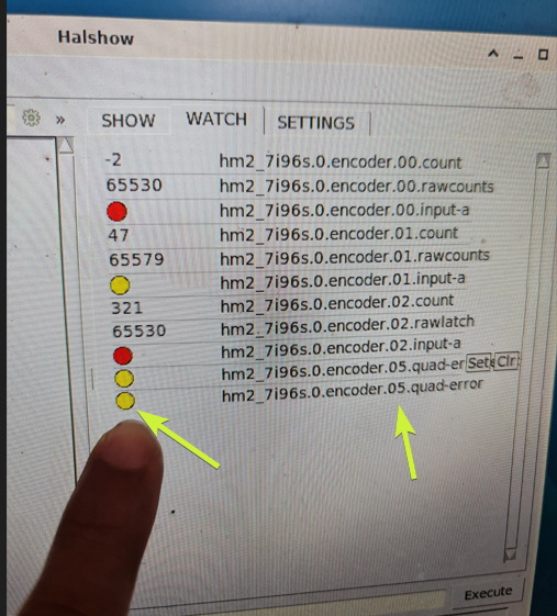

I would set the hm2_7i96s.0 encoder.05.quad-error-enable bit,
do your gcode test and see if hm2_7i96s.encoder.05.quad-error gets set true

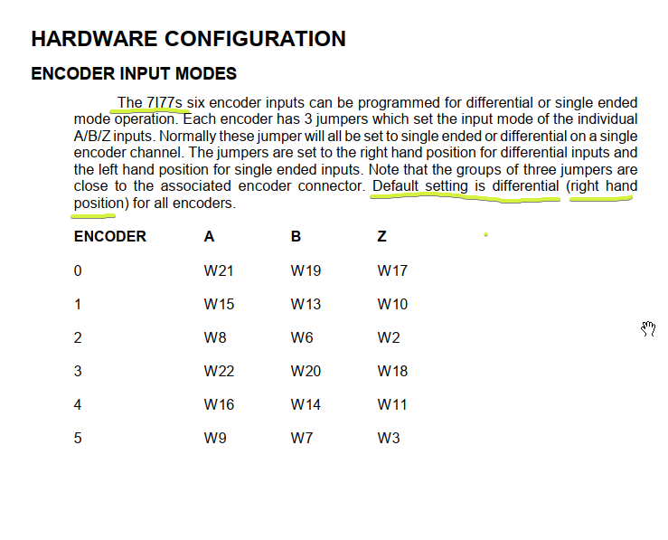

Is the spindle encoder differential?
If so, is the 7I77 set for differential inputs?
Hi MR.PCW
Yes, My spindle Encoder is Differential.
---- If so, is the 7I77 set for differential inputs?
Hmmm, I not sure , How to recheck ?
Now I use Differential Done by default Board.

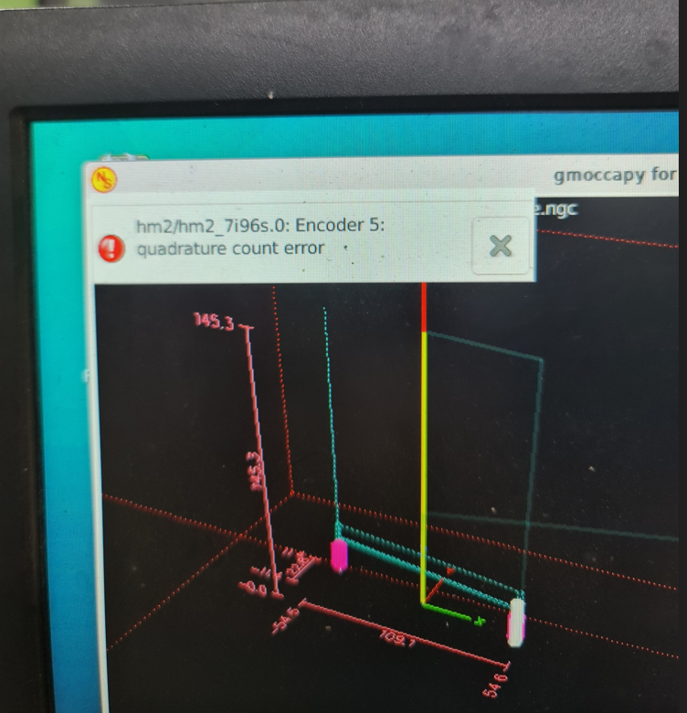

Today I try.......
Change jumper on 7i77 Encoder 05 to quadrature position jump,
In hall I put use setp......... quad-error-enable true,
I test run step-up speed
M3 s200,
s500 ,
s1000
s2000
s3000
before s3000 all run good no show error .
When M3 s3000 it's show "hm2_7i96s.0: Encoder 5 : quadrature count error"
any for me check next step ?
Replied by abdulasis12 on topic Orientation position problem after run Gcode
My spindle type encoder differential signal , I can use function "hm2_7i96s.0 encoder.05.quad-error-enable true" right ?I would set the hm2_7i96s.0 encoder.05.quad-error-enable bit,
Today I try.......
M3 s200,
s500 ,
s1000
s2000
s3000

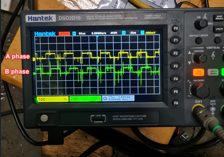

OK I would first verify the you have valid differential signals at the 7I77
You can do this by measuring the differential voltage with a voltmeter
You measure _between_ A and /A and _between_ B and /B
and verify that you have > 2V absolute in each state.
(you need to wiggle the spindle around to get each state)
One state should be >+2V and the other < -2V
(absolute value always greater than 2V)

26 Sep 2023 04:48 #281630
by abdulasis12
I check done , result show below in picture
Asis,
Hi Mr. PCWOK I would first verify the you have valid differential signals at the 7I77

I'd recommend using shielded cables and proper grounding.

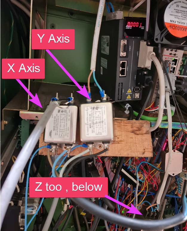

Those are "line filters" so will not help with EMI created inside the machine, they do prevent interference going into or out of the machine through mains power lines.
For you case, ferrite beads or doughnuts on motor wires near the drives should help.
But as noted above by Aciera, shielded cables and proper grounding is essential.
Replied by tommylight on topic Orientation position problem after run Gcode
There is no need for more that one of those for the whole machine if they are rated for more current than the machine can use.Yesterday I try install EMI Filter on Servo Drive X,Y,Z
