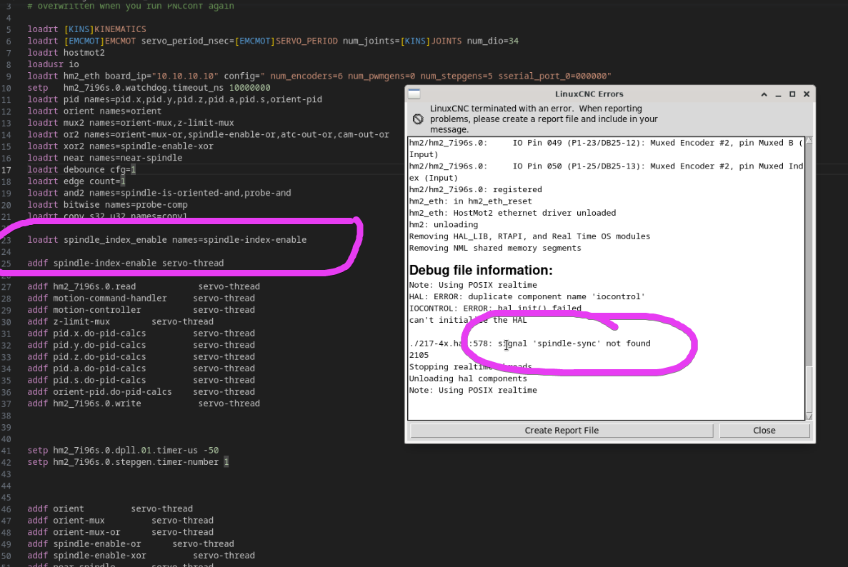

To match my HAL syntax you would load it with "names":
loadrt spindle_index_enable names=spindle-index-enable
addf spindle-index-enable servo-thread

Thank you for info, Now I change back to defferential encoder and I will try check again for voltage.

All done
but just error spindle-sync

To troubleshoot:
Comment out all lines using pins for the component 'spindle_index_enable'.
Leave these two:
Linuxcnc should then start up and you can use 'show halconfiguration' to check if the component is present.
If it is present look at the created pins. If the pin 'spindle-sync' is there then uncomment the hal lines using it and retype the pin names manually as copy/paste sometimes gives the wrong hyphen/minus.
