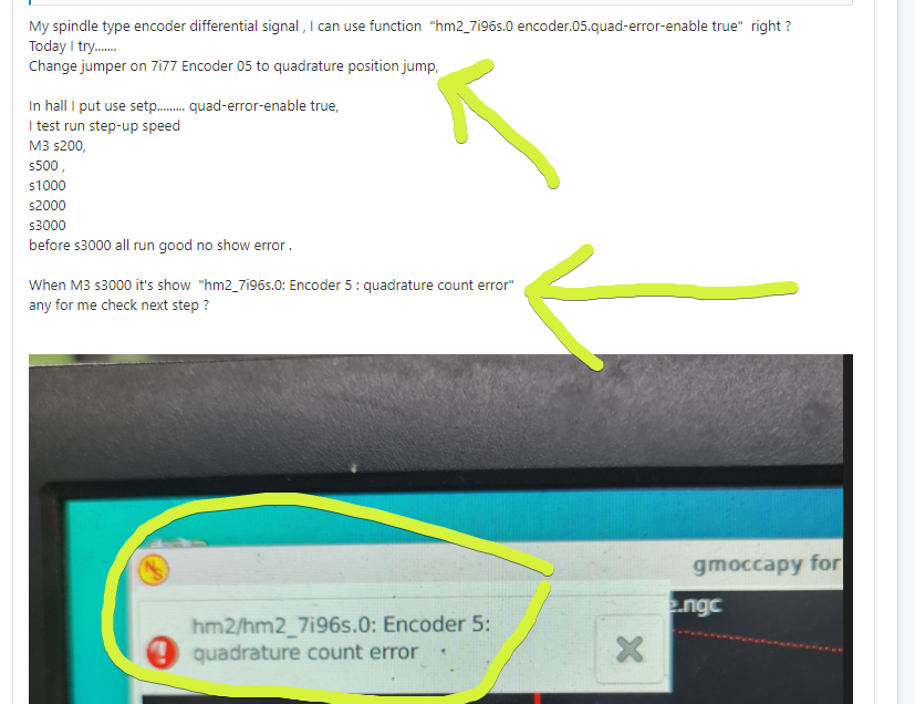

10 rev move with hand and check in hallshow ,The number about 4096*10= 40,960 +- little (with hand stop position)
I try more..
50 rev with hand yes it's 4096*50 = 204,800 +- little (with hand stop position)
I pretty sure my encoder correct on 1024ppr and 4096 per 1revolution.

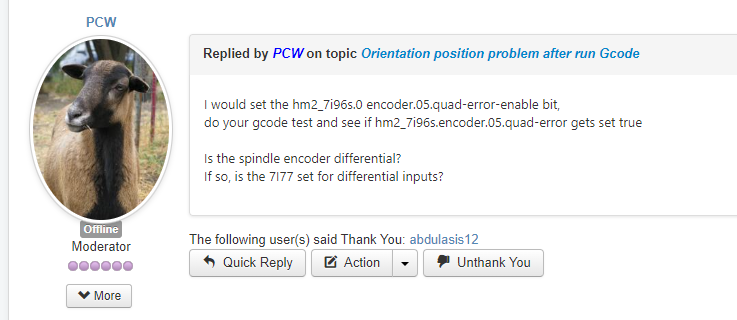

If not, there are two possibilities, scaling is wrong or encoder is faulty/miss wired/not counting properly/does not have quadrature outputs/voltage to low/ outputs not able to swing high enough to register/
I ever try change jumper from differential to quadrature and use this solution from MR.PCW
Result is
When M3 s3000 it's show "hm2_7i96s.0: Encoder 5 : quadrature count error"

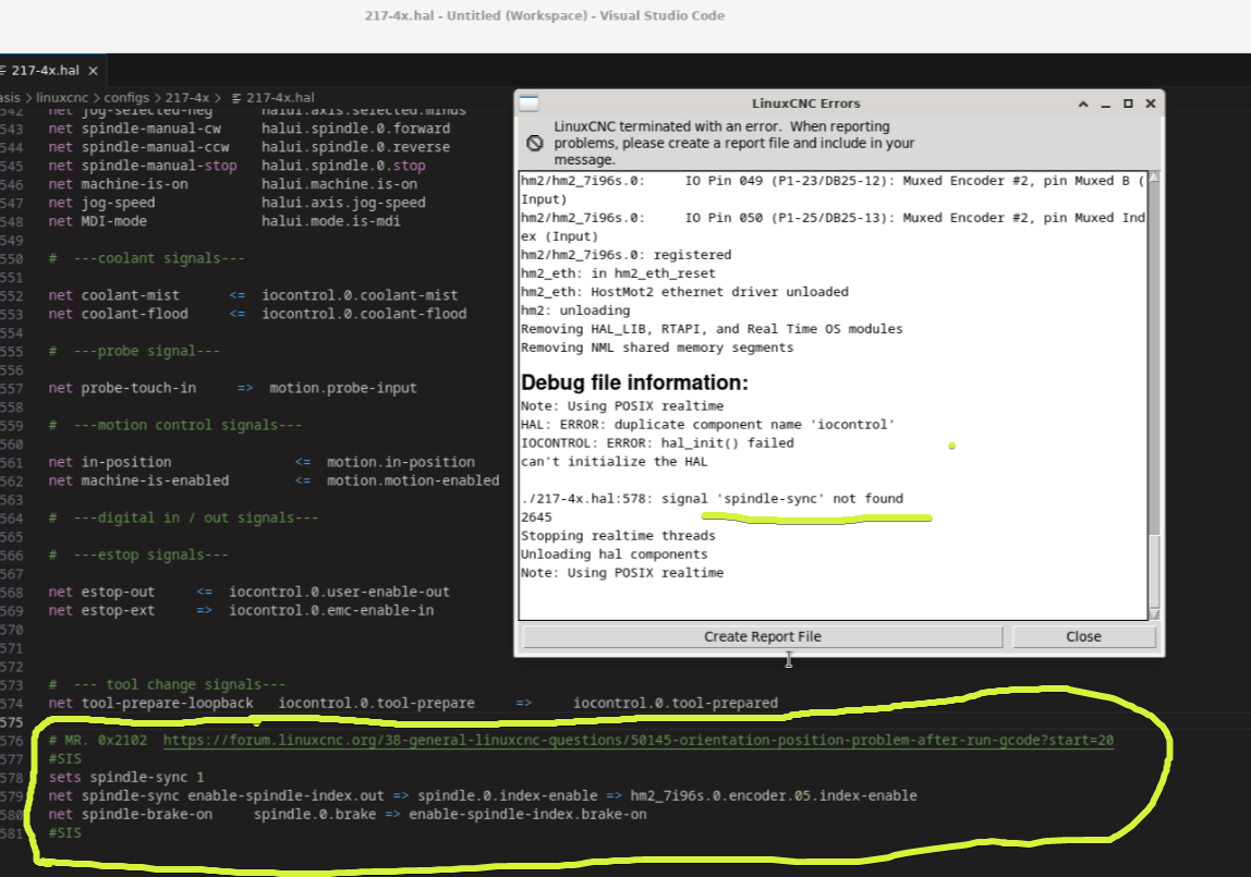

Hi MR. 0x2102
I think I will try your solution, Now I have a problem .
I put your hall and change to my hm2
sets spindle-sync 1
net spindle-sync enable-spindle-index.out => spindle.0.index-enable => hm2_7i96s.0.encoder.05.index-enable
net spindle-brake-on spindle.0.brake => enable-spindle-index.brake-on
Save and run linuxcnc, Show error signal 'spindle-syn not found '
Please give me some advice.

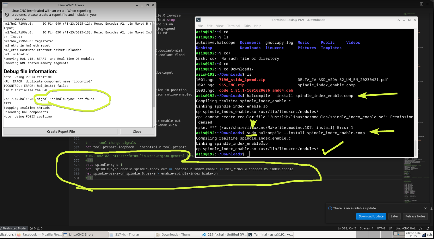

1. Have you installed the component?
$ sudo halcompile --install spindle_index_enable.comp
(don't use 'sudo' if you are on a rip installation ie if you have compiled linuxcnc on your computer)
2. There also is another error 'duplicate component name iocontrol' not sure where that comes from.

04 Oct 2023 00:00 #282246
by abdulasis12
Now I install sudo halcompile --install spindle_index_enable.comp Done (must sudo can work).
Now wait MR. 0x2102 for advice about signal 'spindle-syn not found '

Also, don't forget to 'loadrt ... ' and 'addf ...' the new component in your hal file.

I think you would need (note the '.0' in the addf line):
loadrt spindle_index_enable
addf spindle_index_enable.0 servo-thread
