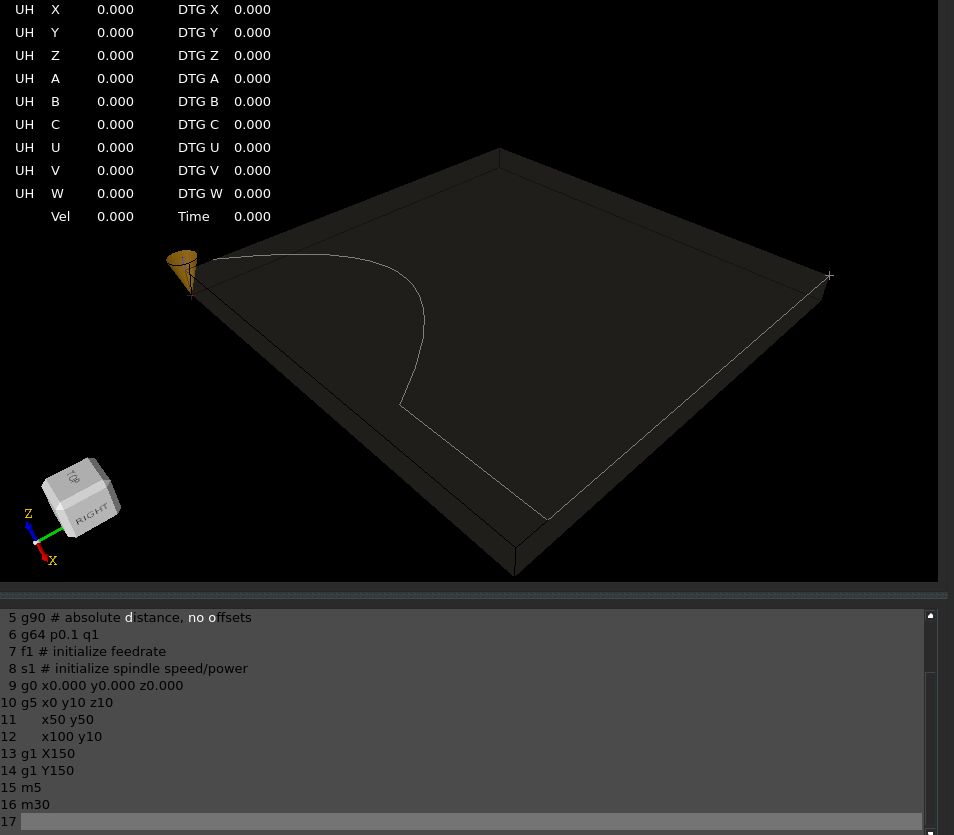

15 Jul 2024 15:00 - 15 Jul 2024 15:03 #305236 by Grotius
Replied by Grotius on topic Trajectory Planner using Ruckig Lib
Today i was creating the G5 for spline.
Here it tells us to use incremental offset's for i,j in g17 plane. It seems to lcnc uses a 2d spline.
g5 linuxcnc
Then i thought why not use absolute point values for a spline?
Here is my proposal to use a spline in gcode.
It start with a G5. Then every line has a x,y,z point, until another gcode appears.
And the result :
Last edit: 15 Jul 2024 15:03 by Grotius.
The following user(s) said Thank You: Lcvette, Darium
15 Jul 2024 15:52 #305246 by Aciera
Replied by Aciera on topic Trajectory Planner using Ruckig Lib
You probably know how it is with GCode and Splines. Decades ago, when memory was expensive, they were interesting because they reduce file size (as do arcs). As discussed a few pages back on this thread, modern multiaxis CAM/ Postprocessors produce G1 line segments only, they don't even bother with G2/G3 arcs (R vs IJK, Absolute vs Relative). Since processing power and memory have become so cheap the interest in splines has all but disappeared. That is why nobody really uses them. If you asked somebody to create a postprocessor that uses splines, I guarantee the question would be: WHY?
So, unless you have found a new and compelling reason for using splines instead of lines (and arcs) you are flogging a dead horse.
The following user(s) said Thank You: Lcvette, Grotius
15 Jul 2024 17:49 #305255 by Grotius
Hi Arciera,
That's the case. Flogging a dead horse.
I also never used splines in gcode.
However we need a 4pnt spline to do the exotic path blending fillets where the clothoids are out of plane, or invalid.
Integrating the spline is not that much work.
The following user(s) said Thank You: Aciera, Darium
15 Jul 2024 18:14 #305257 by Aciera
That is what I suspected. I don't think there would be many objections to modifying spline syntax if it helped getting jolt limiting path blending for multi axis gcode working.
I'm afraid I can't help you with implementing the linked 3d clothoid algorithm.
