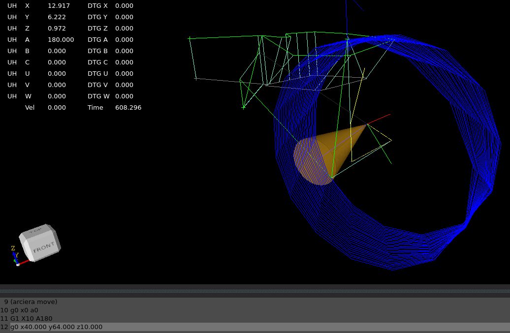

We where wrong about connecting the ta knots with lines.
Yes, it's kind of obvious now that I see it:
If we are at X0 A0 and we have a move G1 X10 A180 then the connecting orientation line will actually intersect the toolpath.  l didn't think of that.
I think we need to create the recordedb blue toolpath before program starts. Then create the fillets, like
sketched in the image.
I agree.
But i think it's stupid to use no G2, G3 in 5 axis machine code.
Well, it can't be that stupid if the big players do it that way.

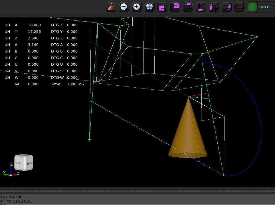

06 Jul 2024 15:02 - 06 Jul 2024 15:05 #304544 by Grotius
Replied by Grotius on topic Trajectory Planner using Ruckig Lib
If i add your move to the gcode.
Then we turn 180 radians.
When we turn pi radians, 180 degrees this happens :
Now the program loads showing the actual tool dir path.
This tool dir path is calculated at program load at the user side. Kernel isn't aware of this.
The toolpath segments are off type 3d_polyline. This is like a linestrip.
This looks like a nice basis to create fillets for both the tcp path & tooldir path.
Last edit: 06 Jul 2024 15:05 by Grotius.
The following user(s) said Thank You: tommylight, Lcvette, Aciera, Darium

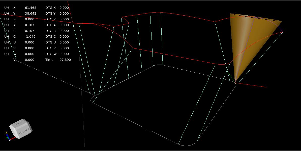

06 Jul 2024 15:54 #304549 by Aciera
Replied by Aciera on topic Trajectory Planner using Ruckig Lib
I agree.
The following user(s) said Thank You: Lcvette, Grotius, Darium

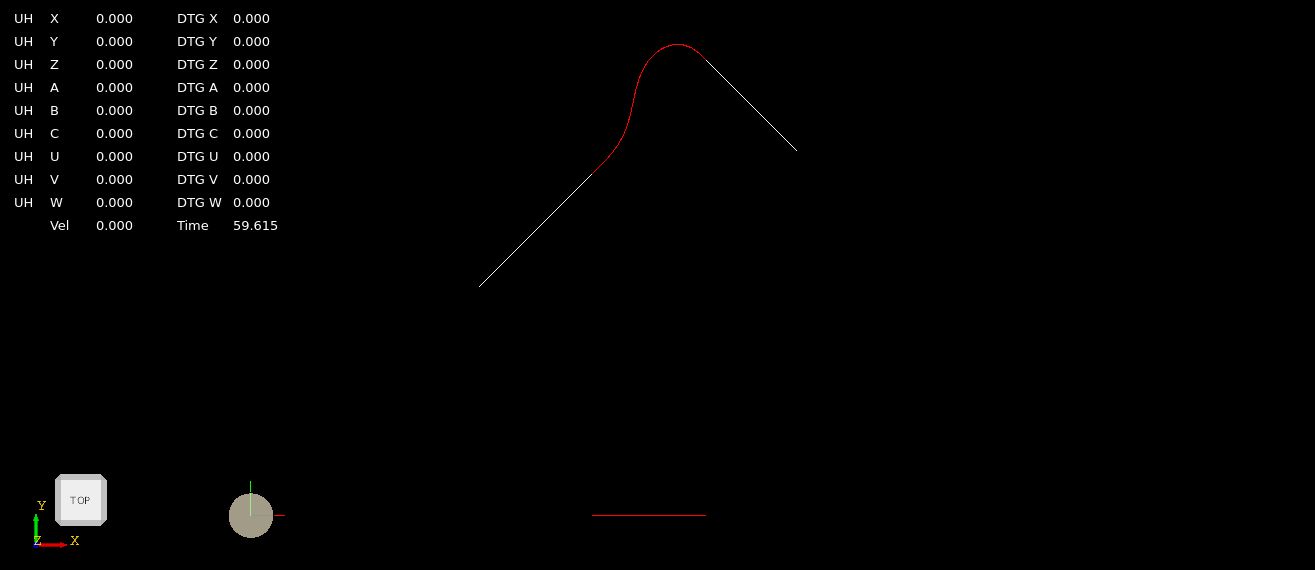

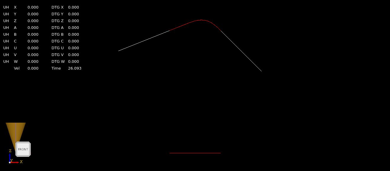

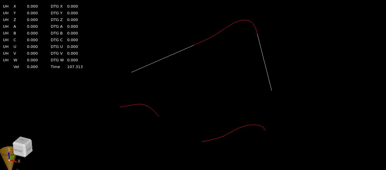

07 Jul 2024 12:17 #304577 by Grotius
@Arciera,
On the picture we have a big problem, the 2 thick blue lines, these segments are connected non-planar.
The clothoids library works for connecting segments that can create a plane.
This situation can not create a plane, or at least the 2 connected segments are not on the same plane.
In a quite moment i thought about this problem yesterday.
The clothoids are valid as they can be on a 3d plane.
So this is not valid to construct a clothoid fillet. How to go on?
What we acutally needed is a 3d spline or a 3d clothoid wich is valid non planar.
For the 3d spline, this can be a problem if you have 30+ waypoints. Spline with 30 degree or more are in my view useless and
often they break on the algo.
So my solution was to think about a 3d clothoid creation wich is valid non planar.
The idea i got was to construct & project 2 clothoids each on a plane.
First clothoid projects on the xy plane, given the 2 3d lines. This one don't use the z component.
Second clothoid projects on the xz plane, given the 2 3d lines. This one don't use the y component.
Then interpolate the first clothoid in time from t=0-1.
Then for the t, find the x value of the second clothoid, then use the z value as solution for the interpolated point.
Here is a video how it works :
Now one thing to do is when the first clothoid has no x value, but has y value, use this then.
What do you think about the result?

07 Jul 2024 18:47 #304591 by Grotius
@Hi arciera,
That's not difficult to do, opencascade is good in vectors, planes, etc.
But then still if a or b rotates below the workpiece in one gcode line, we are lost.
The 3d clothoid works, but output is not alway's valid. So i have to review my approach.
Sheisse.
