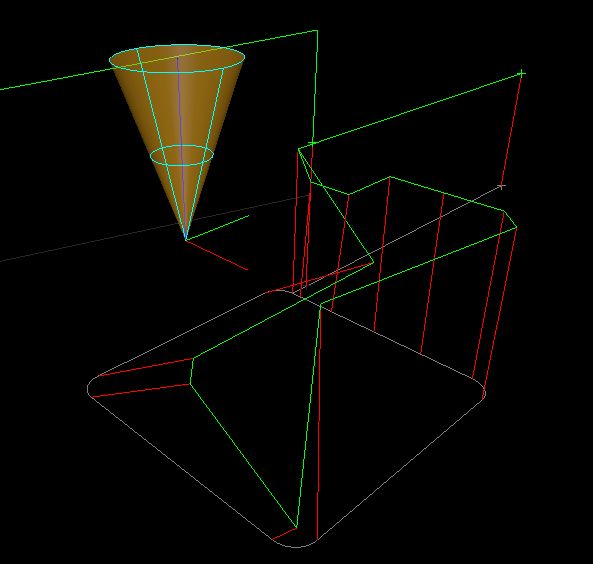

@Hi,
I just made a test for 5 axis. xyz abc.
Where a rotates around x, b rotates around y. The c axis is the cone symetric axis, like spindle orientation.
The tool direction line is 15mm of lenght.

nice!
I like the added preview of the tool orientation.

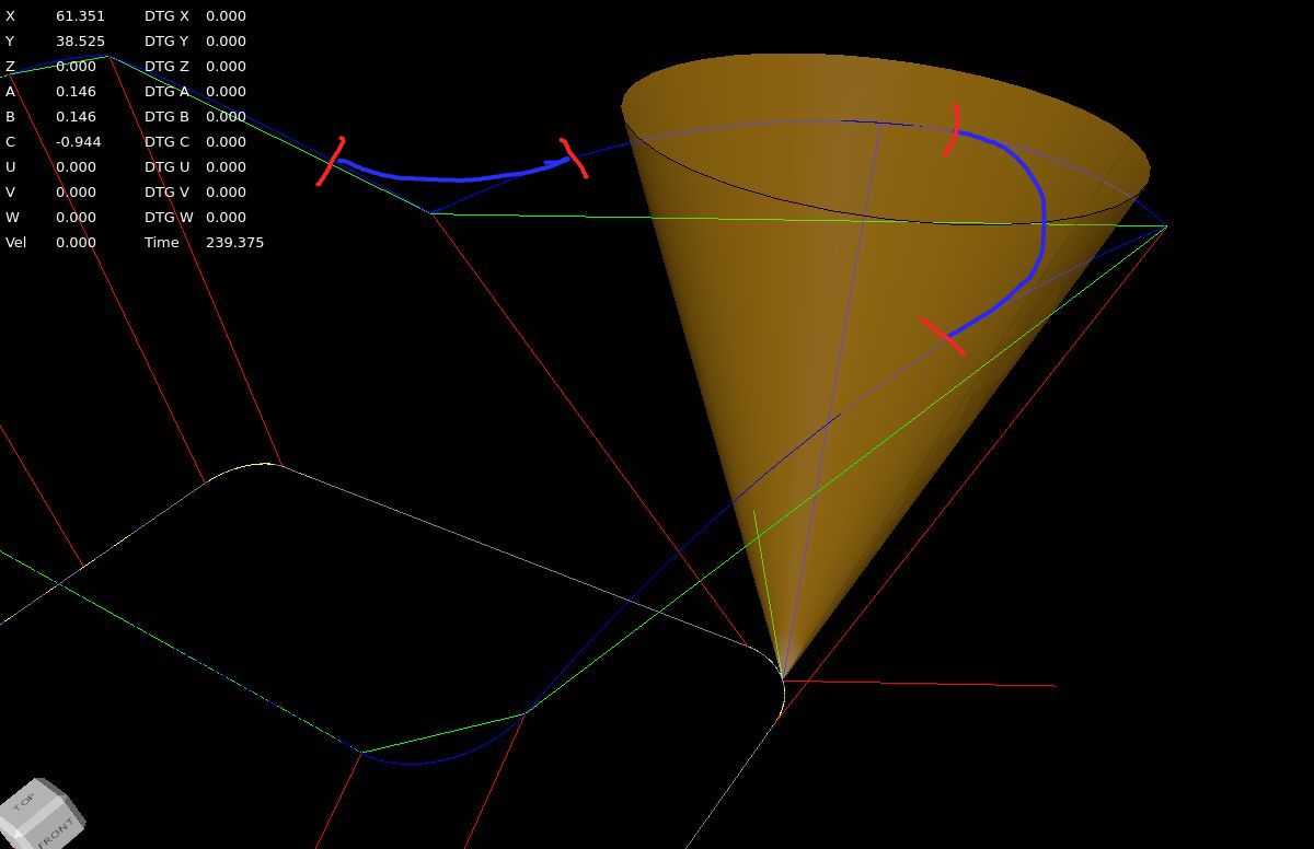

We where wrong about connecting the ta knots with lines.
Proposing connect ta (tool dir points) knots with lines. :
The thin blue line is the recorded tooldir path:
I think we need to create the recordedb blue toolpath before program starts. Then create the fillets, like
sketched in the image.
This example uses gcode with no G64 fillets so far. This is just a example howto get where we want to.
Short movie how to tool tp and tool dir are recorded.
I will now try to create an idea to add clothoid fillets to the tool tp path and tool dir path.
