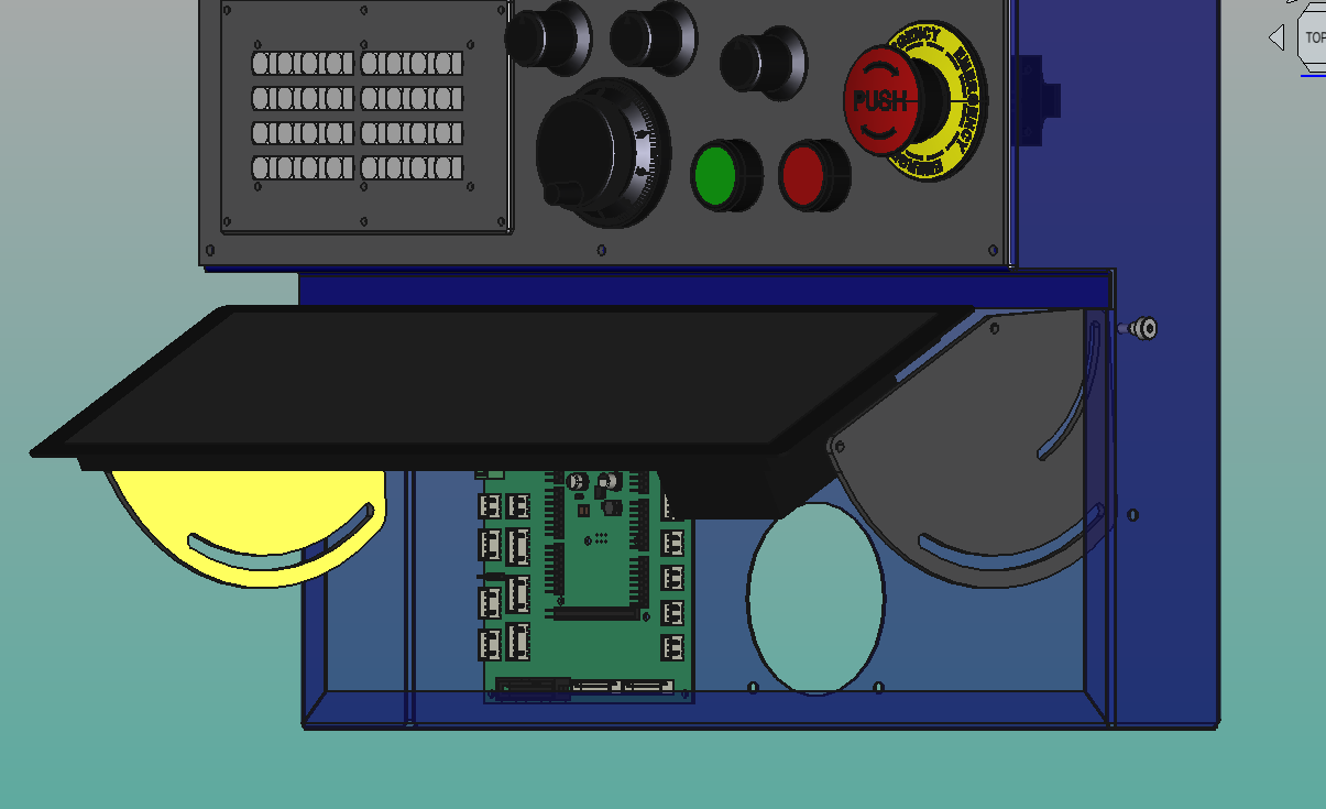

What about the big gaping hole? Just wall it off and lose whatever space is behind it?
I plan to stick a PCB in there, that's not really a good look when the keyboard is open. Even still why wouldn't I just use the rotating hinge I have now? If I wanted to do that I'd just make the overall shape more circular, like a hook to take up less space.......

Does the keyboard need to be visible when ”closed”? I mean I assume its quite akward to use in the closed position.
So of it can be hidden, I would do a simple hinge in the bottom and then put a couple magnets on the top to ”lock” it closed.
I'm pretty sure that was one of the primary design intents.  Keyboard will be primarily used in the vertical position, and is tiltable for those infrequent longer typing sessions.
Yes, keyboards are awkward to use when they're vertical, but when operating a CNC machine you generally arent typing a bunch.
I didn't notice that you were planning to use the space behind the keyboard; I thought all the components were up in the 'main' section and the keyboard area was essentially dead space.
And no, it's not a great idea to have a PCB open to the elements.  You'd ned to build an internal bulkhead... defeating my 'less work' argument.
As far as the hinge goes, Rotating the keyboard up (top hinges) may put it at a somewhat uncomfortable distance (i.e. too close) to the monitor.  The hinges I suggested, while admittedly fiddly, drop the keyboard down a bit when open.
Have you made a cardboard yet mockup to see if you like the geometry & layout?

Well yeah it's probably like typing at an ATM, but I don't think I've ever seen a commercial machine you want to type at.....
.....But you also want to be able to push some keys without having to open or adjust anything. LinuxCNC requires a bit more interaction than any commercial machine so I was originally set on the hard 20deg angle. The tilt thing got mentioned a couple of times so I warmed up to it a bit but I'm not looking to compromise on it too much. An industrial keyboard isn't a very enjoyable thing to use no matter what so I  don't wanna get too far out into the weeds.
I probably can fit everything in the top but having that access panel behind the keyboard makes it easier to get at the Arduino/Mesa whatever without removing the upper panel so it's a good place for it. It's not a large enclosure so it's good to be able to use all the space available.
spumco post=291111 userid=28776
Looks pretty good even at full extension. Peg on the jog wheel might be a bit close to the number keys at the top of the keyboard if it's at 6 o'clock but ya can't win em all.
The layout of the upper panel might change so I'll probably just have you plasma the outline and touchscreen hole. I can run all the lower cutouts on my CNC mill. It's not for ergonomics, as long as I can push the buttons I'm happy. It's more for things you can't really replicate with a piece of cardboard......
If you look at the Haas controller, it's mounted on the left and can pivot towards the opening of the machines enclosure. That's how I use the touchscreen on my mill now. I don't like messing with pendants so I just swing the touchscreen towards the opening. If you have to smack the Estop the way I have it, you'll wind up pushing the control out of the way. Makes a bit more sense to move that stuff to the left for that type of mounting, it's easier to reach anyway.
So yeah, I might just mill the control portion of the lower panel "on demand" so I can change it as necessary and only deal with upper panels. There's nothing else I really can or want to change, I'm happy with the package as a whole.

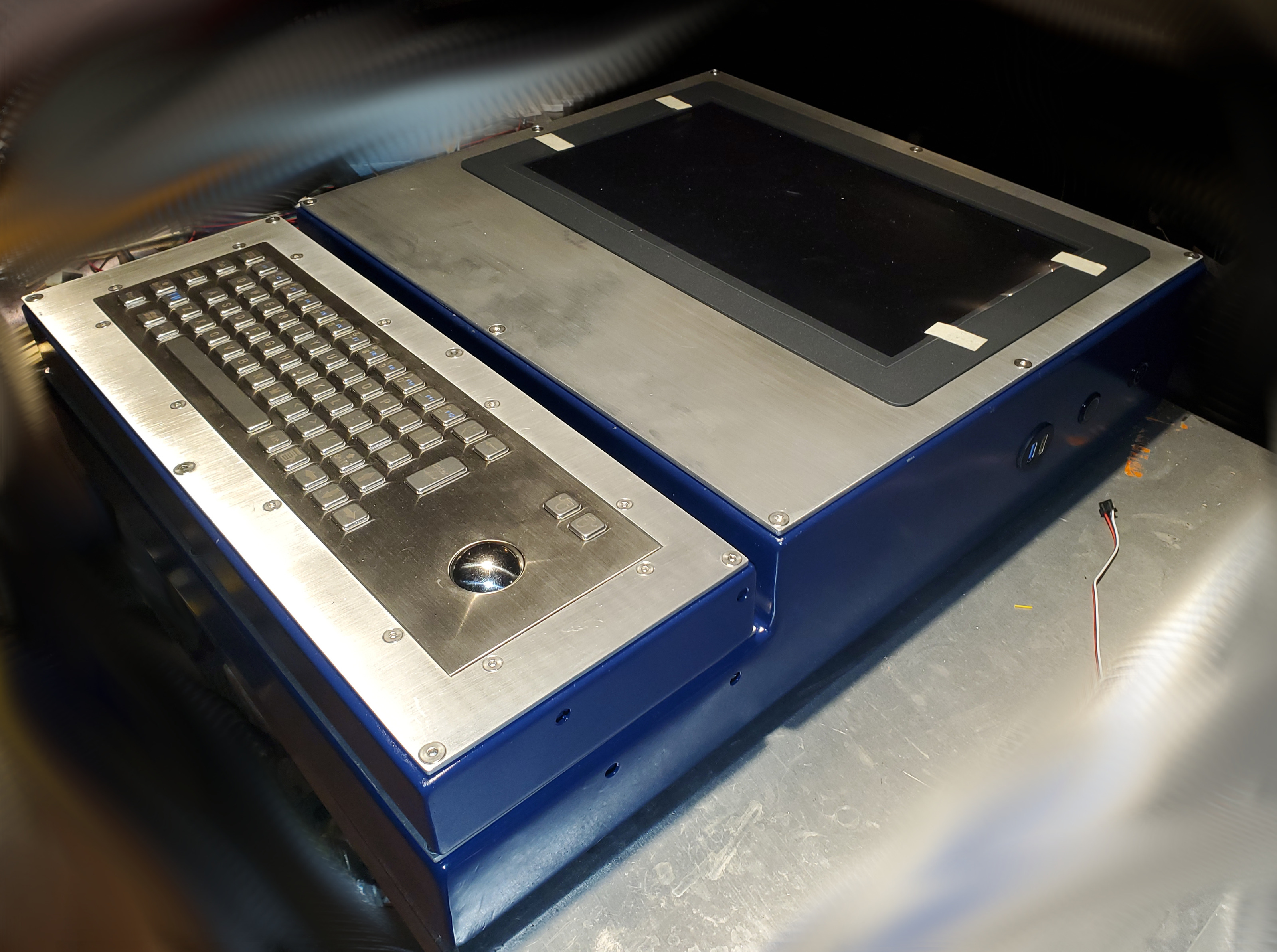

09 Feb 2024 05:18 #292911 by blazini36
Replied by blazini36 on topic Control panel hardware buttons
It's (almost) alive...
