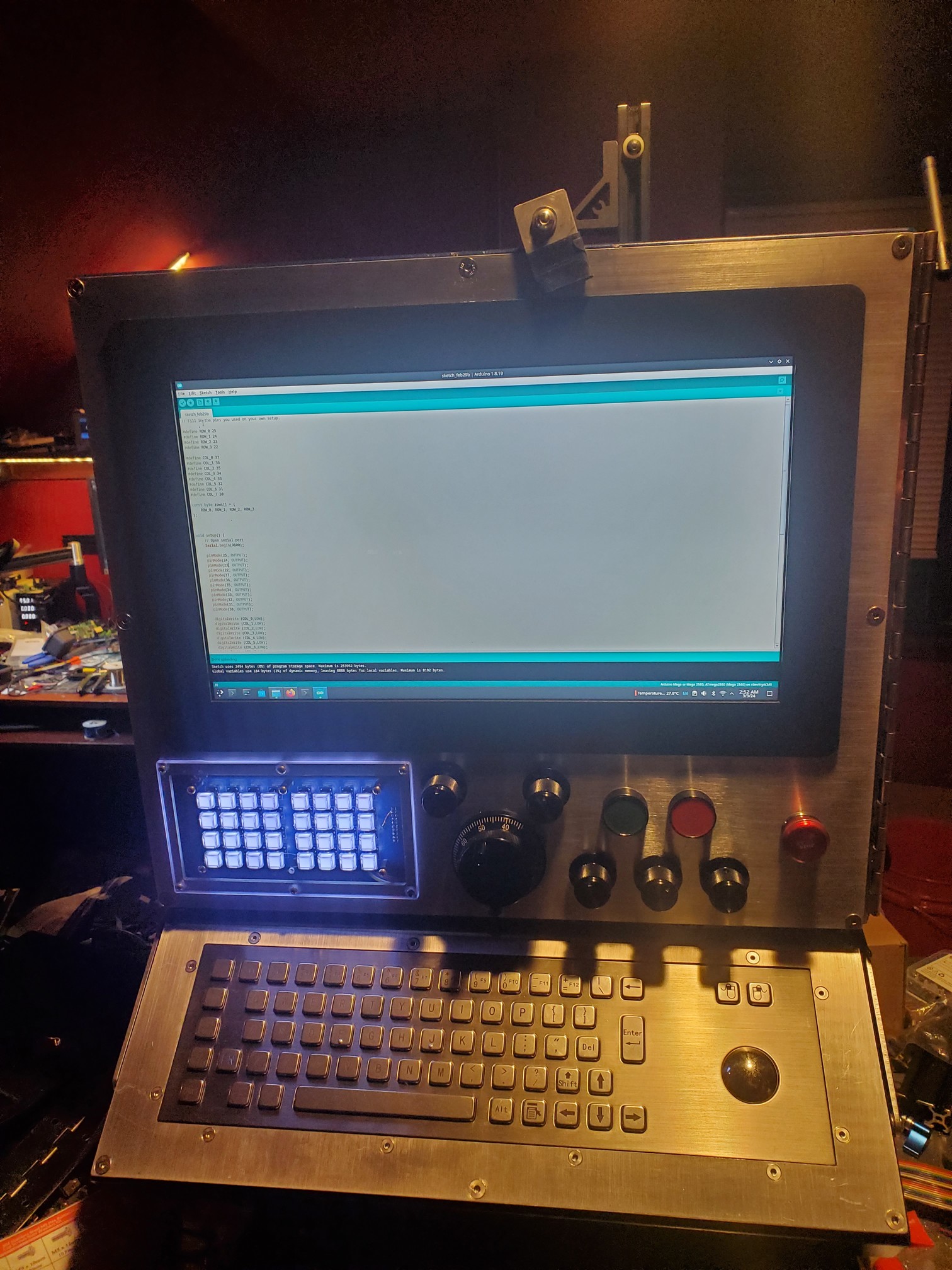

OK so it looks like I'm bringing this thread back to the original question if anybody's still with me, I'll make a new thread to show-and tell.....
I made a matrix key panel, it turned out fairly well but it's too costly to make with the lighted tactile pushbuttons.......
The clear acrylic is just temporary since I had it on hand.
I'm thinking of making these from a conductive rubber pad as I can still backlight them but I can't get keycaps for those for a reasonable price so the universal label Idea is kind of shot. I can have the rubber printed though so I need to have a layout ahead of time......
I'm used to just using a touchscreen so I have no idea what would make sense to put on these buttons if I have them printed so that's where I'm looking for suggestions on that 32 key matrix. I already have axis select, incriment, run, stop, rapid OR, feedrate OR, and spindle OR as hard buttons. I'm also thinking about doing a panel with 16 keys and a joystick so I'm looking for layout suggestions for a 16 and 32 key pad keeping in mind the buttons I already have plus the fact that the monitor is a touchscreen. The panel is easily replaceable so it's not set in stone, just want to get an initial printing that makes sense.

I wonder if you couldn't use a membrane keyboard with an adhesive printed overlay? might help get the cost down.

The purpose of these buttons was I wanted to just print clear labels from a Dymo and stick them under the clear keycaps. I can do that with these, they're just a bit more difficult to deal with than I like
I just heard back from the place that makes the rubber membranes, the membranes themselves are cheap if using the standard off the shelf ones but I'd have to pay $250 for a printing plate to get the rubber keys printed on. Probably going to pass on that idea for now. Maybe I'll stick with these buttons, they aren't that expensive now that I look at the order. It's just a bit harder to make this keypad than I like.

I think the correct term I should have used is a tactile switch array.
Something like udvabony.com/product/tactile-switch-4x4-...-16-keypad-keyboard/
You could also build this yourself. You may need to cut a grid of holes in your enclosure.
Then in CAD, design the adhesive overlay that is applied over the buttons. (Don't forget to include Mr Chips!)
Discuss the available substrates to print on with your local digital printer.
I have some permanent adhesive polyester roll fed barcode labels that I can print on with a Zebra barcode printer using a permanaent ribbon.
The stuff is thin, flexible and indestructable. I use it for compliance labels for automotive products. There will be something similar in the signage industry.
You do see what I am suggesting used a lot on electronic products.

What you're actually suggesting is what mechanix suggested earlier in the thread, a dome switch keypad. That is what is used with the plastic overlay you see in many industial applications. They don't use tactile switches, they use domes. Again the problem is A) cost andI think the correct term I should have used is a tactile switch array.
