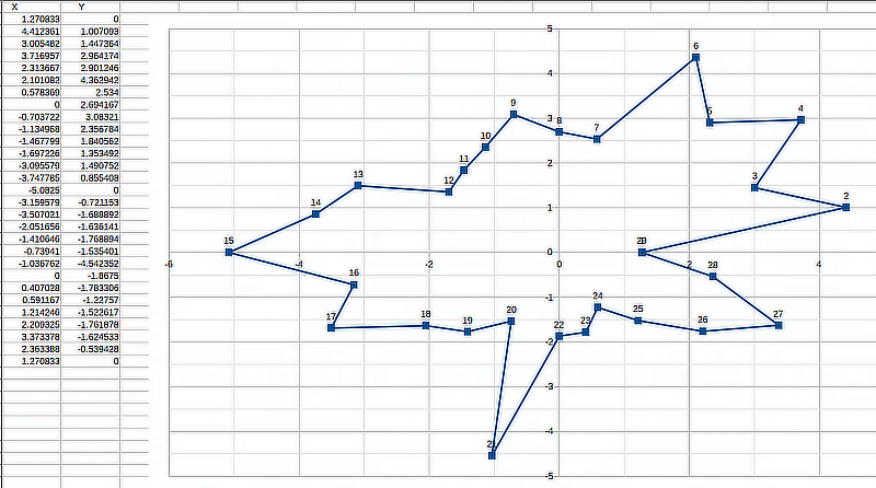

... To compare the performance of the resistance interface board (and the probe) with my previous 'straight switching' setup, I'd like to automate the creation of plots like
these
by Alex Lait (@ZincBoy). The automation is required because (once I get the PCBs back), I will be 'tuning' some of the resistor switching values - so lots of rinse & repeat...

For my probe calibration, i use only 4 quadrants, it's enough. Just to see how the homemade probes behave, i have this routine. First setup calibration ring with dial gauge, set X0 Y0. Some settings can be done in the file, also the path for the logfile. The Logfile is overwritten at programstart. Make a copy first, or change LOGOPEN to LOGAPPEND. It contains tab-separated xy results. The first result is also append last, for close the line in calc. The probe tip is compensated from tooltable. In Calc, i made xy-lines diagram. Once its there,just need to replace Data. Its so simple, not much to say.

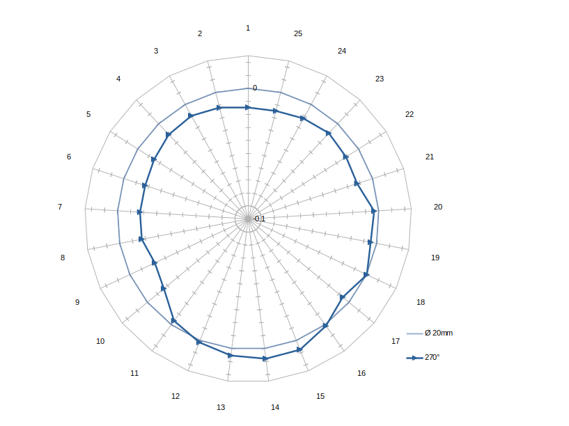

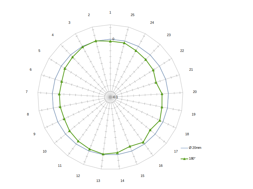

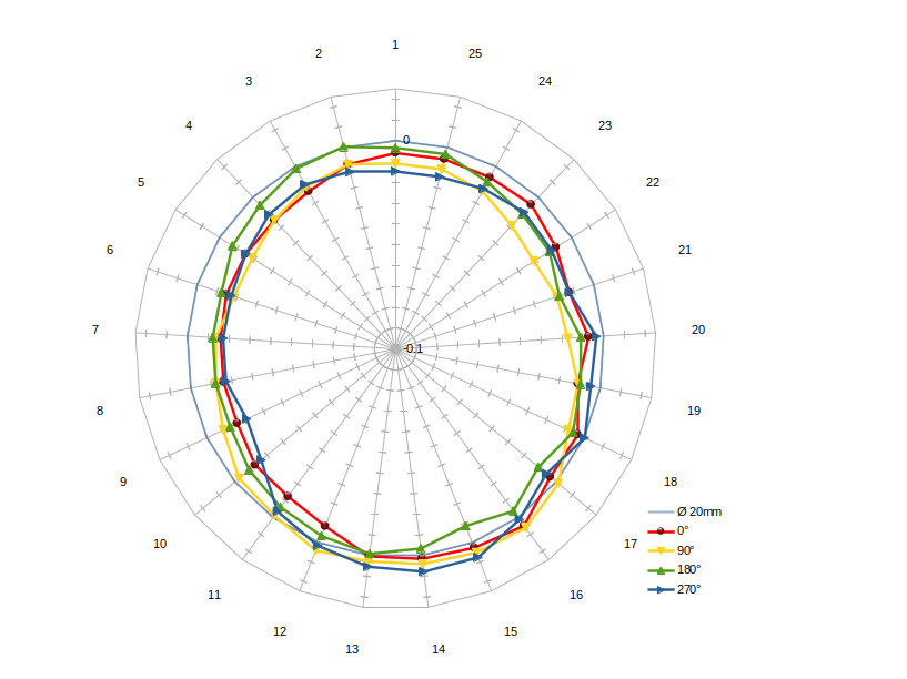

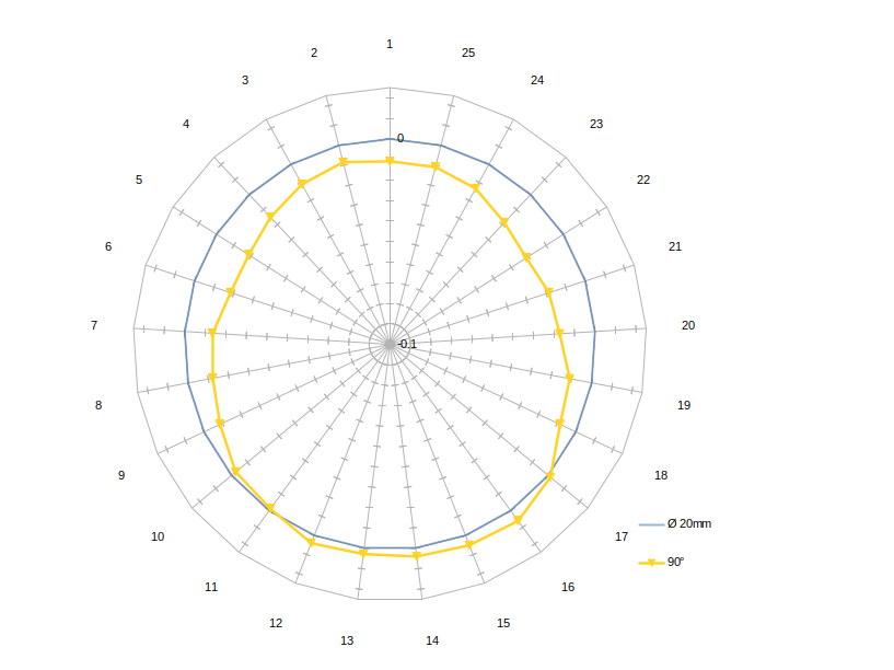

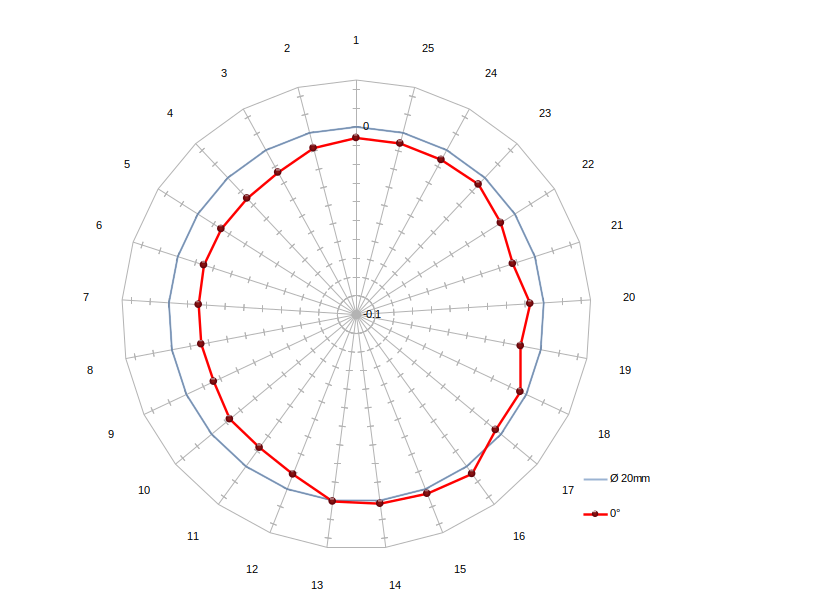

19 Feb 2024 06:31 - 19 Feb 2024 06:42 #293756
by fletch
Replied by fletch on topic Probe Calibration Plots
Well, we have pretty pictures. Do they mean anything? Probably not but the consistency from the
Mostly Printed Probe
is fascinating. Yes, I'm using backlash compensation. Yes, my machine is probably only accurate to 0.05mm (but repeatable to less) - so how on earth am I so consistently measuring my 20mm calibration ring? With a 3D printed probe! It does help that the stylus is very short and the probe's contacts are fairly wide, but still... Answers on a postcard or sealed down envelope, please!
This is a 'net' chart (LibreOffice's equivalent to a polar chart, I think) - I modified Markus' .ngc to report polar distance and to return to the centre each time to try to mitigate the backlash compensation. Probing speed was 75mm/min.
The concentric markings on the chart are 0.01mm - my measurement of the ruby ball on the stylus is probably a little off as I'm fairly consistently measuring under size.
My methodology was pretty crude as I was more trying to make LibreOffice do it's thing than do real measuring. I turned the probe by 90° for each run and re-centred it using the standard probe screen. I've attached the individual plots if of interest, and the output data is below.
So, next steps? Definitely worth investing the time to do it properly - dial in stylus concentricity, use a micrometer etc. Just need to find the energy...
Last edit: 19 Feb 2024 06:42 by fletch. Reason: Code that looked good in preview looked terrible in reality
