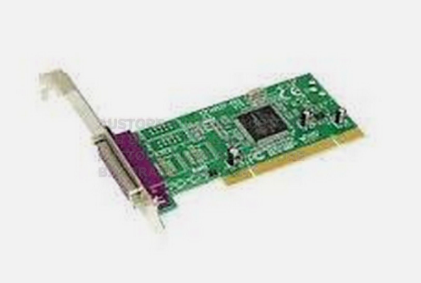

So first time LinuxCNC user and First time Linux uses full stop, Got most of my machine together and have decided to give LinuxCNC a go. have got a newish HP elite desk with an I5-7500, and picked up a PCI parport card (Picture attached) as it has the Oxford conductor chip I've seen listed as a working Parport card.

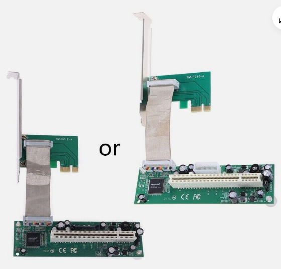

Only problem is my pc motherboard only has PCIe so I want to know before I waste $40 if anyone has used a PCIe to PCI adapter (like pictured or otherwise) and if they worked. or even if any of the Geniuses here think it will or wont work based on previous experience.

There is no way of knowing without actually trying it, some will work, some will not.
Example, out of several PCI graphic cards only one worked through such an adapter.
Pretty sure someone here or on youtube has a Mesa 5i25 connected to a PCI-E slot with such an adapter working.
Can you find a NetMOS or MosChip parallel to PCI-E adapter? Usually those work, had over 15 of PCI ones and all are still in use, but never had a PCI-E one.
At 40$, i would spring for 2 of different PCI-E ones and might end up with 3 non usable ones, but that is me.
Just in case you get the adapter, see if you can set the PCI-E to GEN1, raises the chances of working a bit.

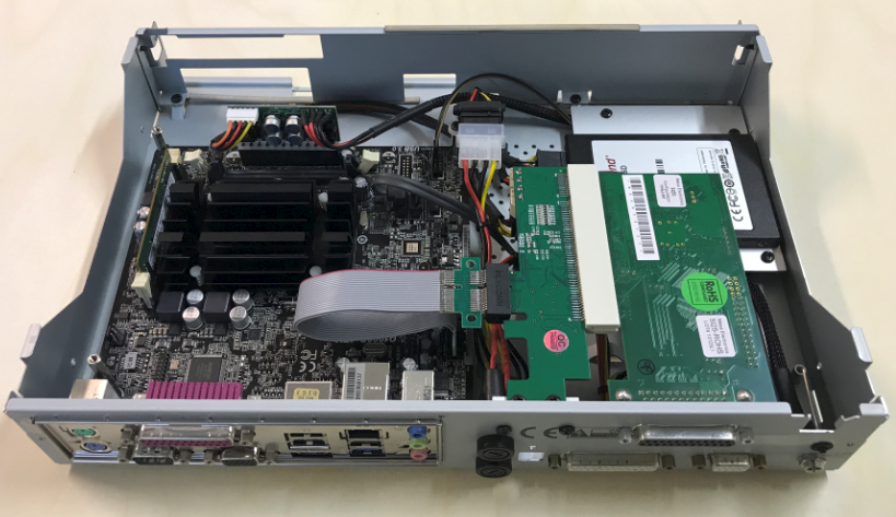

Here is one with both, PCIe to PCI adapter and mesa 5i25. And a PCIe riser cable.
The adapter looks like this: www.amazon.com/StarTech-com-PCI-Express-...d/dp/B0024CV3SA?th=1 I don't remember the exact model and shop but the price was like $10, cheap anyway about 2 years ago. Tested with a PCI parallel port card and it worked too.
The pc in the image is an Asrock J1900B-ITX but I have changed it later to a WADE-8012, so both are quite old. Reason for this setup is that I wanted to use the 5i25 (+7i76) when the old pc died...
