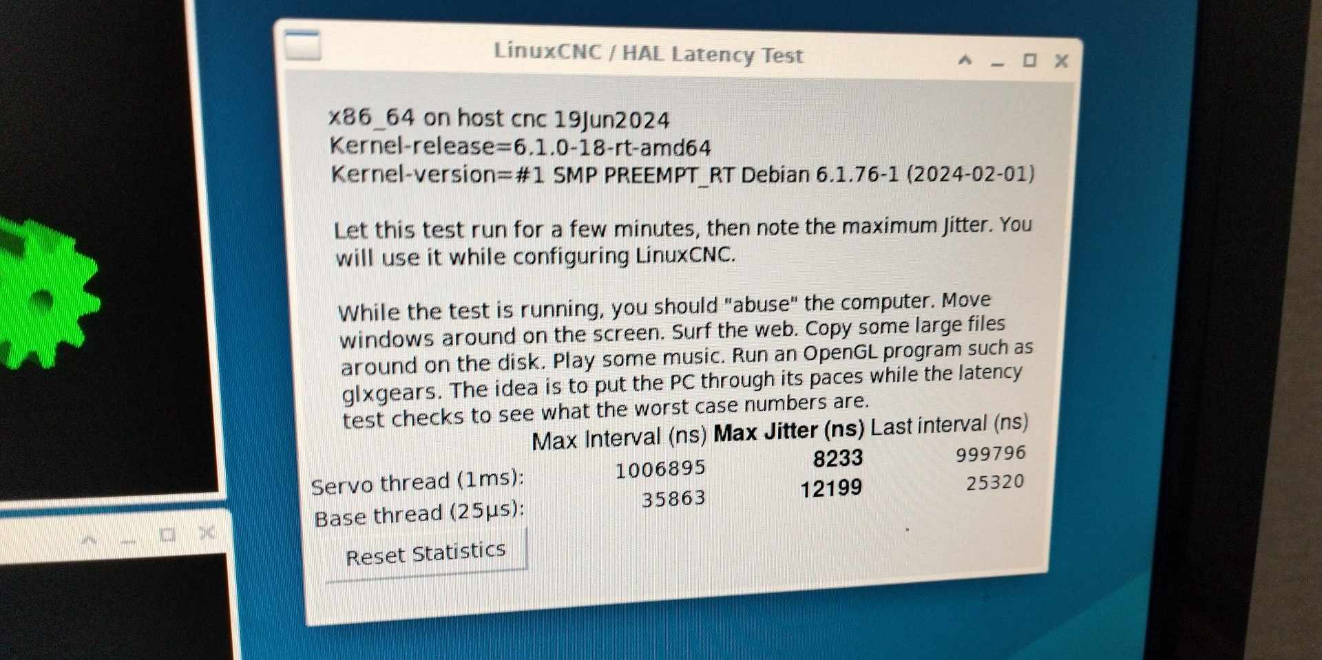

That's the kernel that a standard install already has.
To be honest I'd re enable multi core, and test with that. Leave Hyperthreading disabled.
If the results aren't that great you can add isolcpus=2,3 (assuming 4 core)
isolcpus=1 (assuming dual core)
This link explains the editing kernel command line with grub

Replied by ThyerHazard on topic PCIE to PCI Adapters
Cheers I'll give it a go, (Its a first gen I5 so dual core)
Multicore on with ISOLCPU=1 did the trick I think we are all sweet now.
Base thread max jitter with 5 GLXgears was 7300 when I opened a youtube video and let it play for a bit it only got up to 12200
I think.... I HOPE that is good enough for my little milling machine. Thanks again for all your help guys
