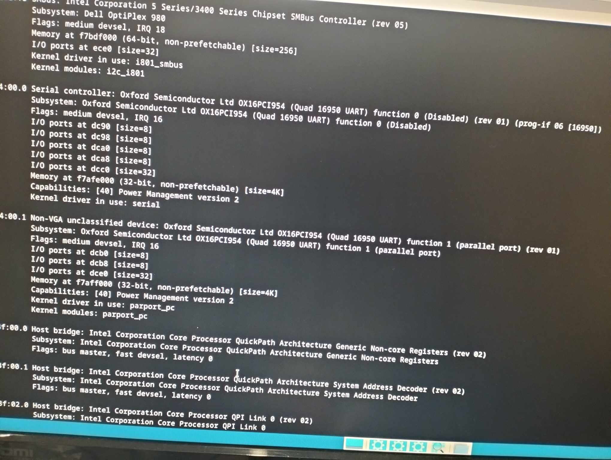

I suggest checking lspci now for the oxford card, does it show same or different ports than with the adapter ?
Also parport driver messages (same port or different) ?
Just to be sure what the card tells...

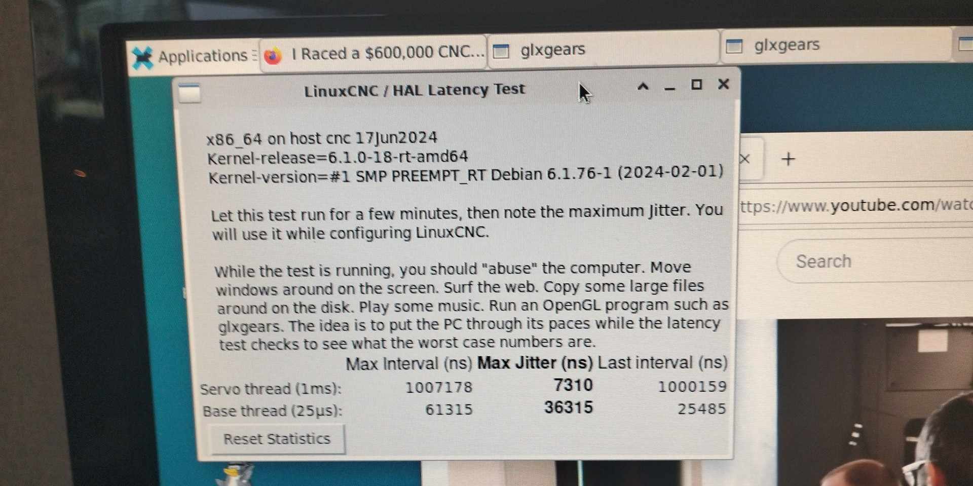

Replied by ississ on topic PCIE to PCI Adapters
With parallel control you are interested more on the base thread jitter which is ~37000. Set up step timings based on that, not 8000.Thanks for the reply ISS,

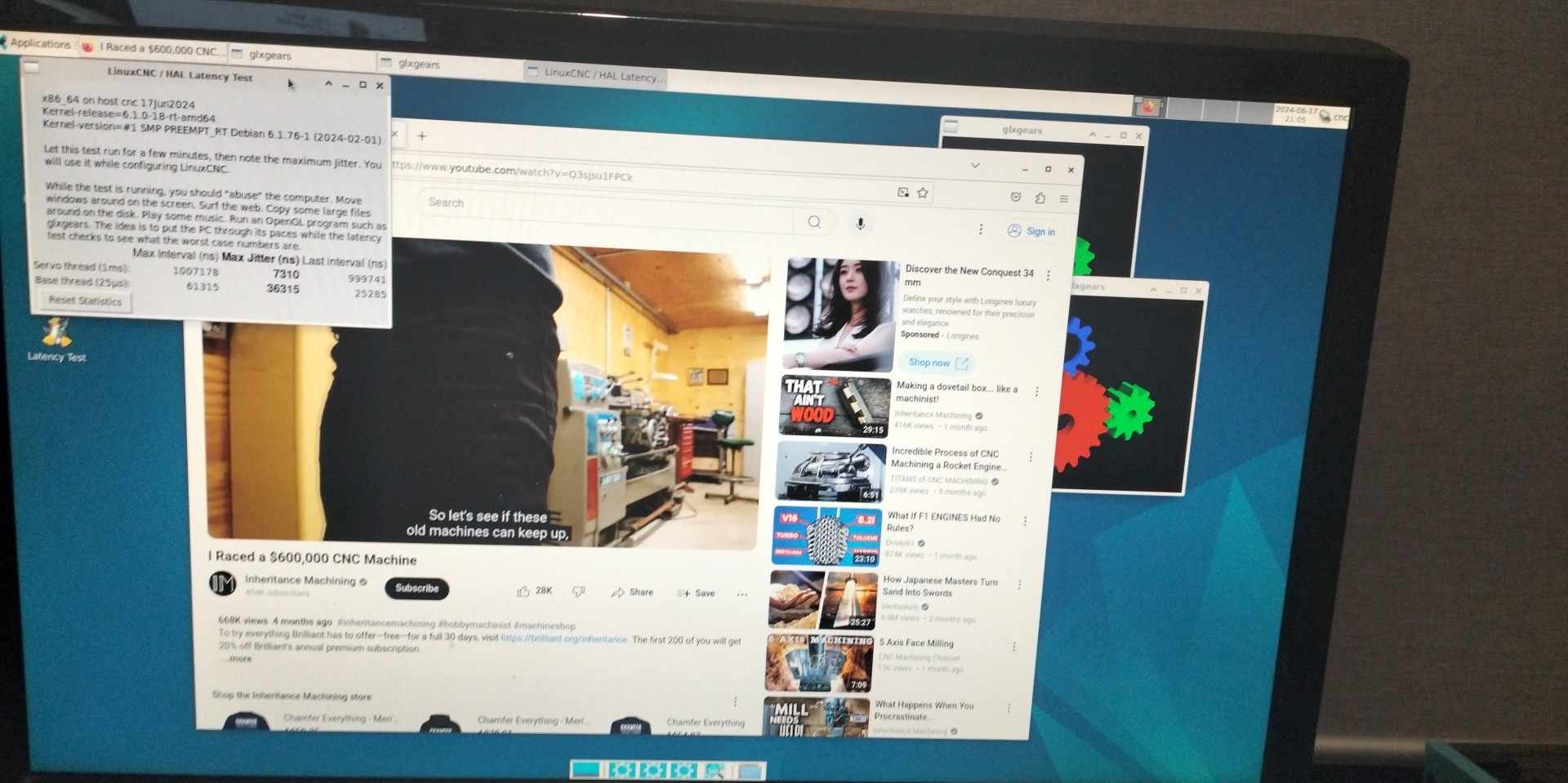

awww spewing
I was stoked for a minute thought I had really good jitter.... oh well guess I'll keep trying things to get it lower.
including a photo of lspci -V Its changed

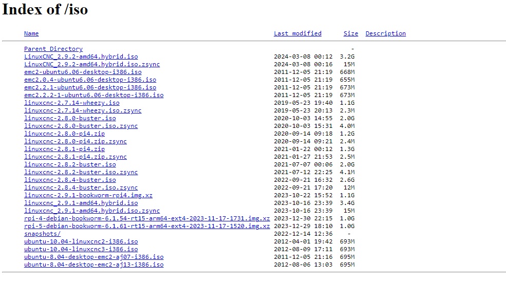

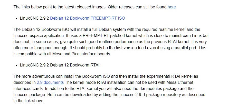

Forgive my silly questions, I downloaded
(LinuxCNC 2.9.2 Debian 12 Bookworm PREEMPT-RT ISO )
and when I look at the one below it marked RTAI
(LinuxCNC 2.9.2 Debian 12 Bookworm RTAI)
There is no hyperlink to download it like there is with the PReempt one am I missing something? I have a list of the older builds is it one of those? sorry again for the dumb questions just super new and don't want to mess it up. Also when I'm actually in the bios selecting the OS to install am I clicking the one marked (live) or just the regular install, On the current set up I just ran the regular install because I assumed the LIVE would just be running the OS of the USB drive for testing?
Thanks again, included photos of the pages I'm looking at.
The more adventurous can install the Bookworm ISO and then install the experimental RTAI kernel as described in 2.9 documents The kernel-mode RTAI installation can not be used with Mesa Ethernet-interfaced cards. In addition to the RTAI kernel you will also need the rtai-modules package and the linuxcnc package. Both can be downloaded by adding the linuxcnc 2.9-rt package repository as described in the link above.
Here's the link
linuxcnc.org/docs/stable/html/getting-st...nate_install_methods
Here's the link
